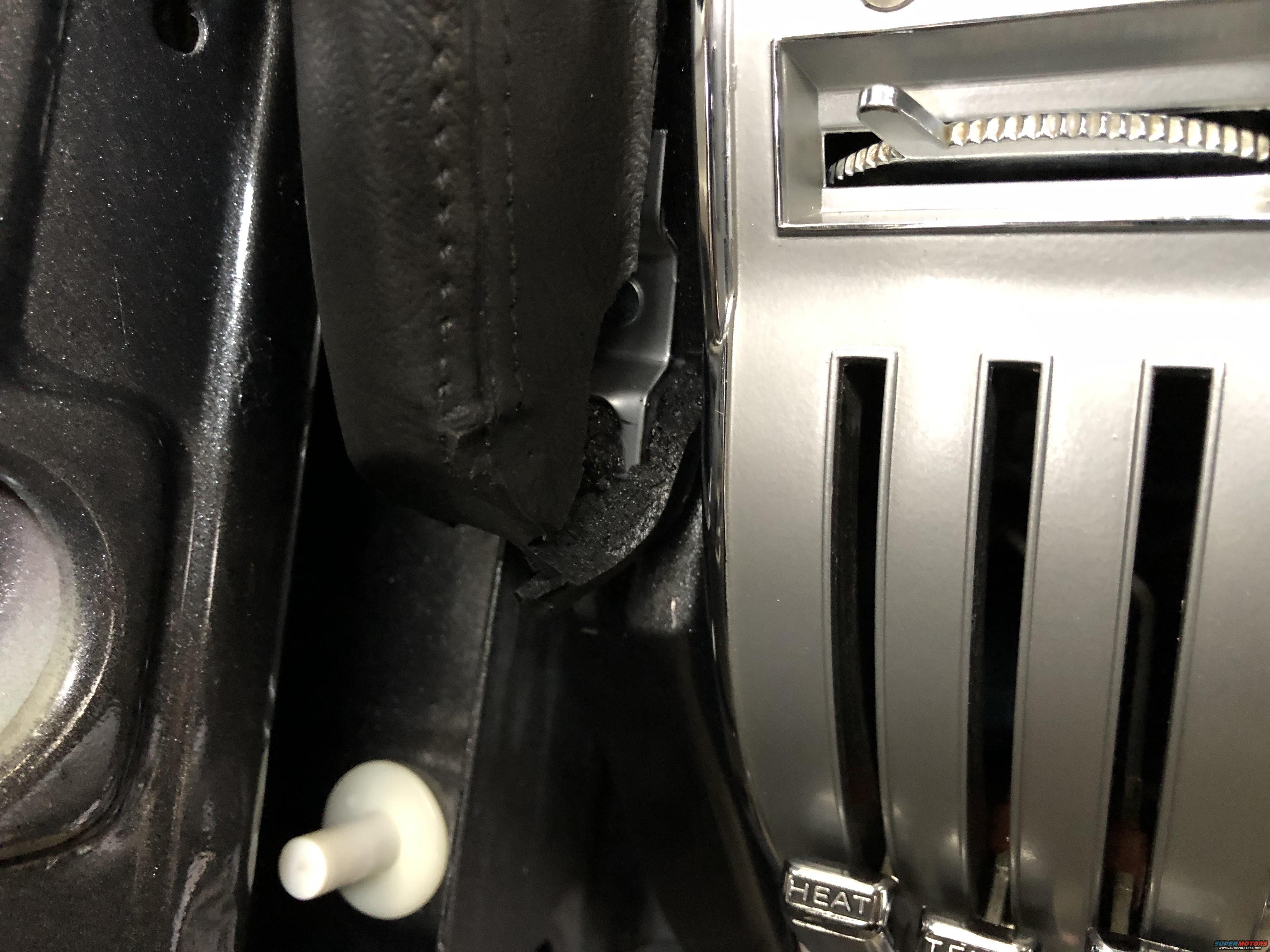

We will have summer here soon enough so Ill see how the heat affects the dash, maybe it will settle a bit. however its really not too bad unless you know its supposed to be flat then it bugs ya.

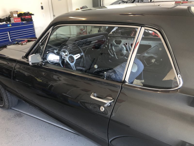

So door glass…that was fun :wtf:
I had to swap the top stainless trim from another window since mine was pretty scratched up along with being loose and falling off. That was was easier then expected surprisingly. What was more fun is finding all the hardware, stops and slides that go with the glass and how it all went together, remember I did not take this car apart so its been a challenge at times to make sure its going together correctly. I found my passenger side glass to be scratched pretty good so I will need to try and find a good used one. I really dont want to have to take it out later if I dont have too.
I still have some adjusting to do I think. Its harder to roll up then I think it should be, also with the door closed I cant get it all the way up so its probably leaning in at the top a bit too much. Hard to tell if its simply because all the rubber is new or its out of adjustment or both! I got sick of adjusting and readjusting so left it as is for now.

I feel your pain on the windows, that whole setup is ridiculous. Hard to get everything 100% right. I cleaned and greased the crap out of my tracks, installed new regulators and rollers here and there, spent a lot of time adjusting, and they are still kinda difficult to roll up, and don’t seem to want to go completely to the top (relating to the vent window frames). Pain in the butt.
Same here. That last bit at the top is is the worst. mines worse with the door closed. I am hoping with everything together it will open up the rubber a bit to fit itself, maybe not. Maybe Im asking too much from a manual crank 50yr old setup! :confused: Everything was cleaned as good as new, lubed and regulator is a NOS even. Ya move one adjustment and mess up another. so yeah I considered them being installed as a win for now! :wall: The fight will continue another day!

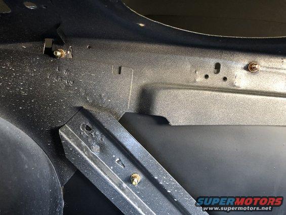

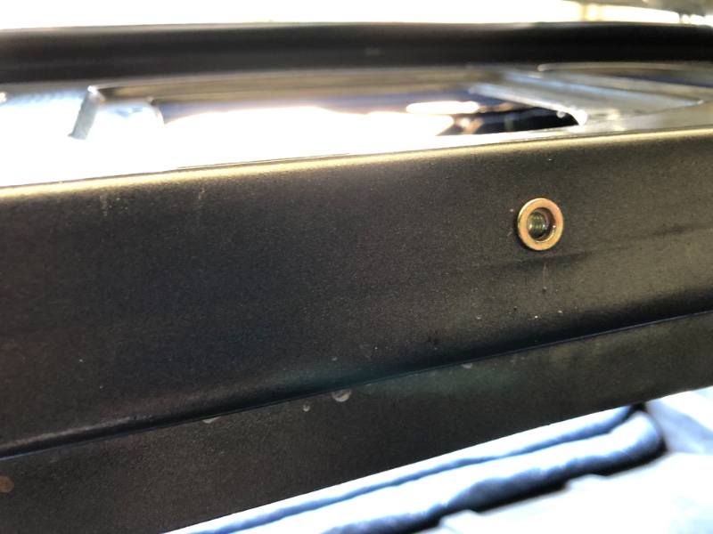

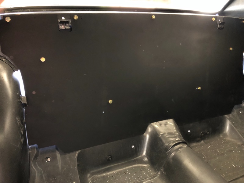

Not much progress lately but I did get the rear panel behind the seat installed. I used nut zerts instead of tec screws or rivets for easy removal. Still need to do something with the bottom section to prevent it from rattling then I can cover it with sound deadener
I was worried about the rear of the car being too high for a while but with everything disassembled it was hard to tell how it would sit once parts go back on. Still have the interior to install but do not think that will settle much. The front coils are 1” lower and the rear packs are 4.5leaf packs courtesy of the previous owner. The front height I’m good with, the rear I’ll probably need to lower to match but really need to get wheels and tires on it first.
