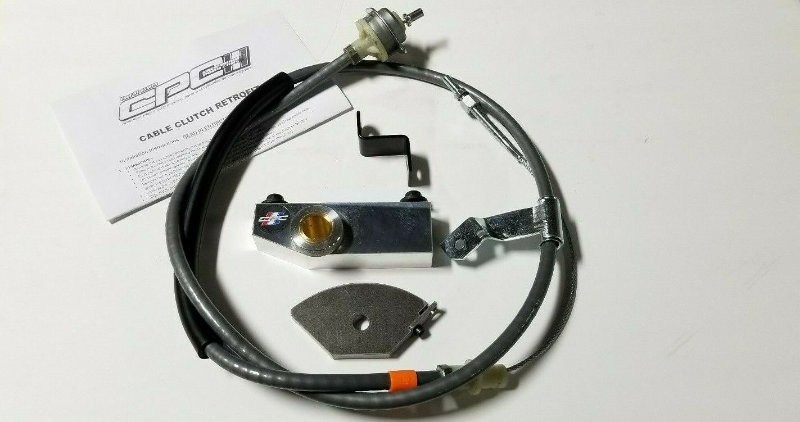

Hi, cause I will use the fox body T5 and bellhousing I opted into cable clutch and anyway 9 inch booster is to big to use z-bar linkage and rods.
