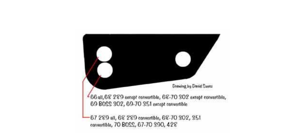

The convertible mounts for your Cougar were also used in Mustang convertible, as well as in the 1966 and 67 Mustang and Cougar hard tops. You can get 68/69/70 hard top frame mounts (frame saddle) and use 68 up motor mounts. Why Ford did this is anybody’s guess.

According to Ford, the motor mount angle change was made to eliminate a vibration found in convertibles.
The last Ford part number available was D0ZZ-6038-B. It was a replacement part used on the 1970 convertibles.

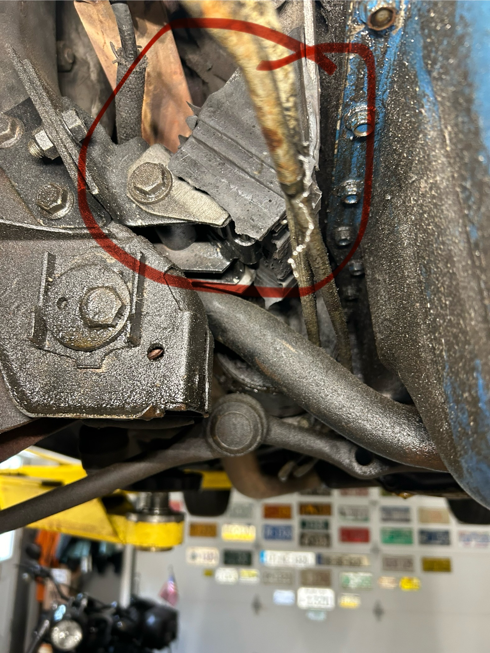

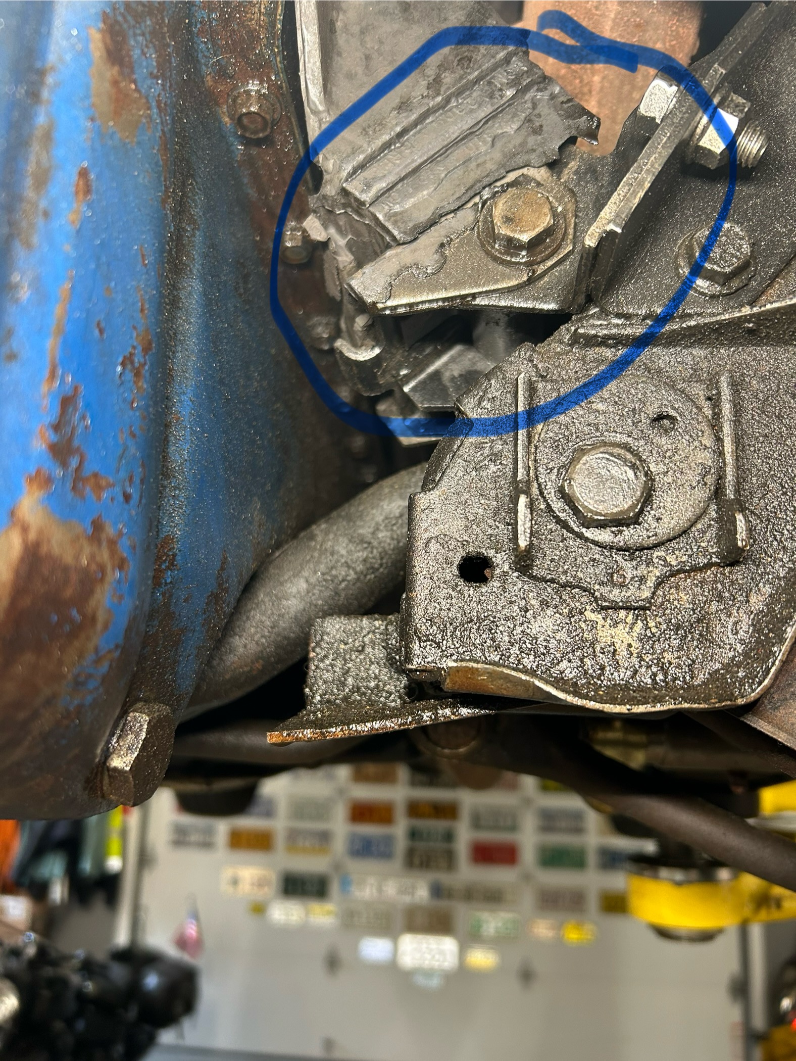

These are my USA made anchor motor mounts after 1200 miles. There was no adhesion (however they do it) on the base rubber to the metal, just around the edges.
