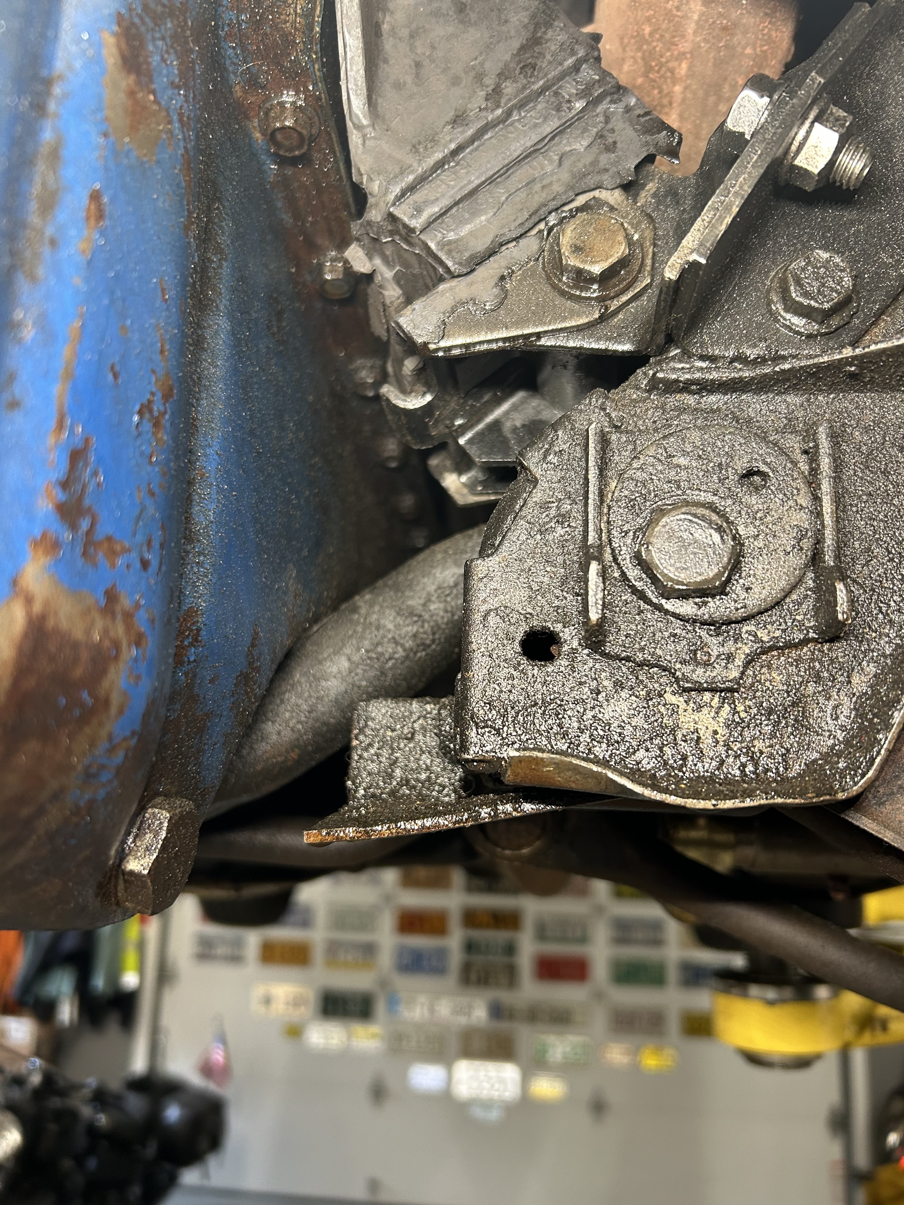

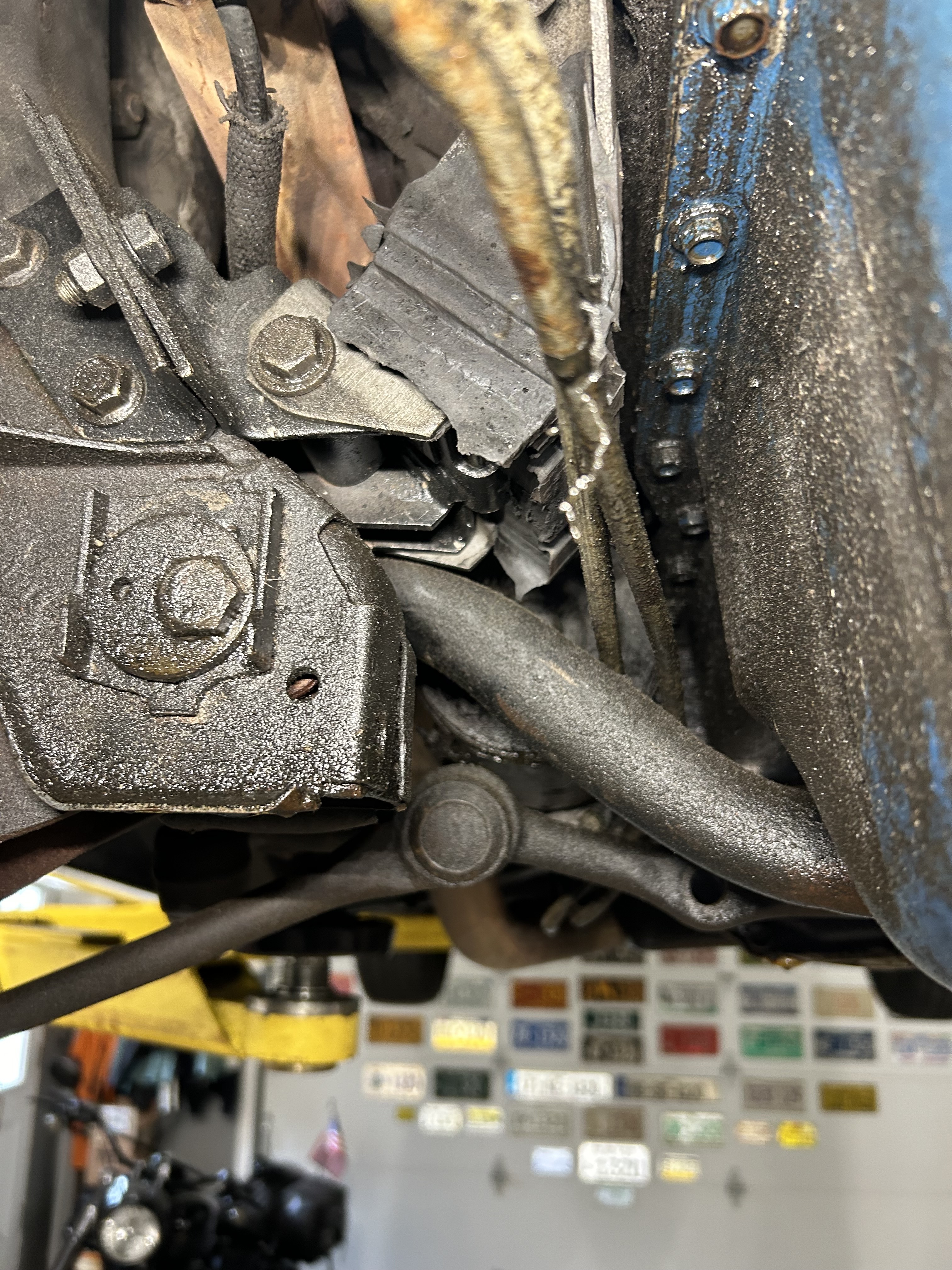

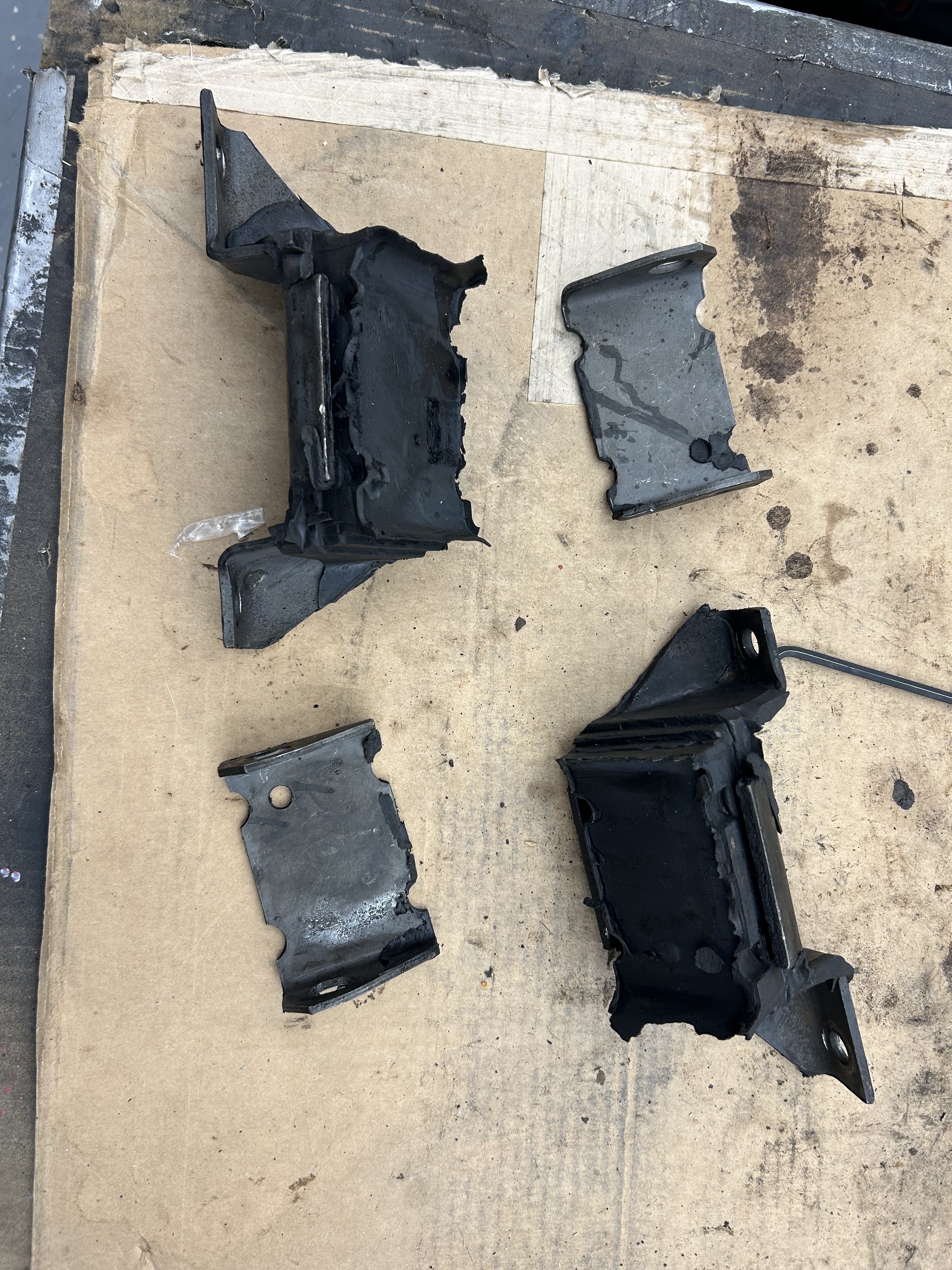

I got the right engine stands from WCCC and installed the Anchor motor mounts last fall. They are both toast.
Defective? Bad install? It’s not like I do brake stands…ever.
I’m going to say you got bad mounts.
