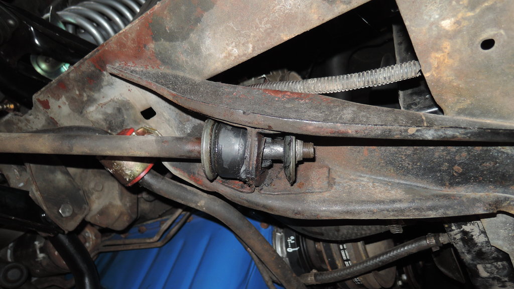

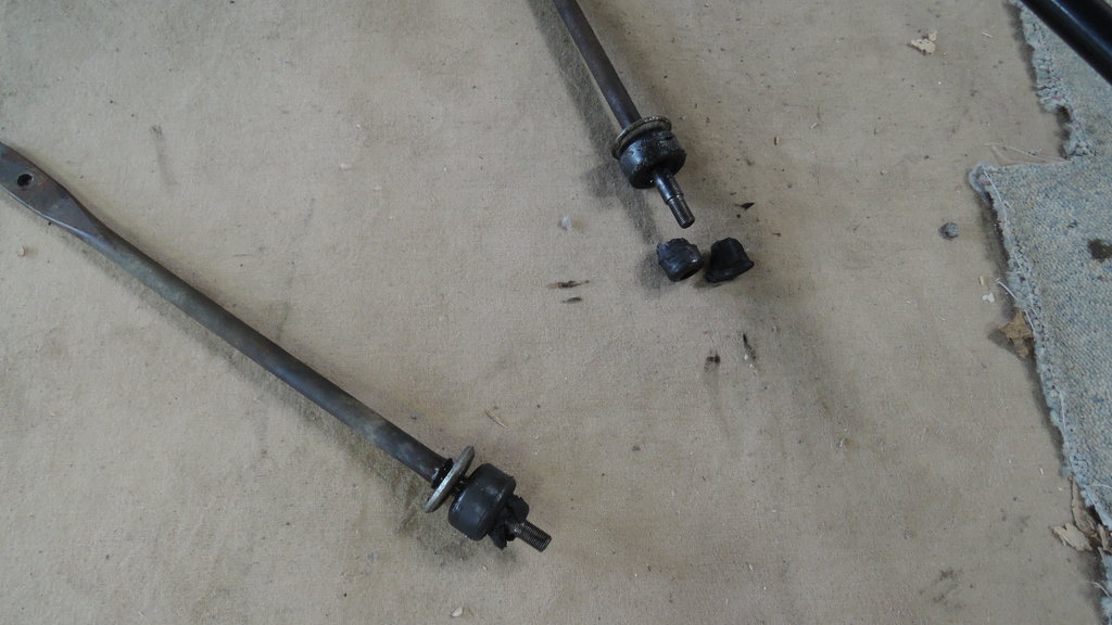

my friend mounted on his 1965 mustang new bushings from moog. 1k miles later this happened; All parts were broken :wall:
and when i saw this vid, i ordered for my cougar hotchkis struts. I know it’s not concours correctly, not original and expensive but i prefer the security when i go fast.
Maybe it makes the difference if the complete suspension is firmer then stock!?
Those don’t look like Moog strut rods bushings, but they do call for a #K8122.I have never seen this one. The improved design has a steel center ring fitting in the hole of the housing & will not move around. Also the washer(s) is backwards. This is most likely the main reason for failure.
