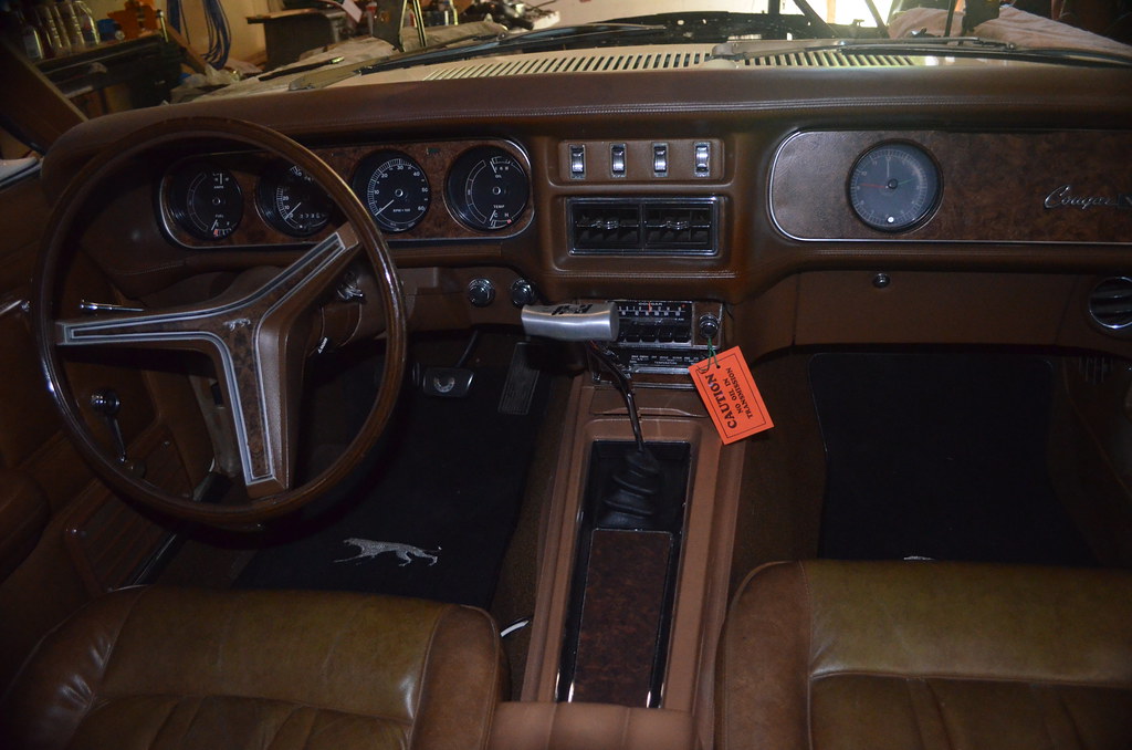

But a manual shiftier is just so much fun… Hiding under that stock looking Hurst shiftier is a 5 speed.

Come on man…with that beautiful interior why have you not changed out the clock lens? That glaucoma looking thing looks horrible in there!

Older picture. It has been changed as well as a couple other improvements like a tilt steering column and a shiftier arm that more matches the factory 4 speed one.
