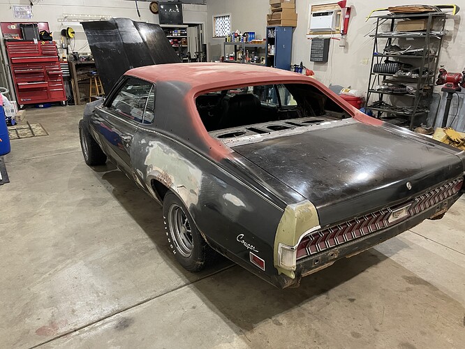

Well, off on an another project. I should have let this one fade away, but I just can’t…there aren’t enough cats left around. Think me a fool for saving this one…me too some days. My plan is to take this car on a full Route 66 cruise. Plan is a mild 351w, 5 speed manual. Will update the a/c to 134a with mostly stock components. Likely electric steering. And a color change. I’ll post as I tear into the build

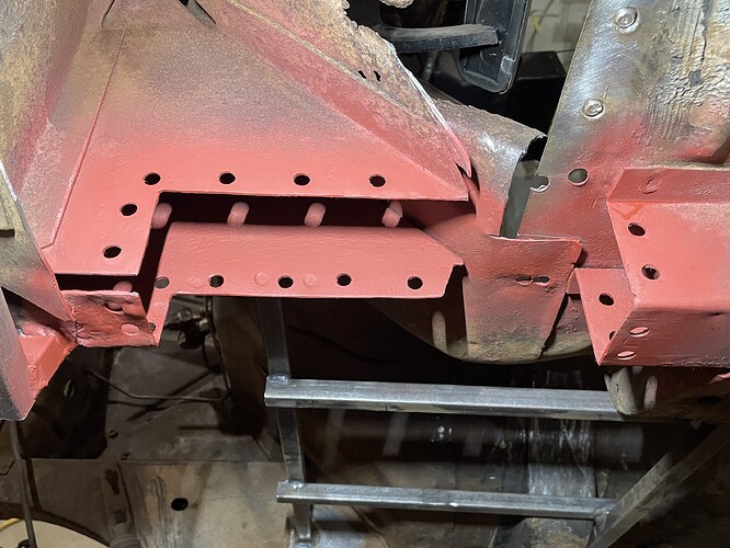

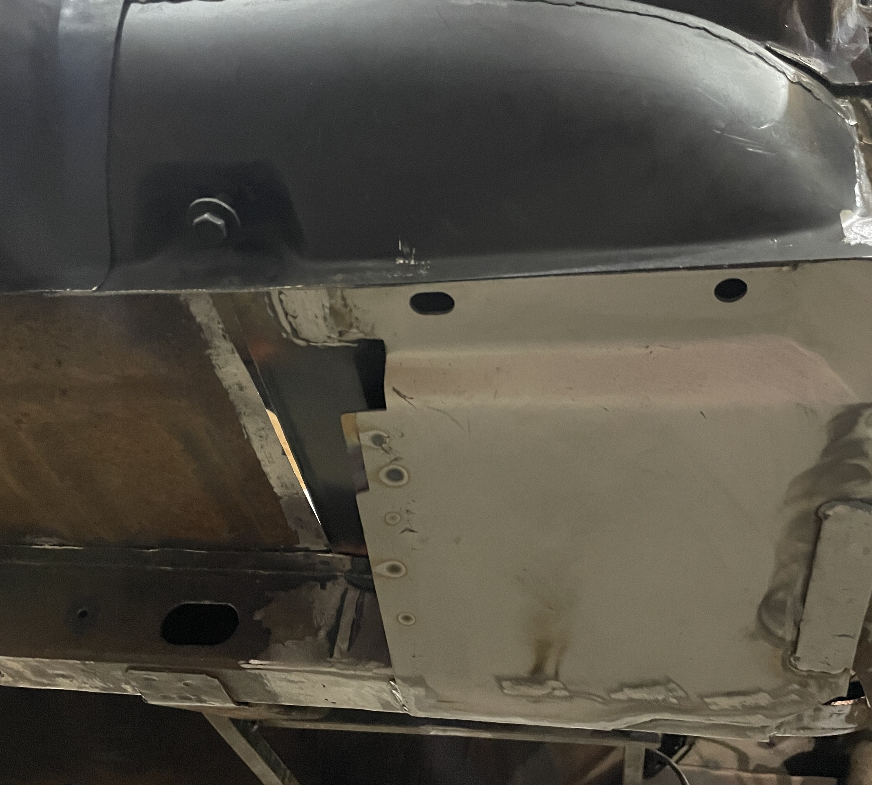

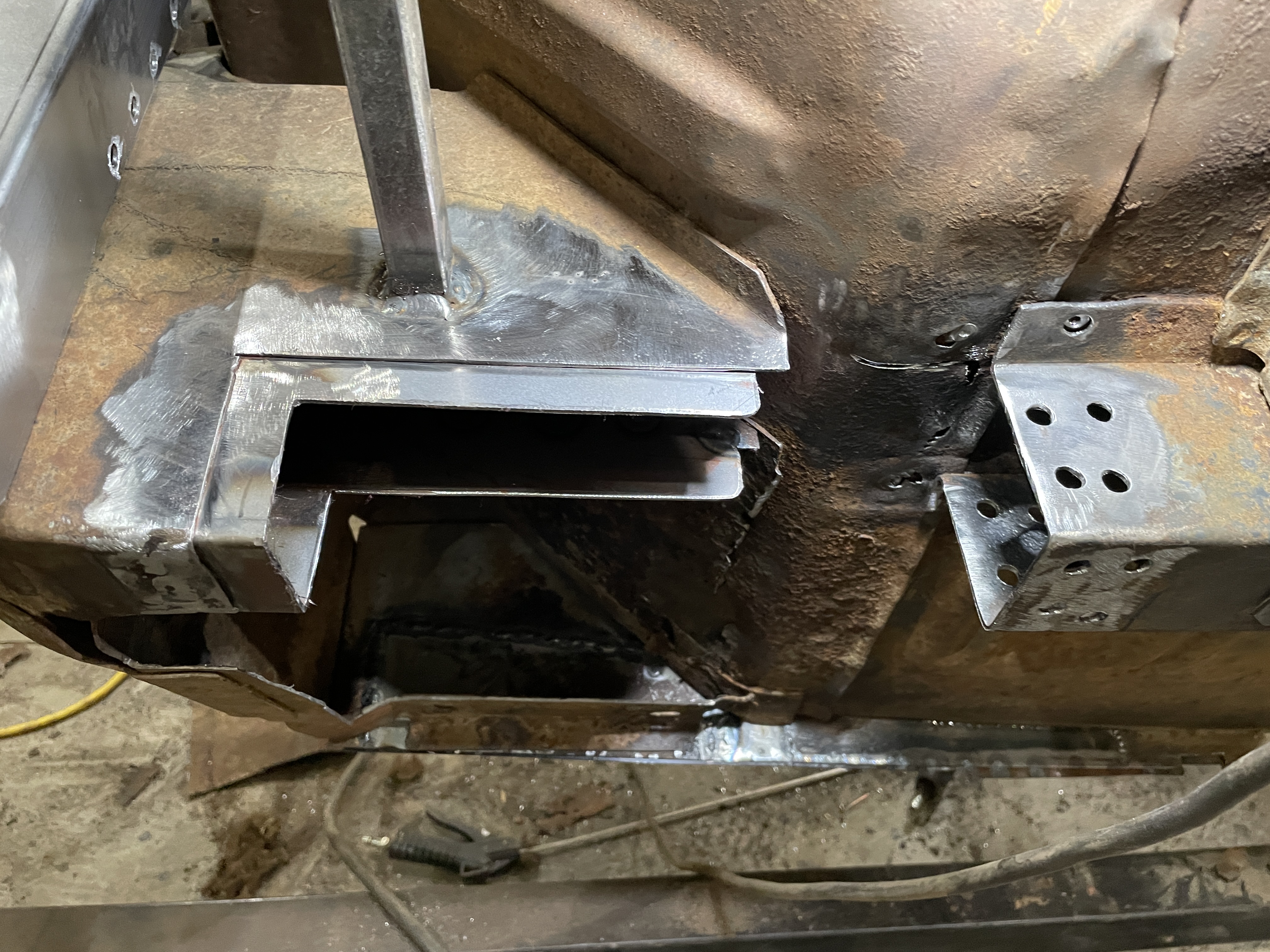

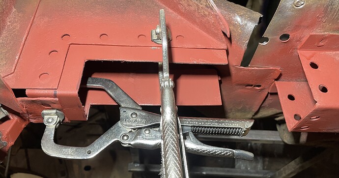

Rear frame rail section cut out and front of floor support cut out. Now to make backers for proper sectioning…leaving front half of torque box in for stability until rail and support welded back together.

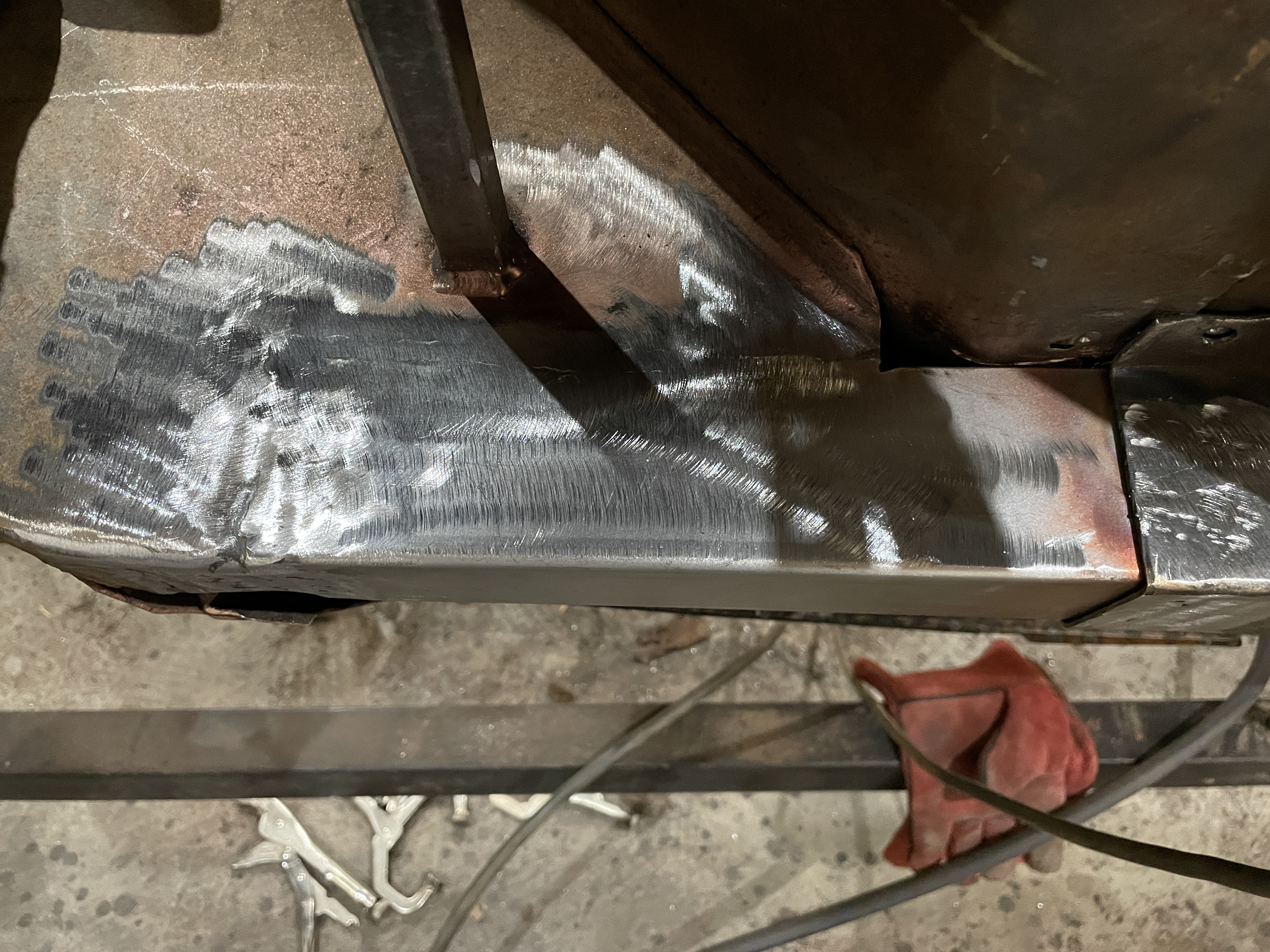

Long night of welding. Frame and floor support reconnected. Backer made, in place, and welded…

More progress this afternoon. Welds ground.

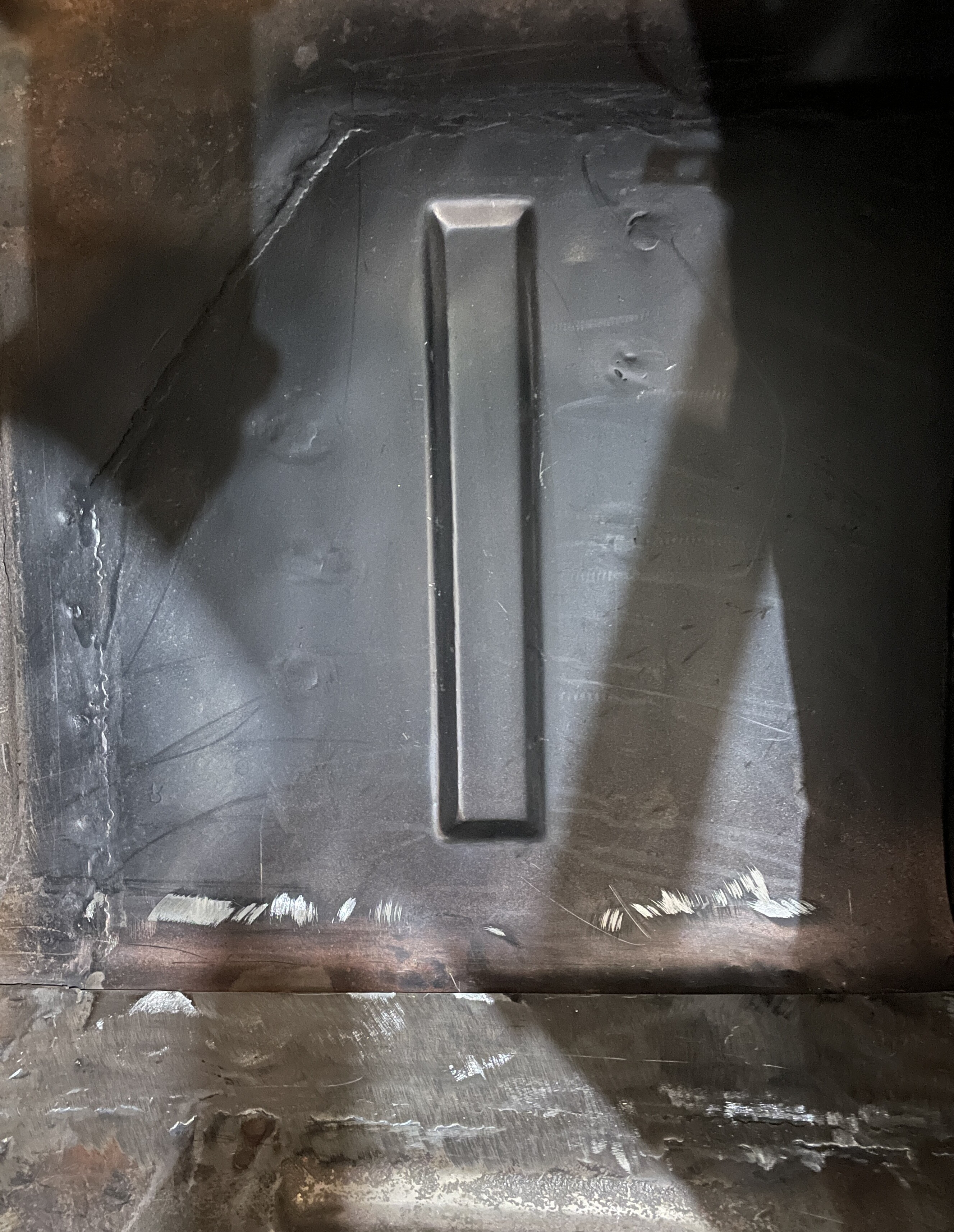

Floor support section prepped for welding.
Fully plug welded and ground. What’s left of the torque box comes out tomorrow

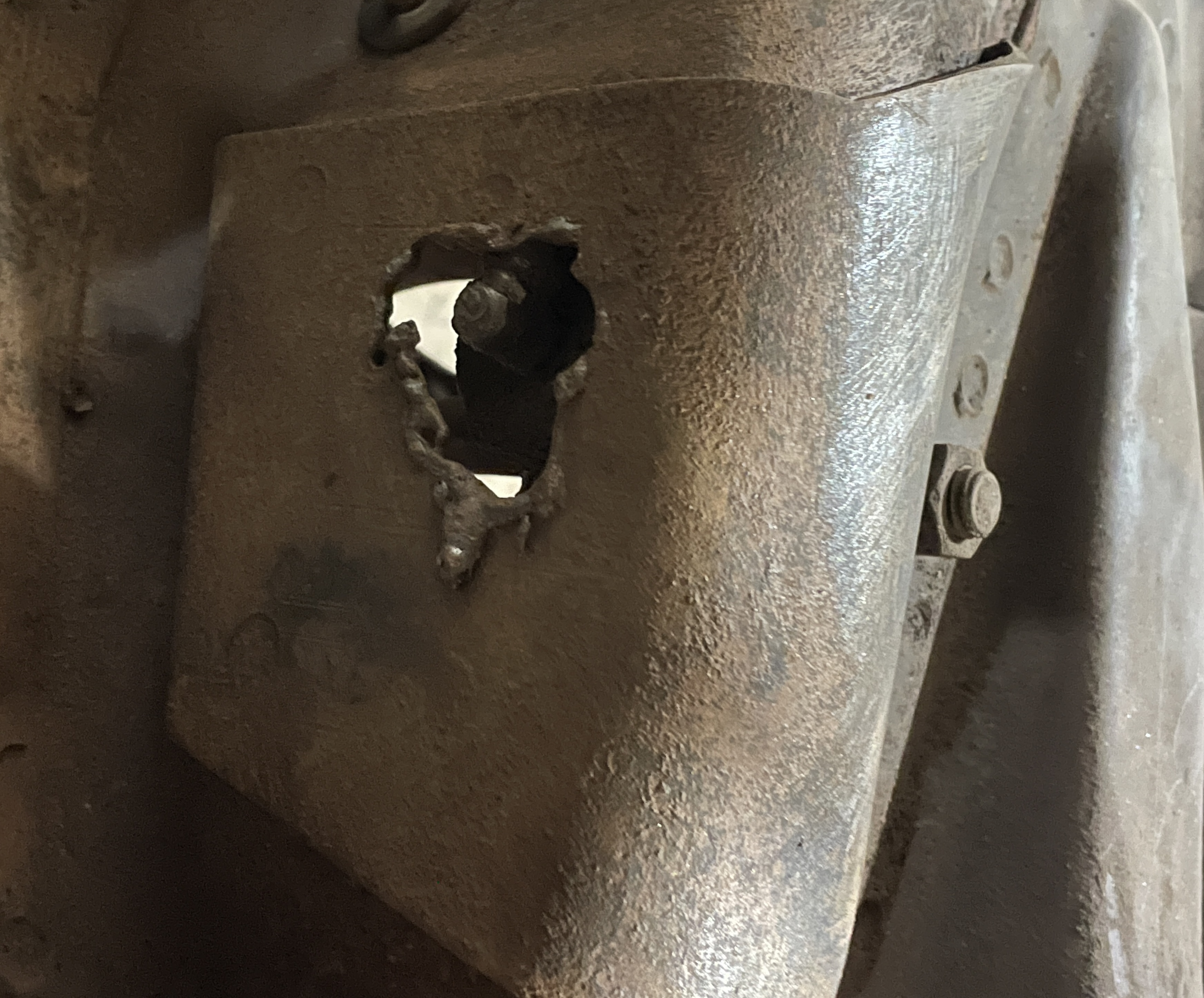

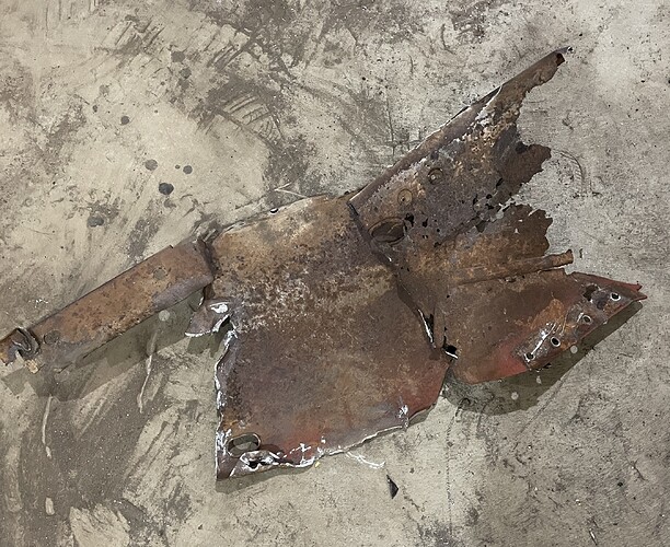

For being as rotted as it was, it fought hard to come out…

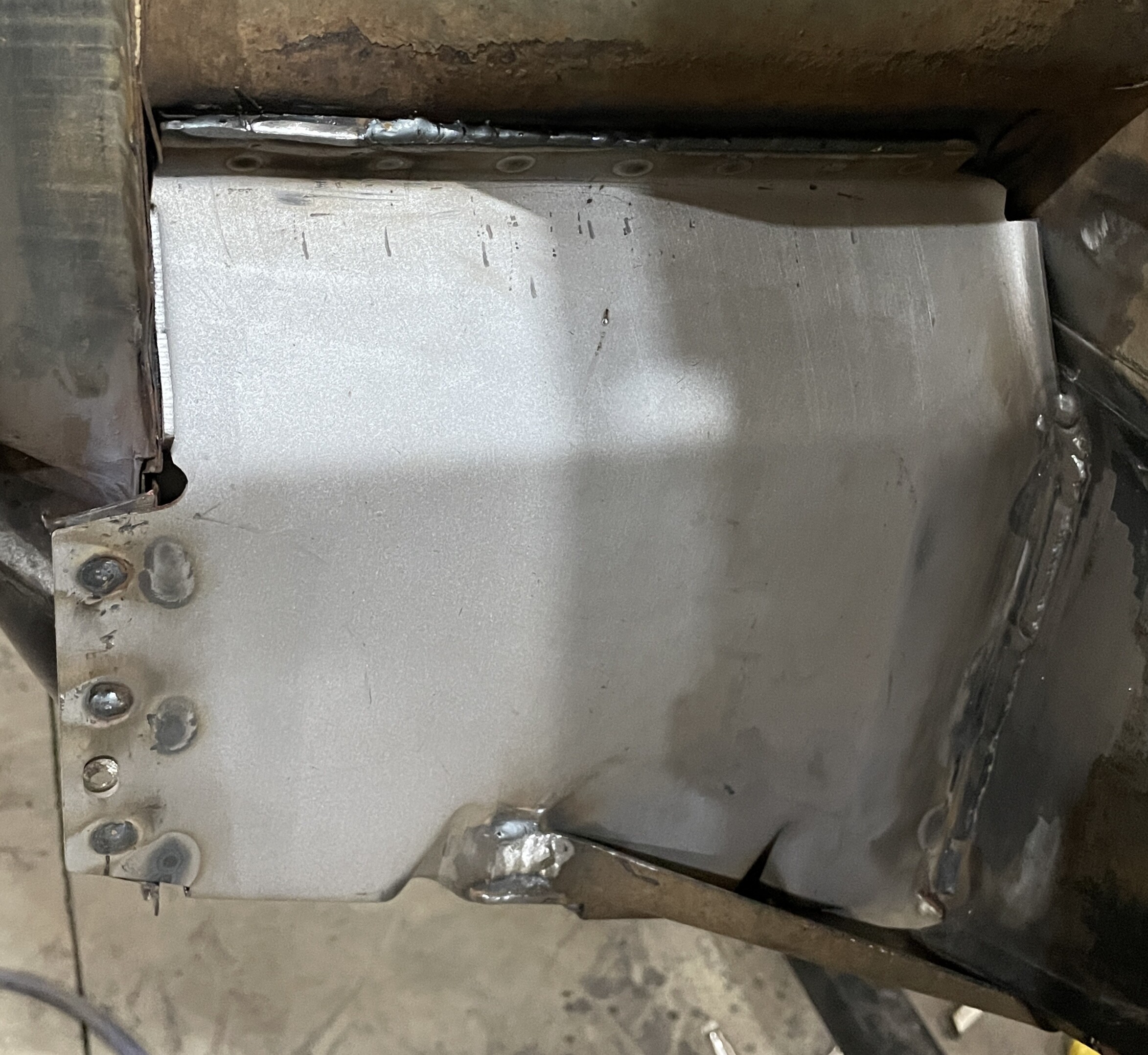

Torque box installed. My first one ever…

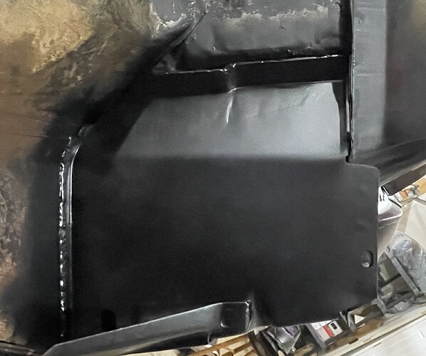

Right torque box done…floor pan patch to go

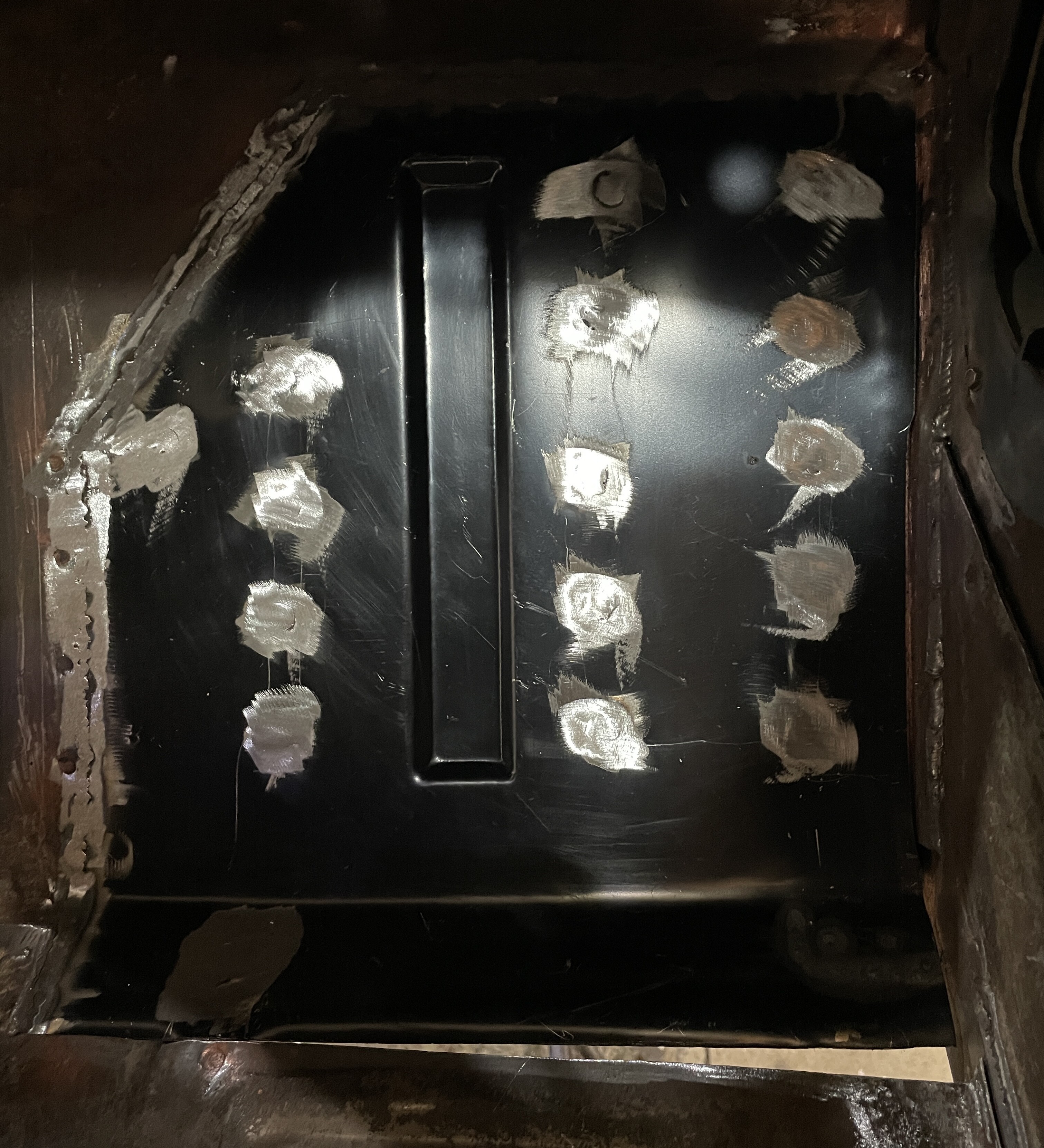

Floor patch done….why did anybody think this was a good idea?
