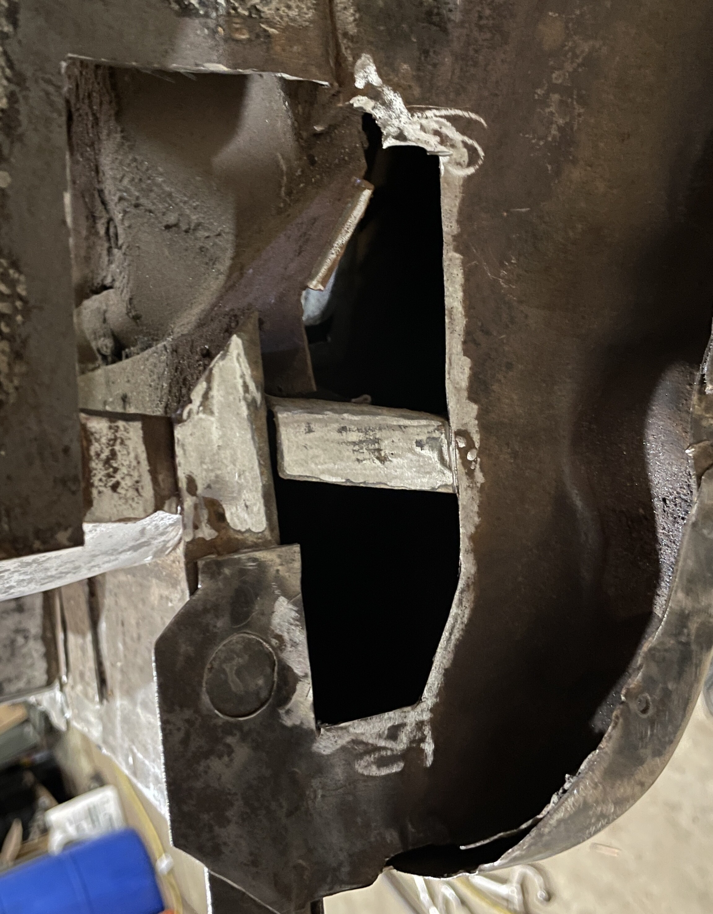

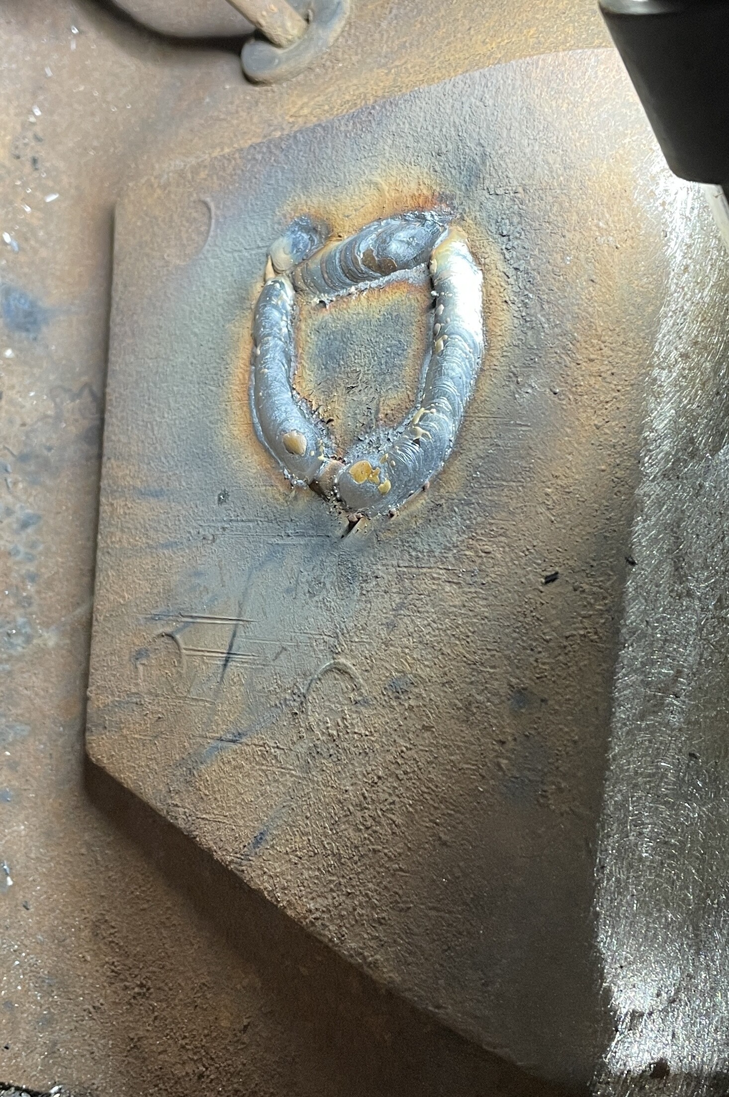

Cutting a hole to get to the control arm greese zerts. That is an extreamly nasty hole.
Precisely. The torched hole for greasing the upper control arm. What a hack job! Funny thin g is they only did the rear and didn’t cut the fronts. Completely illogical
Does seem a bit extreme but that squeak can drive a guy to madness. :woozy_face:

I’ll be using aftermarket tubular that have no need for grease zerks…but yes I’ve installed several sets of these, my first set in the 80’s
Doh - wish I had known they existed in the 80’s! I was a hole driller too back in those days.
Better to be a hole driller than wielding a torch

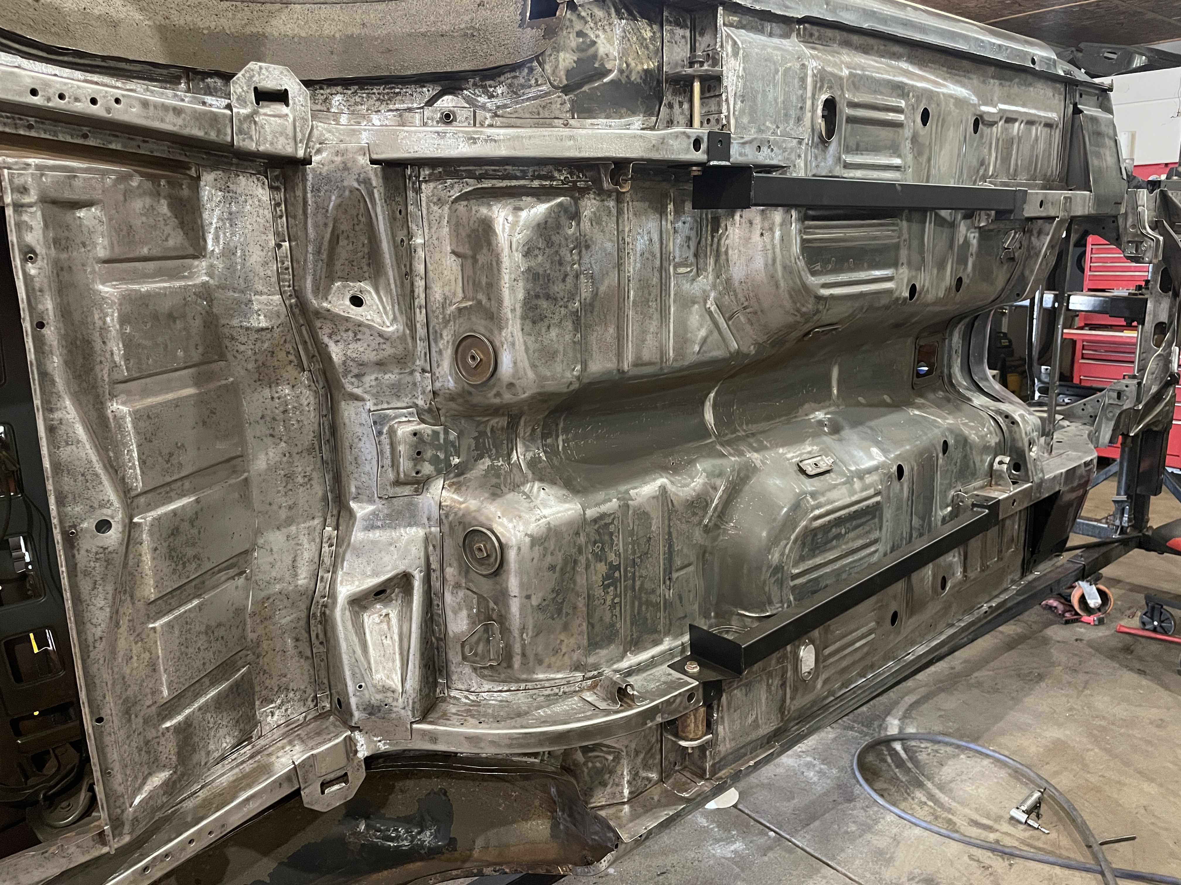

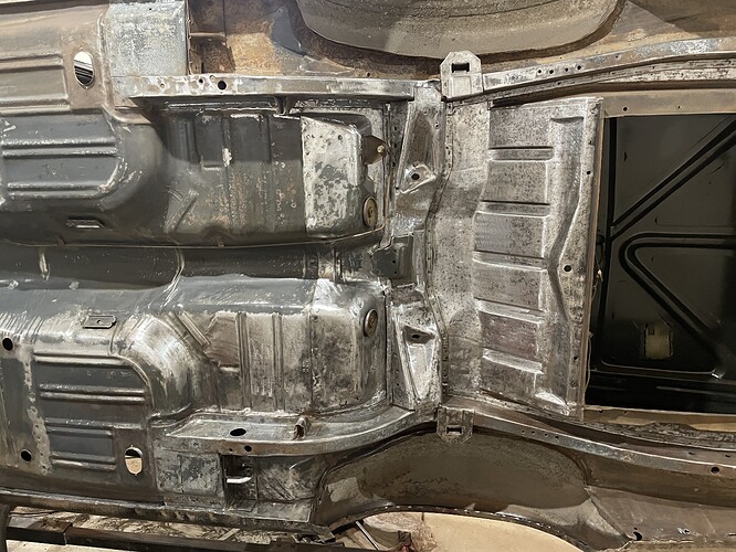

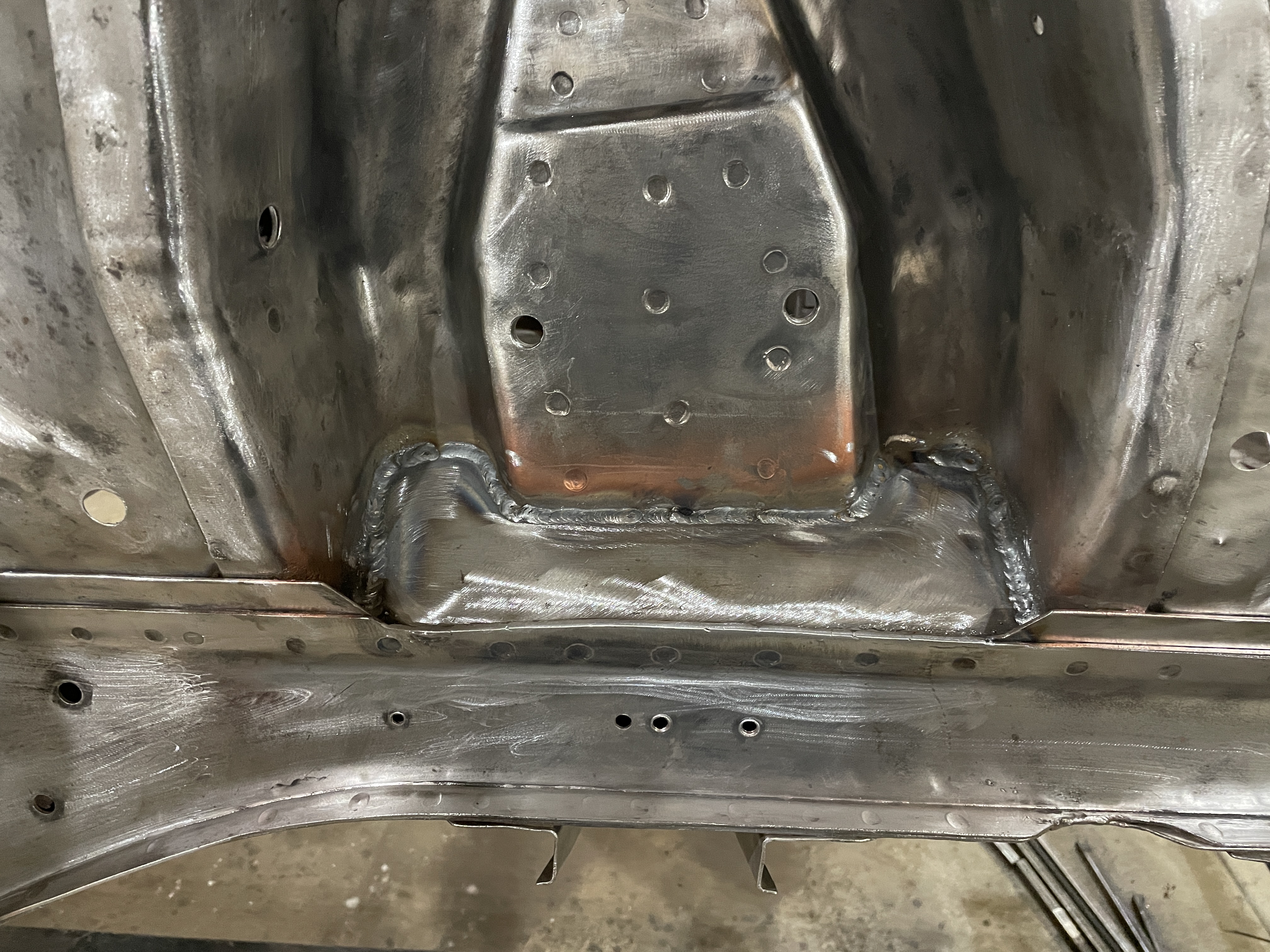

Well this is quite the process….wire wheeling because I don’t want sand blasting mess and can’t because it’s cold outside
Few more repairs. Lots more wire wheeling

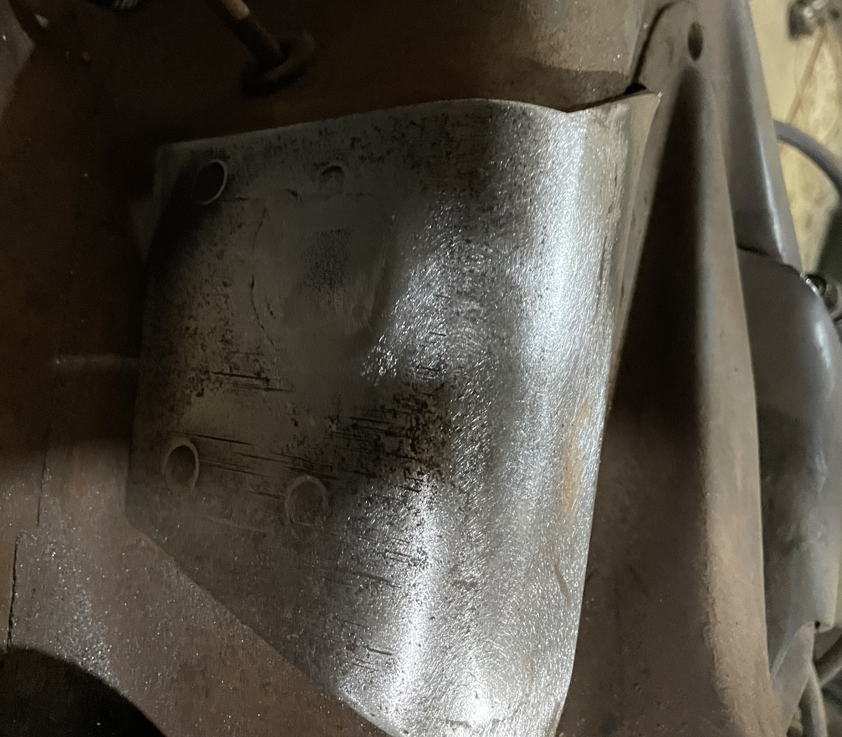

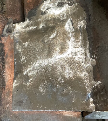

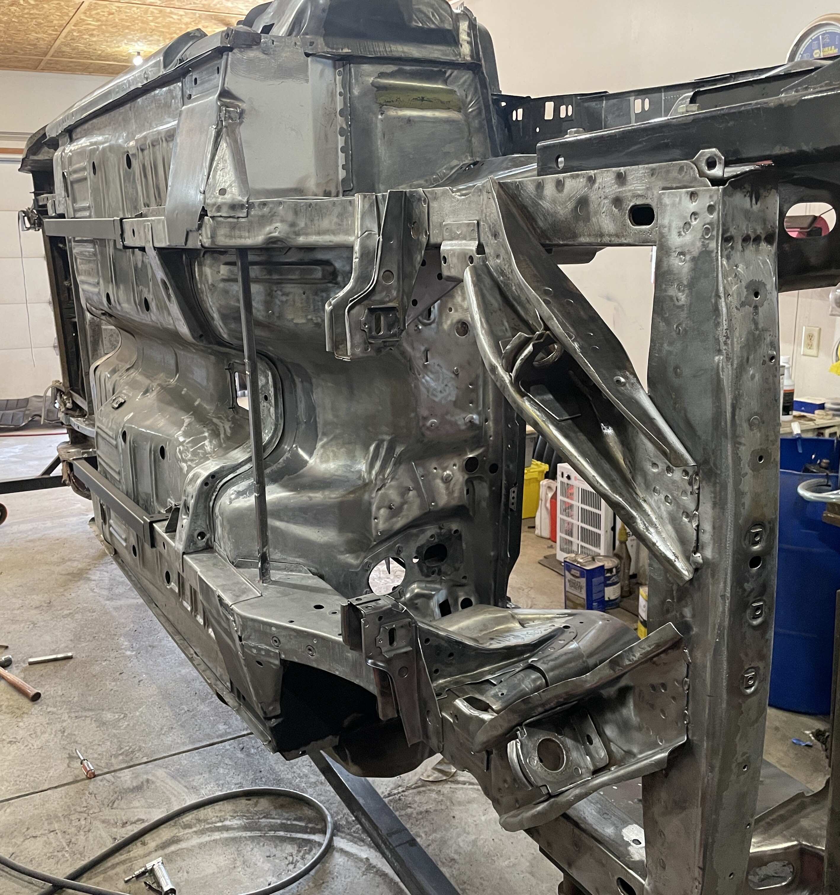

Little more progress. Shock tower reinforcements

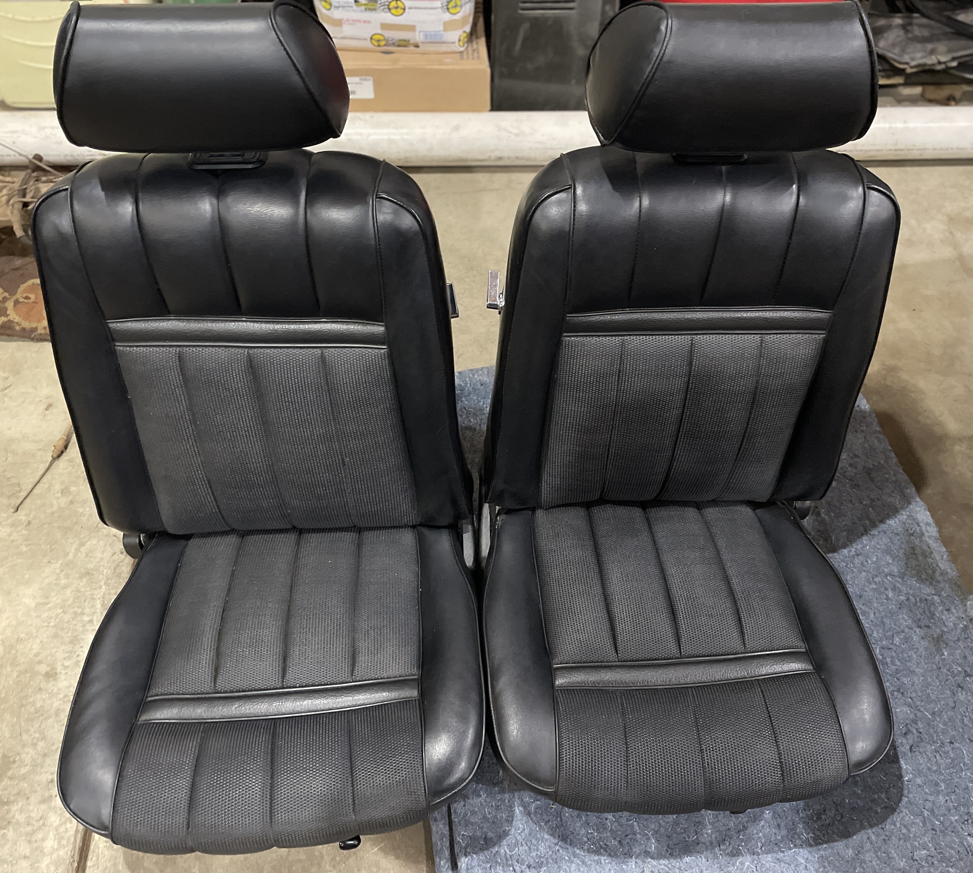

Part of the amazing 69 xr-7 comfortweave interior I harvested from a donor.

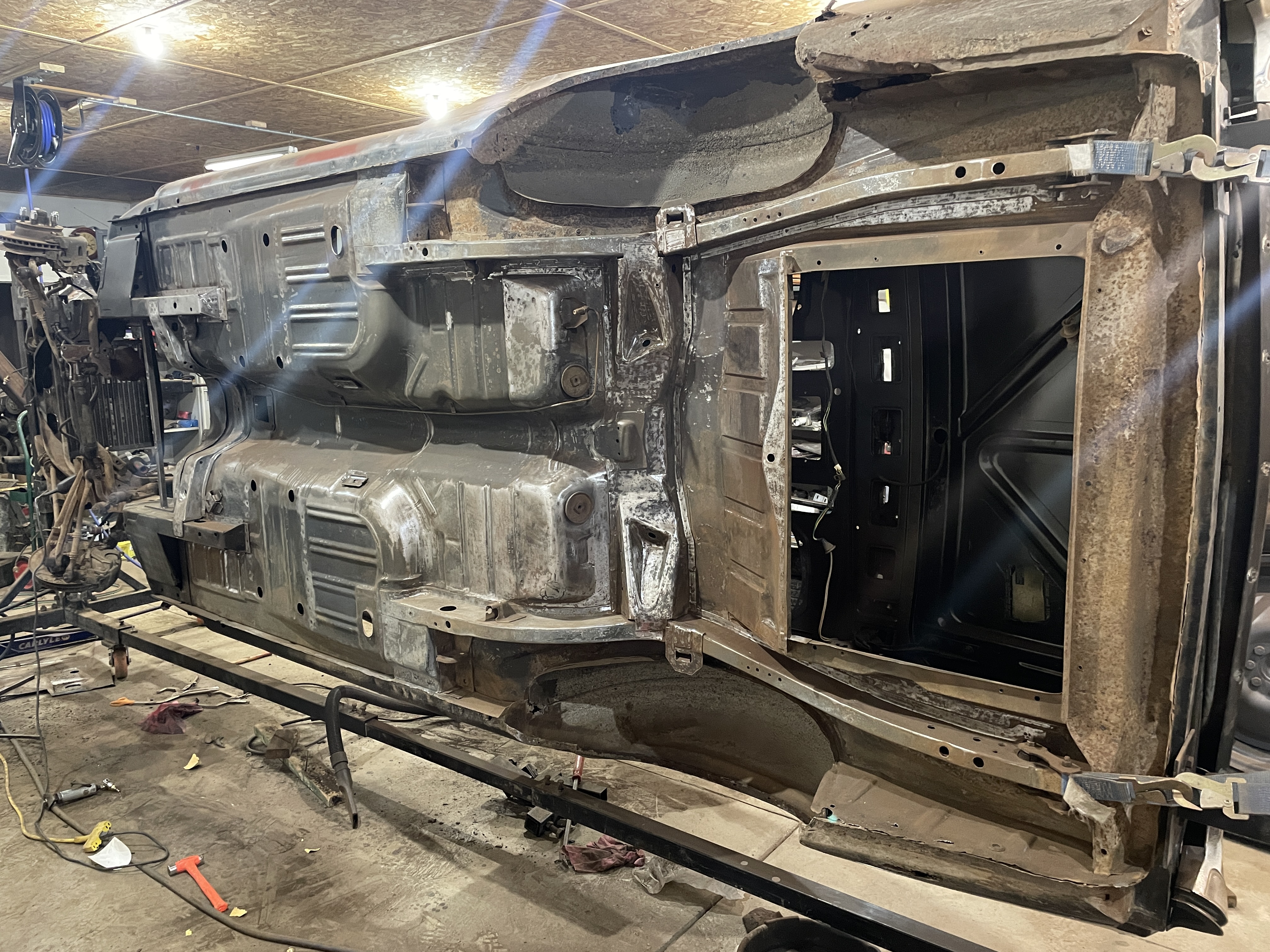

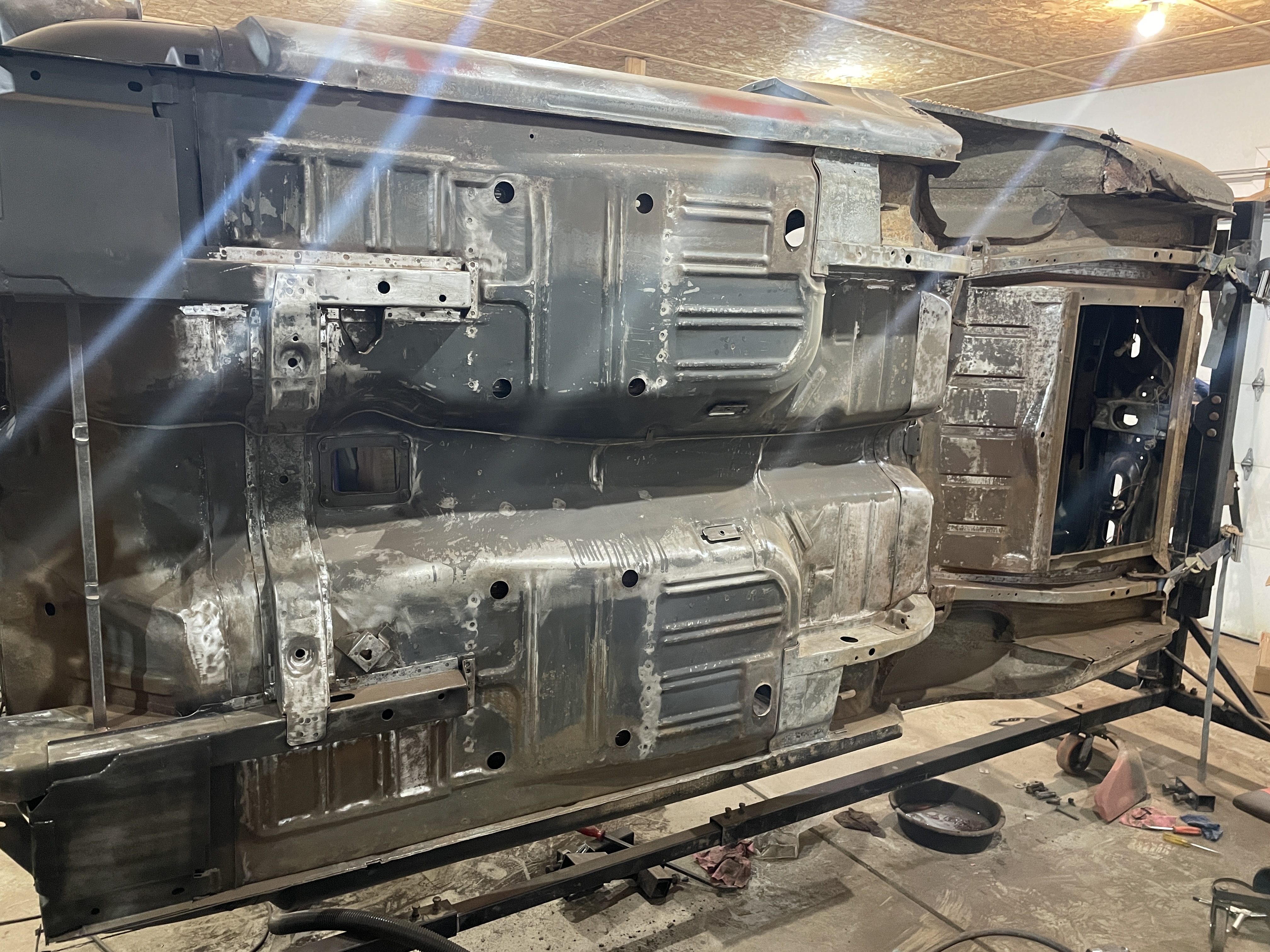

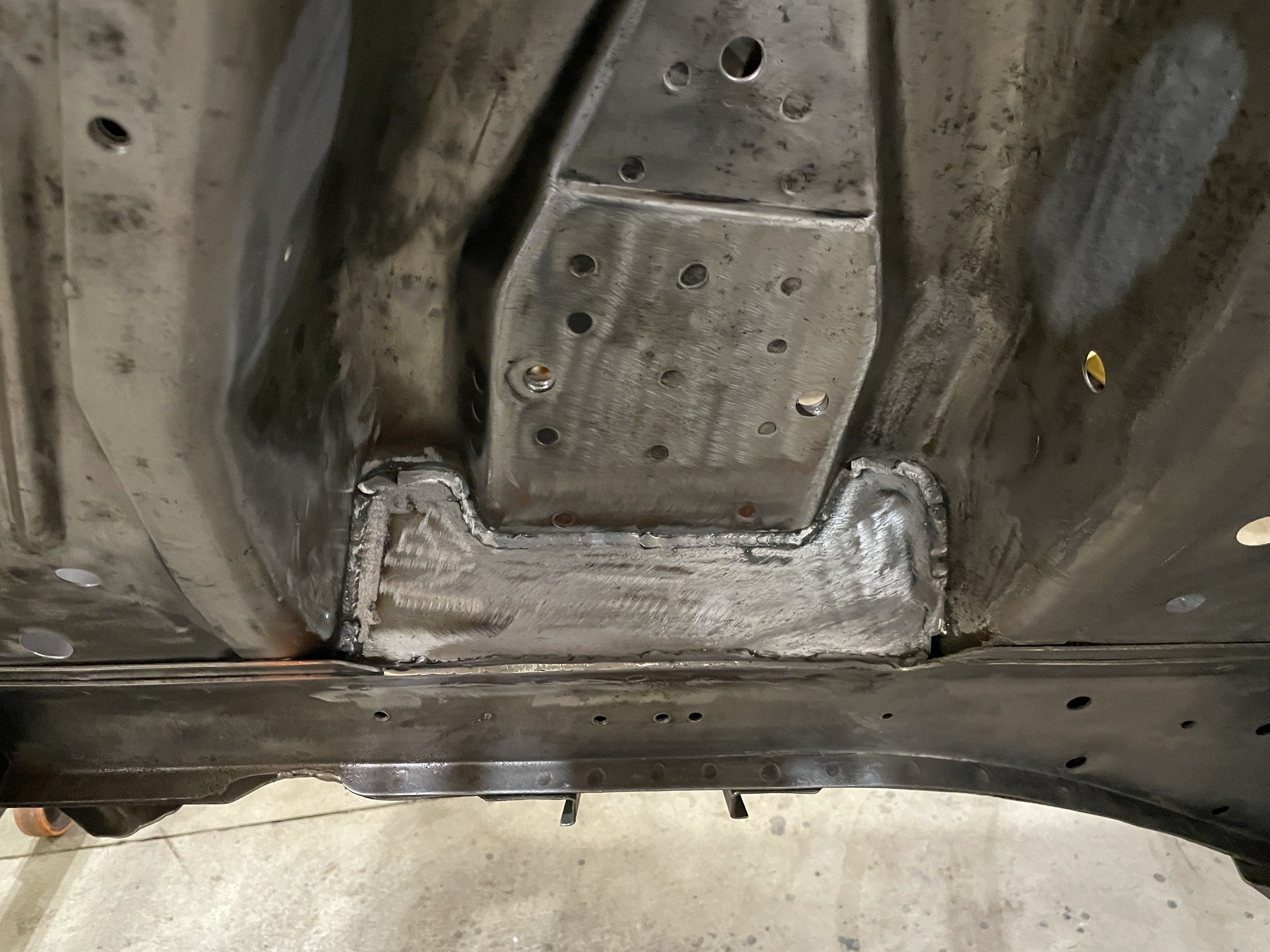

Wire wheeling of rust finally done…this one was thick…now for Fast etch and
master coat
Wow. I can’t even imagine trying to put that all back together.
I hope to have it on wheels by May!
