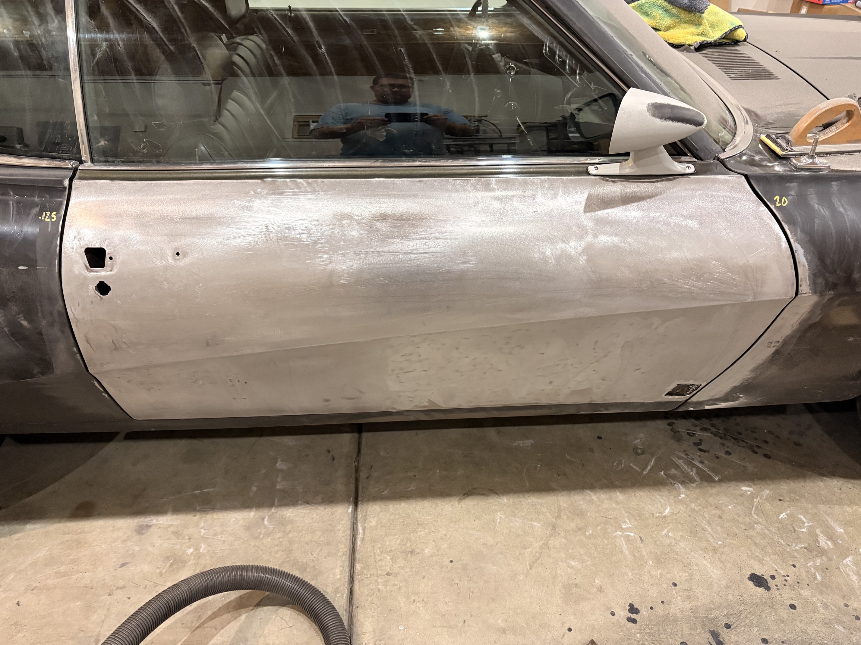

Time for an update…retired life hasn’t given me as much free time in the garage as I’d hoped for. Finally working the body over. Starting with the passenger door and repairing 40 year old damage from a jealous ex girlfriend…
