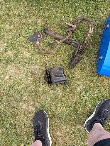

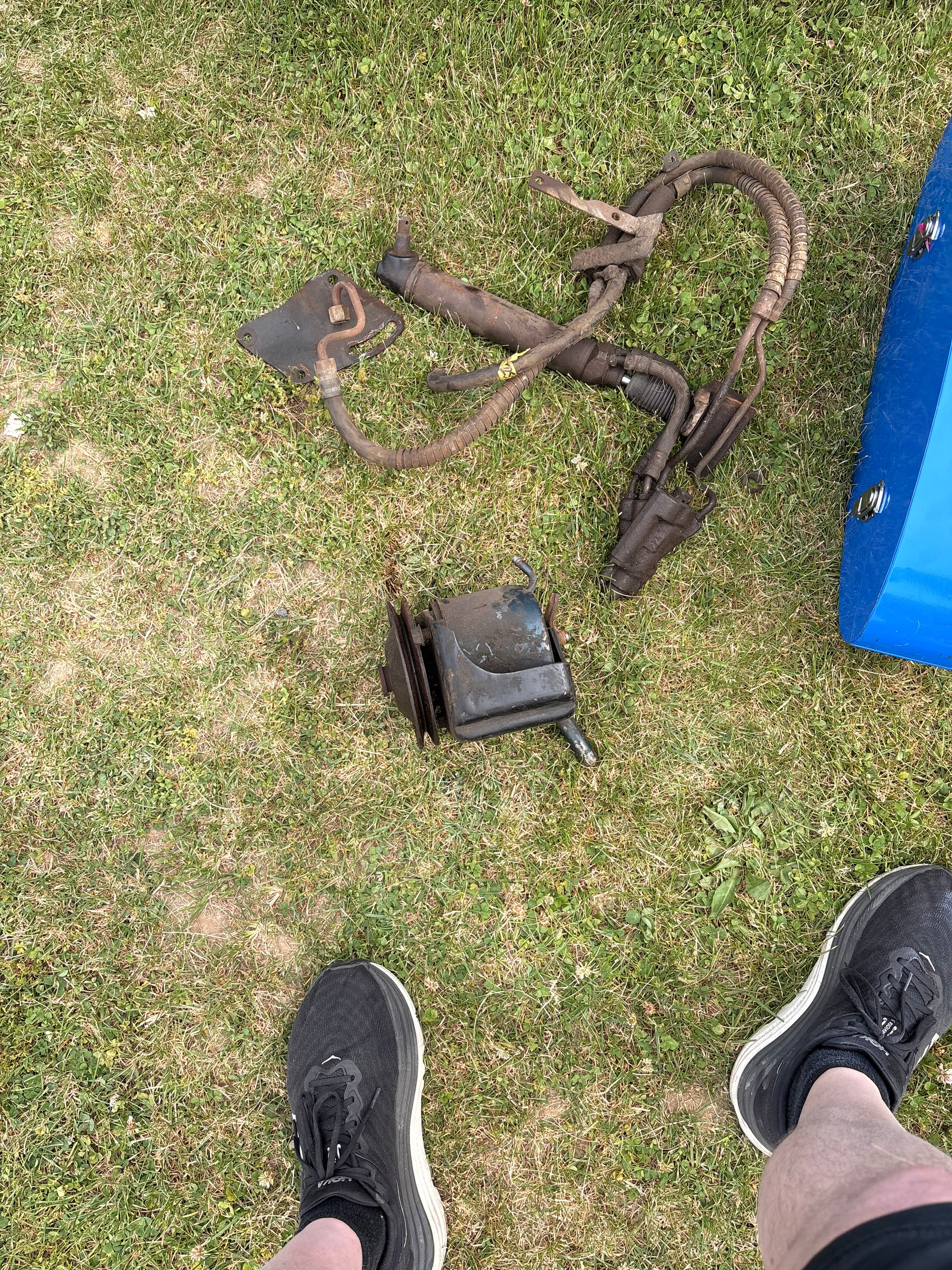

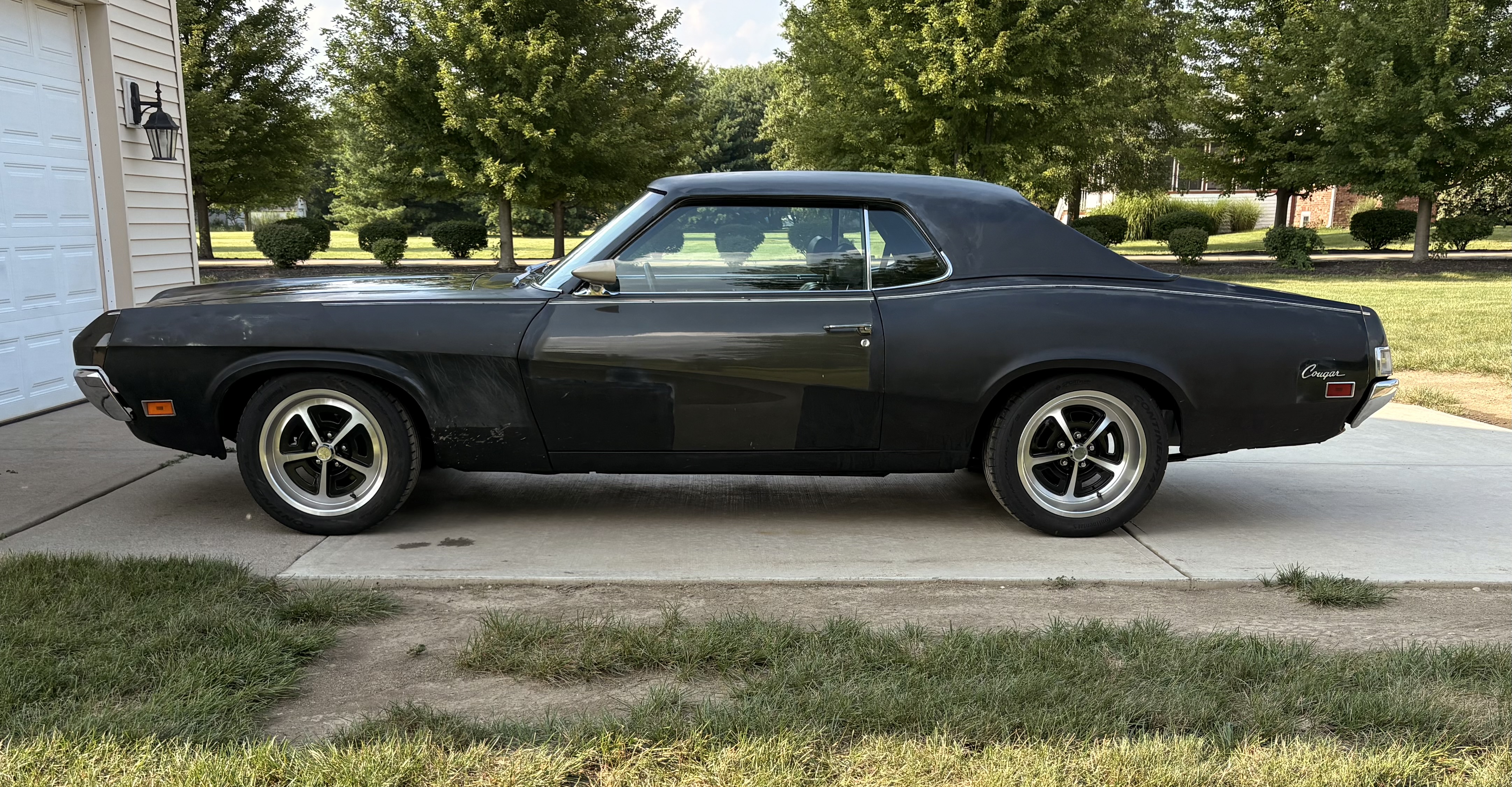

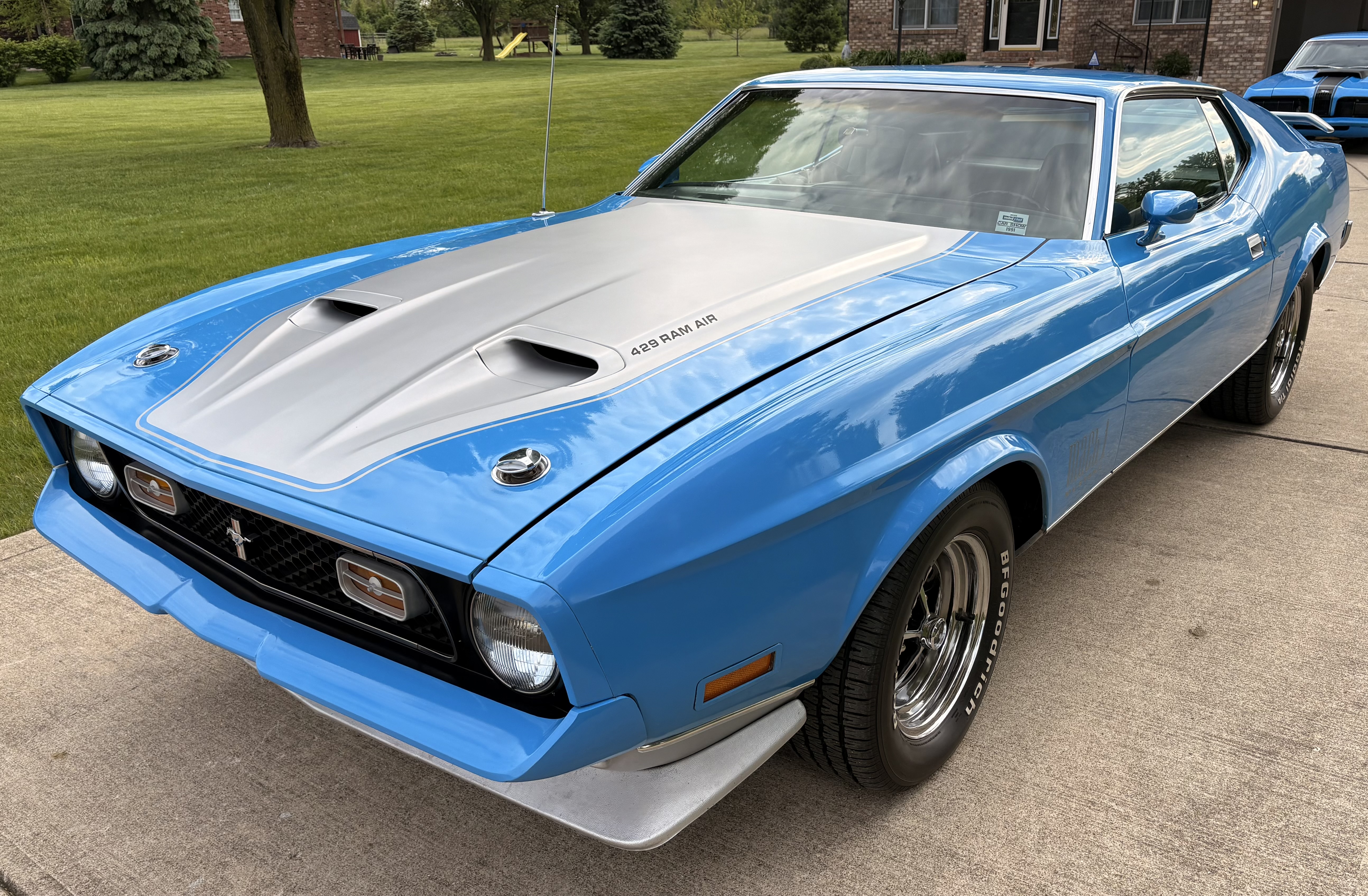

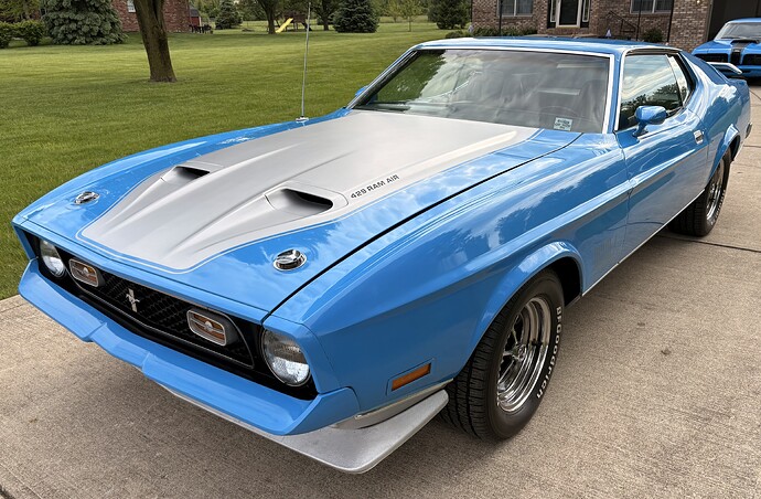

Well, after a $25 power steering pump from the swap meet, it made it back no problem..500 miles on it now and a small list of things to fix until i take it apart for body finishing
Well done good Sir!!!

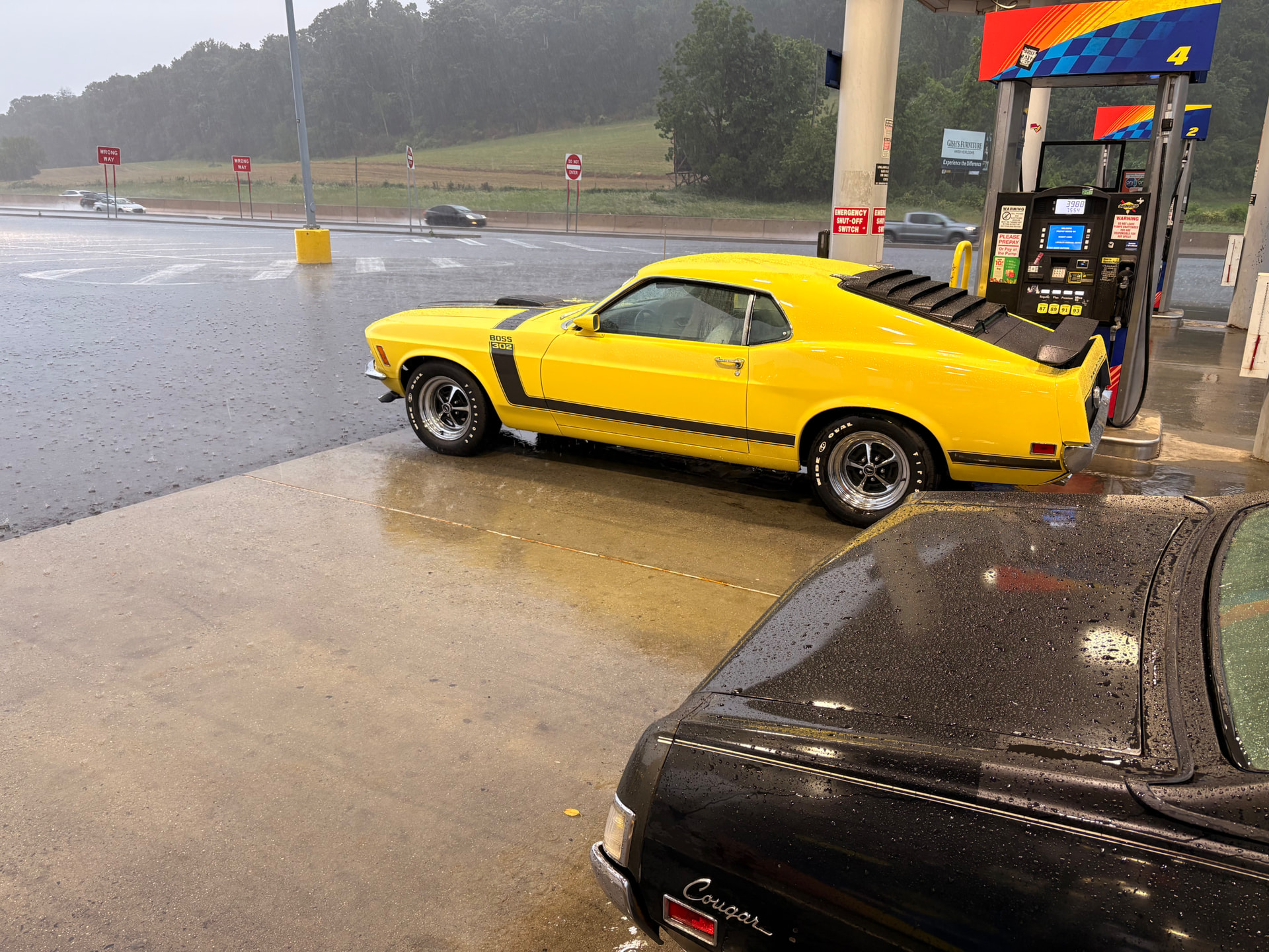

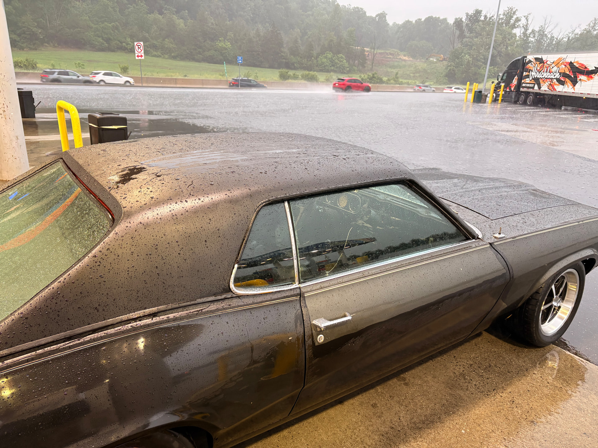

Just had to ride back in the pouring rain
Ugh. Sorry about that. I guess you can call it an underbody wash jog

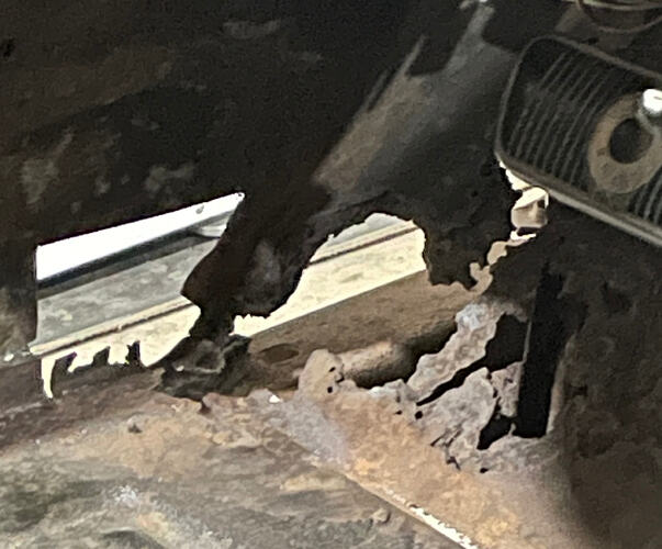

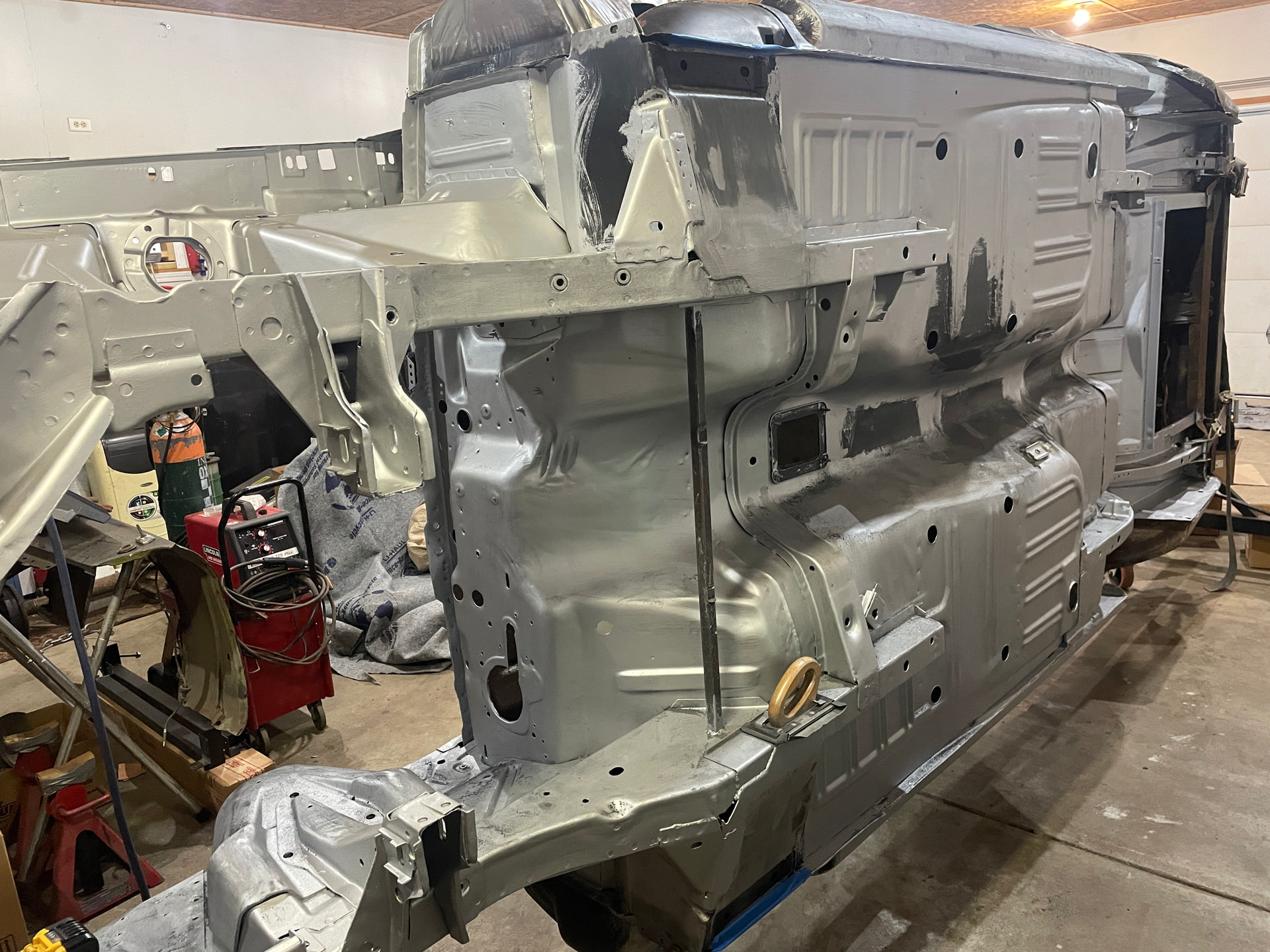

Just a reminder of where this started and what stage it was at exactly one year ago…on a rotisserie with no paint…

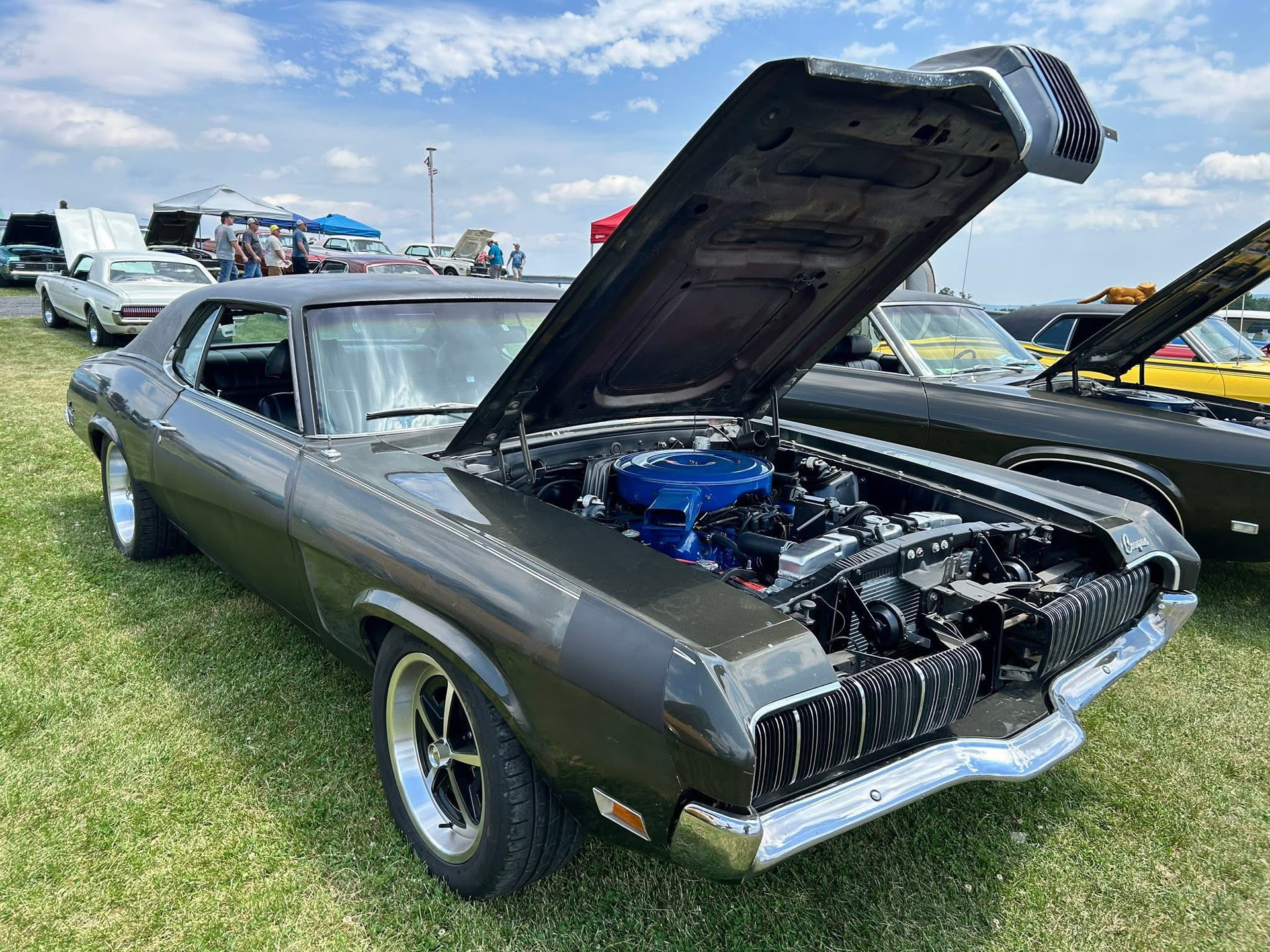

Ok, back to work on it after retirement activities…installed a bump steer kit from Baer due to toe changes during suspension travel caused by lowering. Got it aligned. Drives even better. Still have the swap meet ps pump on it from Carlisle and 900 miles on it. Borgeson Saginaw pump was defective out of the box…new one ready to install. Getting ready to install a/c lines. Also got some carb and timing tuning done and put the ride height to its final setting. This is with 3/4 tank fuel

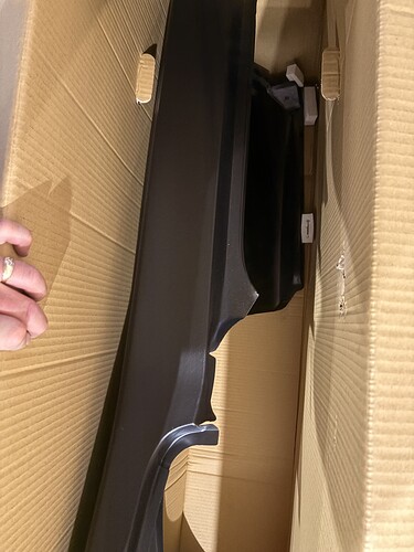

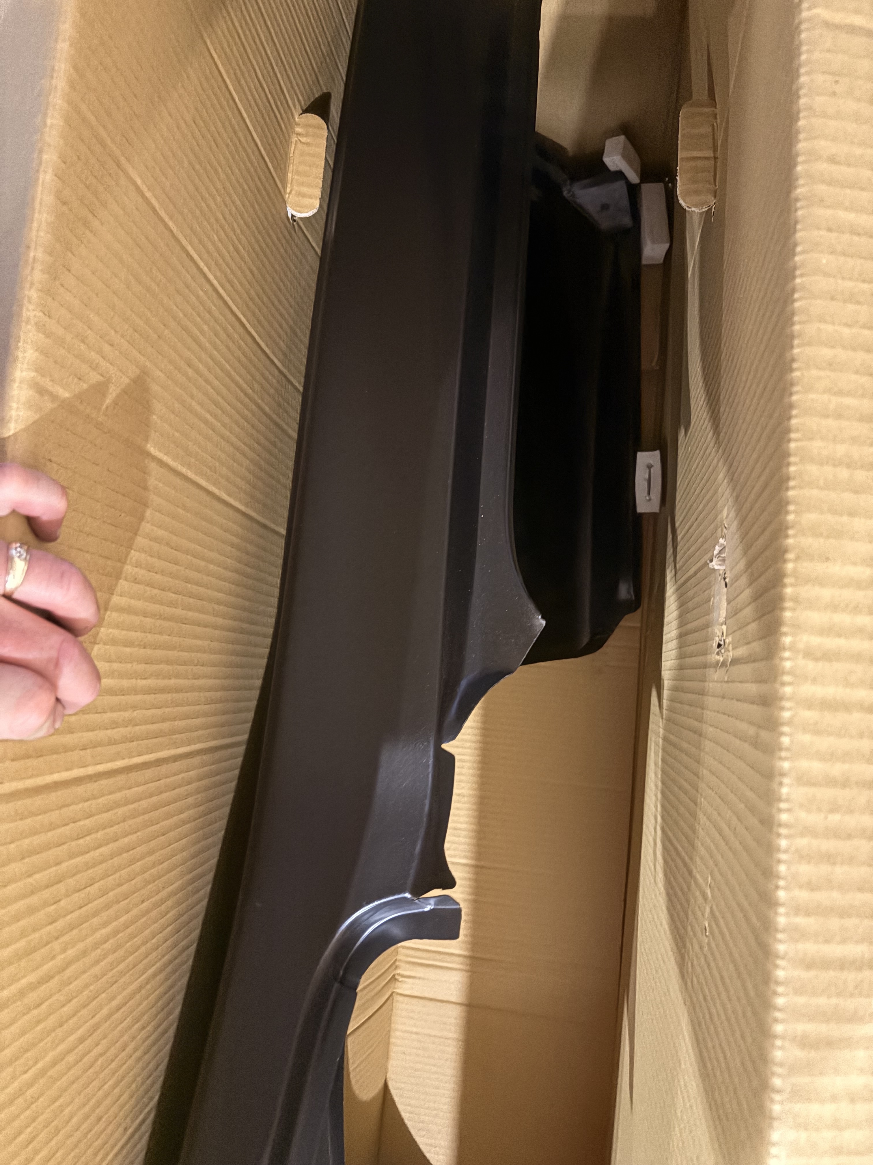

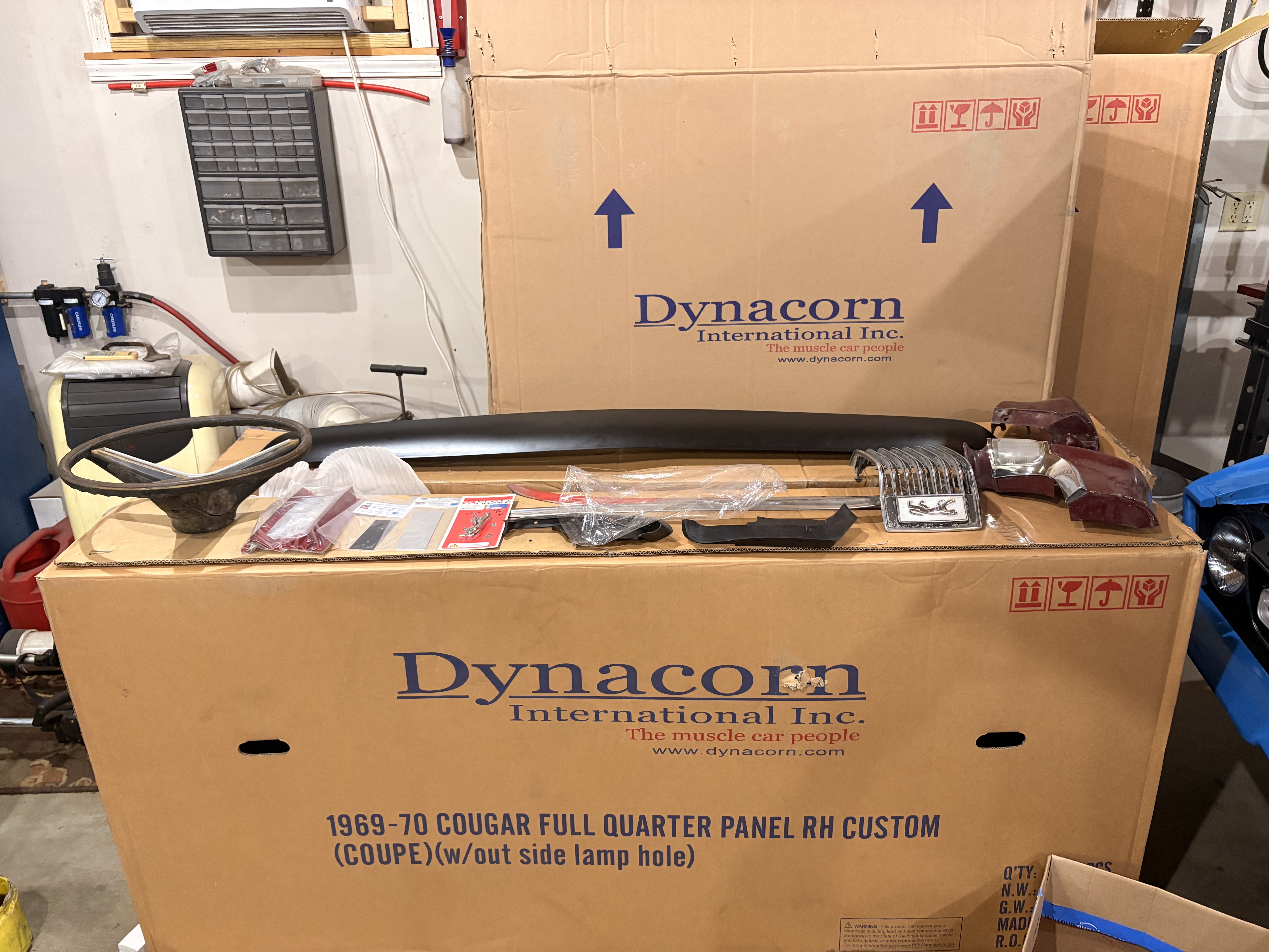

Made a trip to John classic cougars today to pick up some dynacorn sheet metal and some odds and ends…

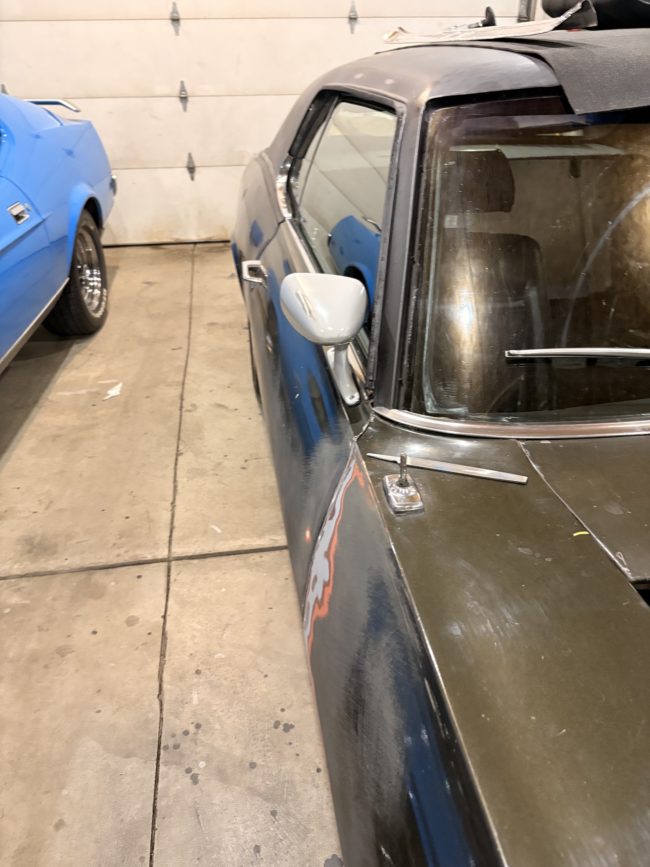

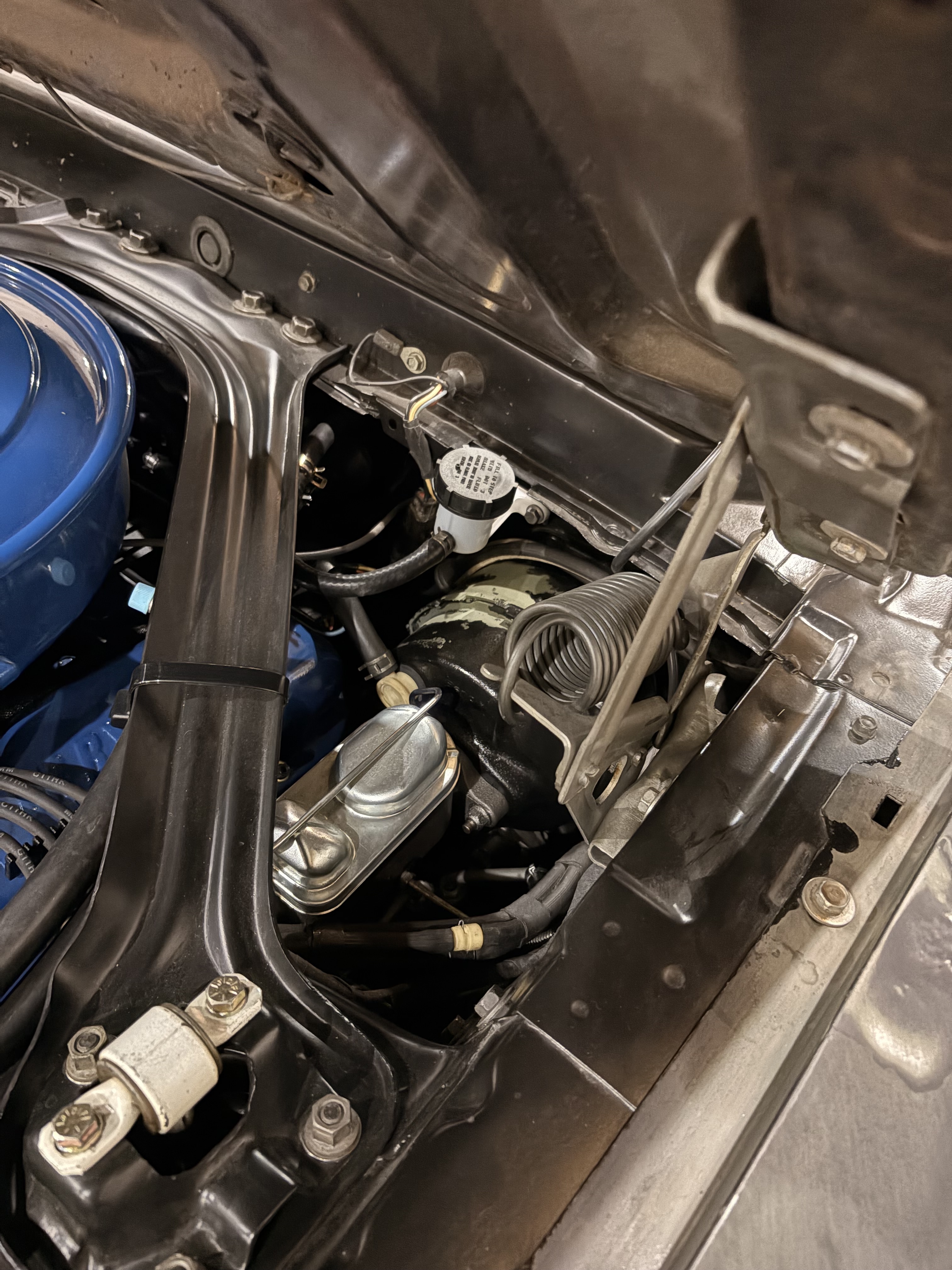

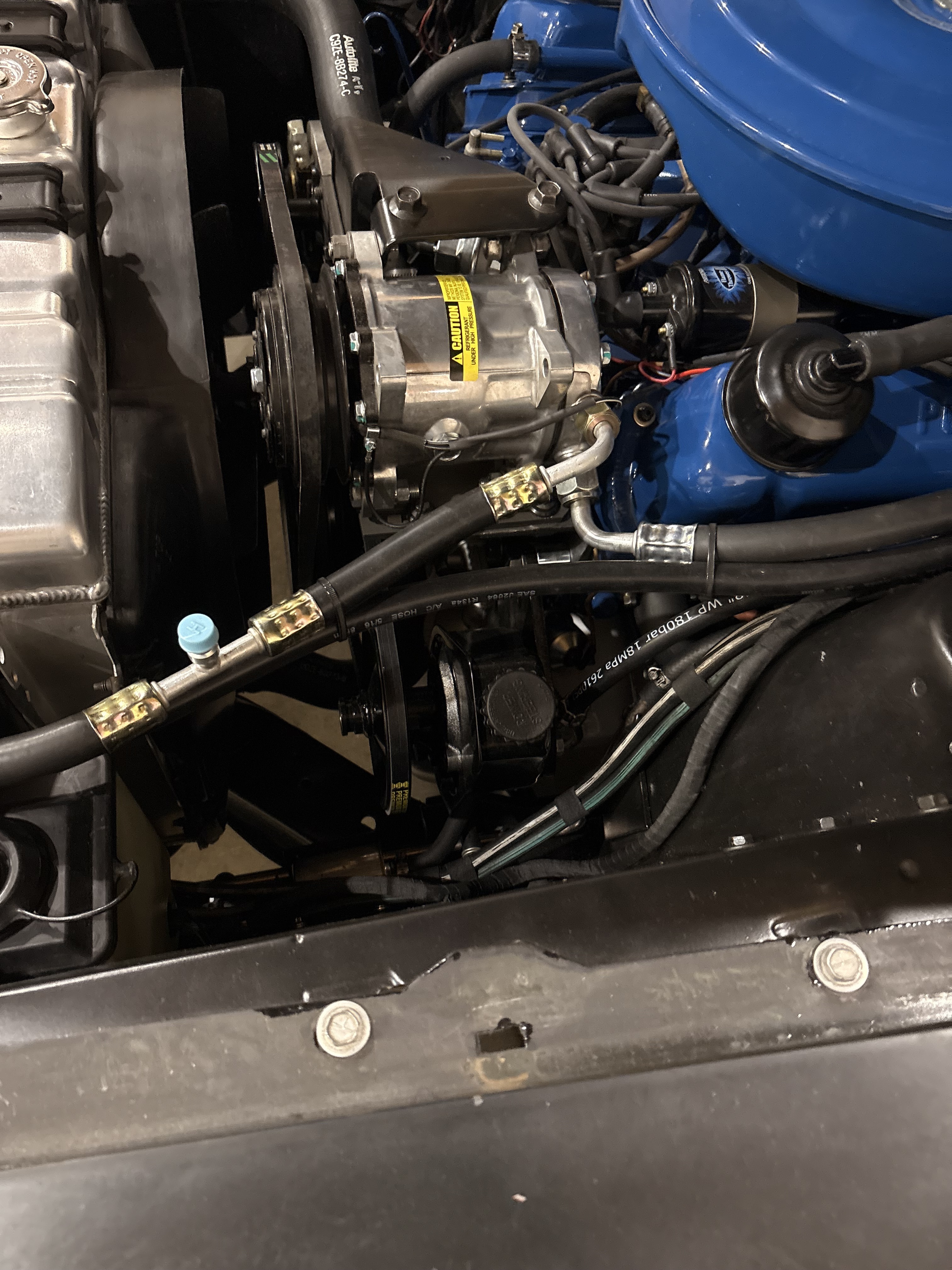

Also installed passenger mirror, trunk divider, clutch reservoir with no vent (booster repaint necessary), Saginaw pump, and ac lines. 1100 miles on it now

What hydraulic clutch is that? I’m running a Tremec T-5 with a cable clutch from Modern Driveline. I had an option for hydraulic but was concern about space and access. It looks like yours clears the brake booster and the reservoir is accessible. How tight is it under the dash?

My hydraulic kit was from malwood and it bolted right in. It bled the first time with no special procedure that the modern kit seems to take. I used an external slave cylinder from modern driveline that bolted on the outside of the bellhousing. Super easy effort. Would do this again. Only change I’d make is not using malwoods vented reservoir
