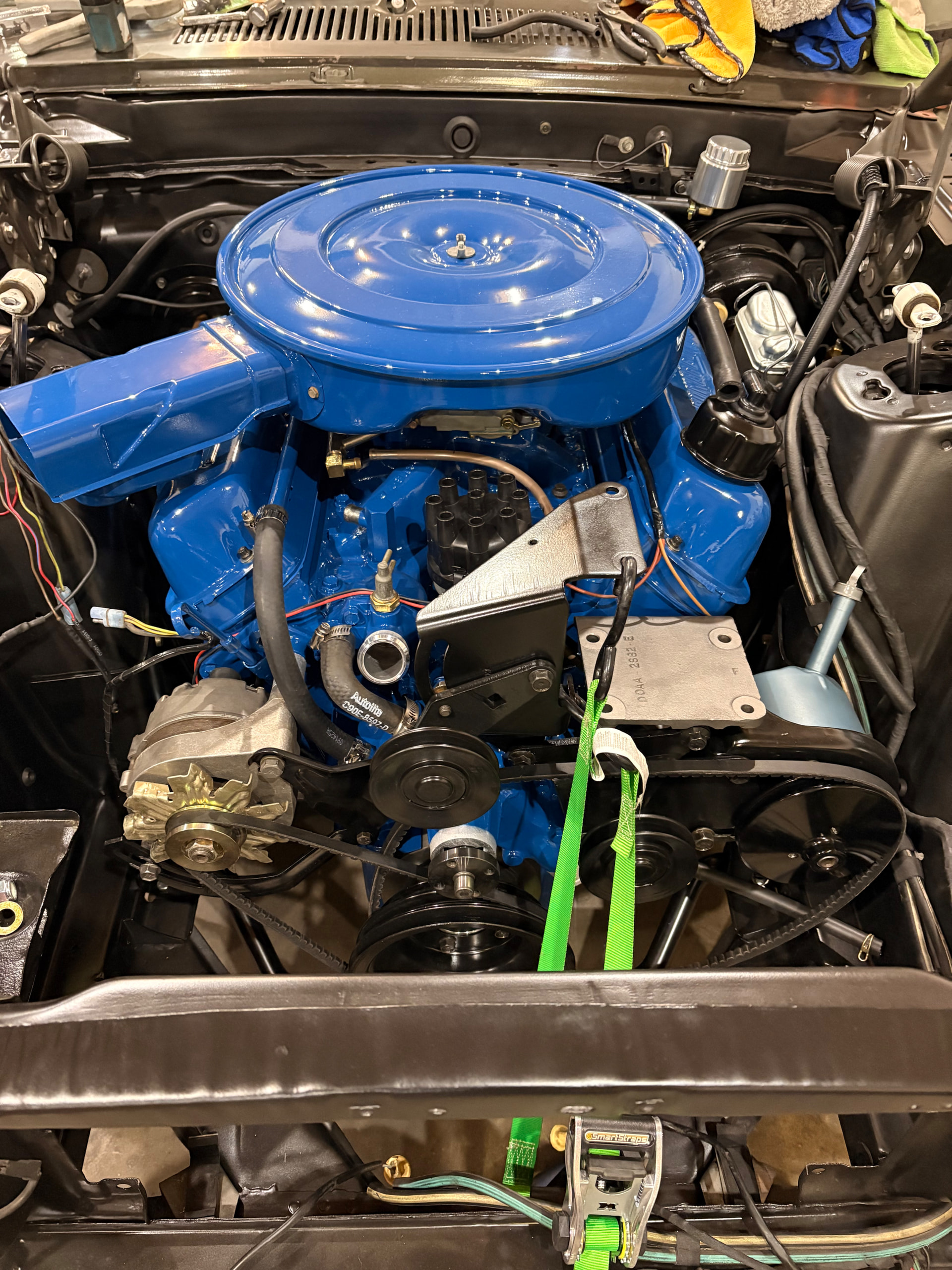

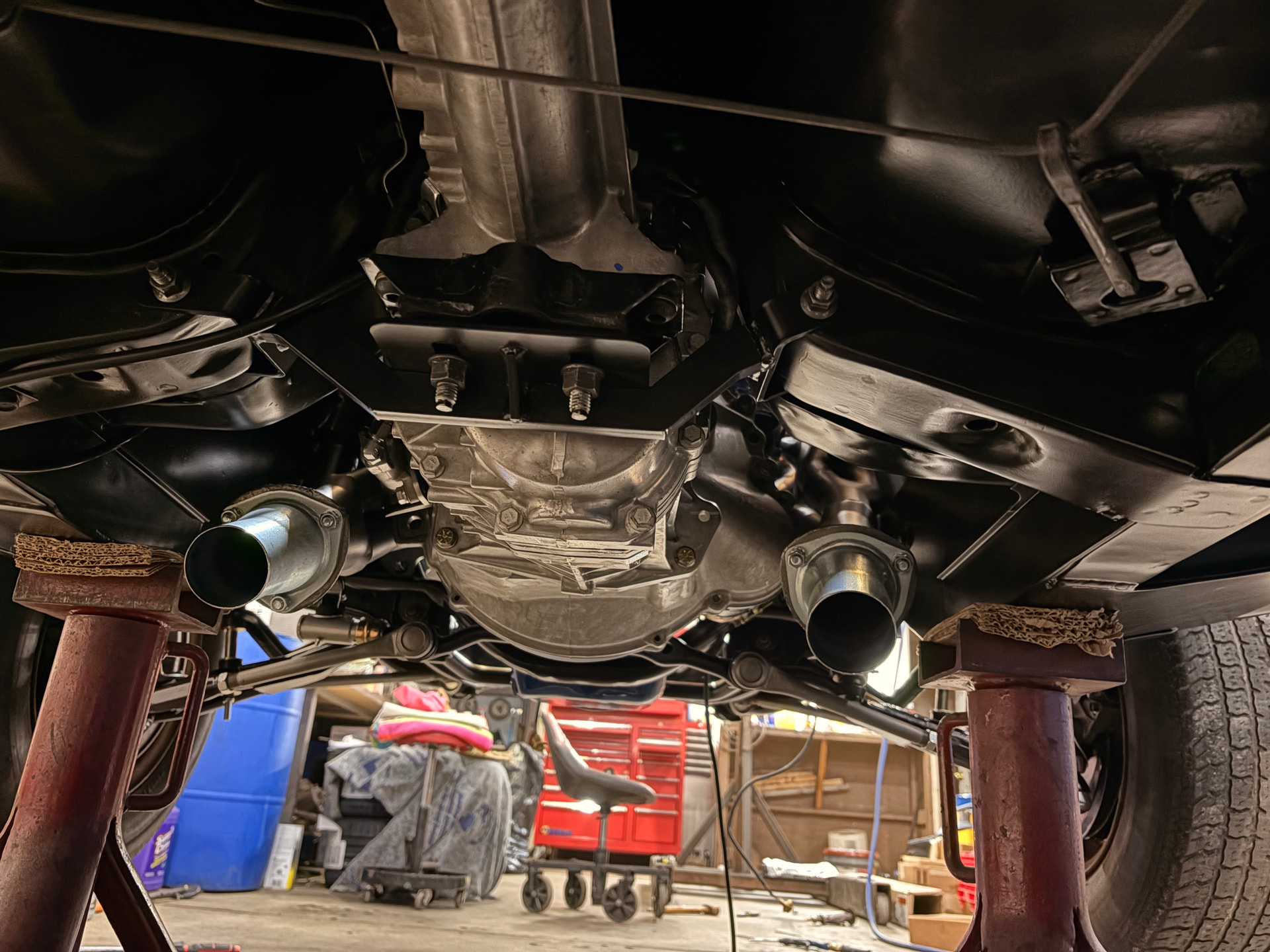

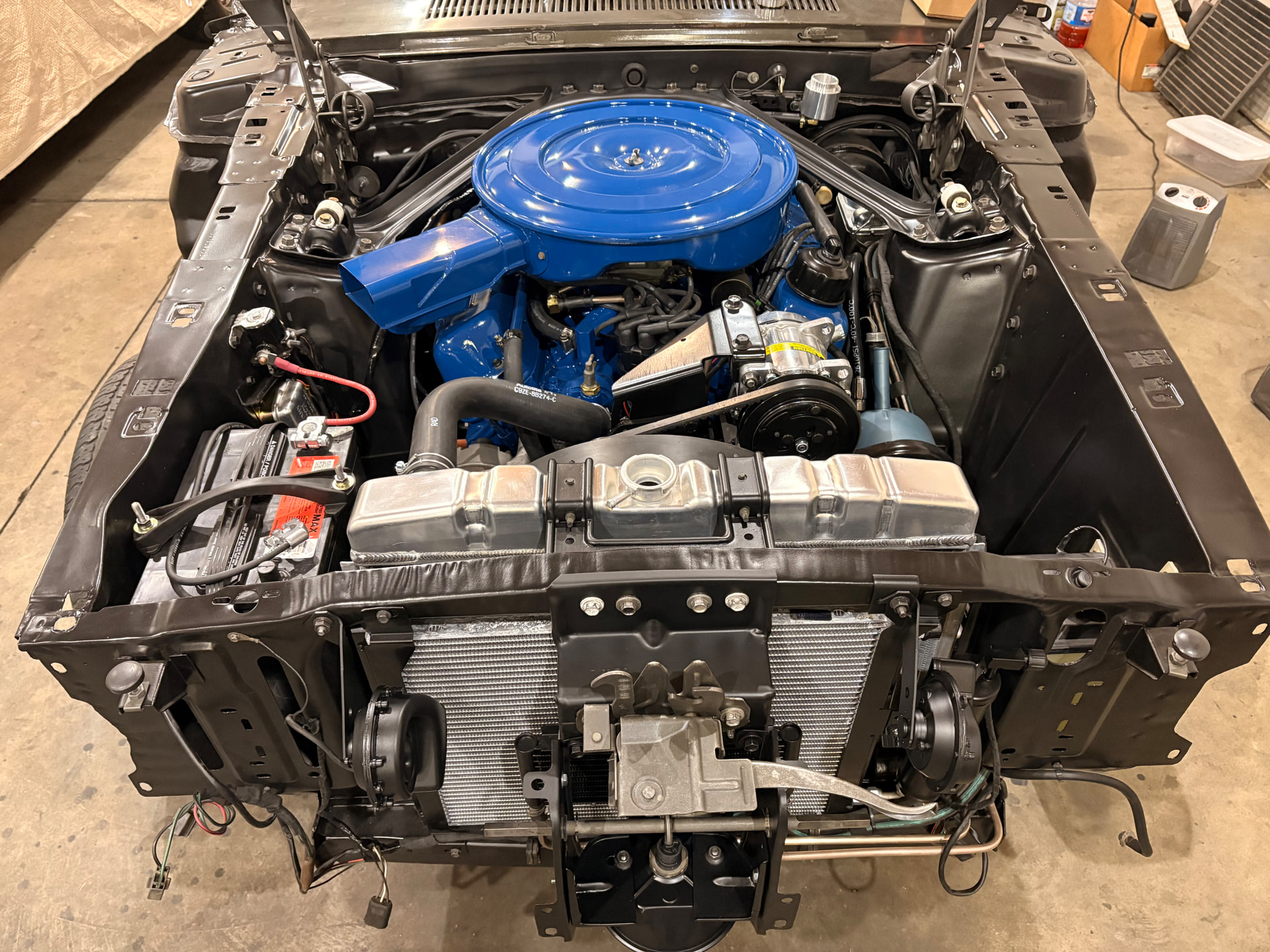

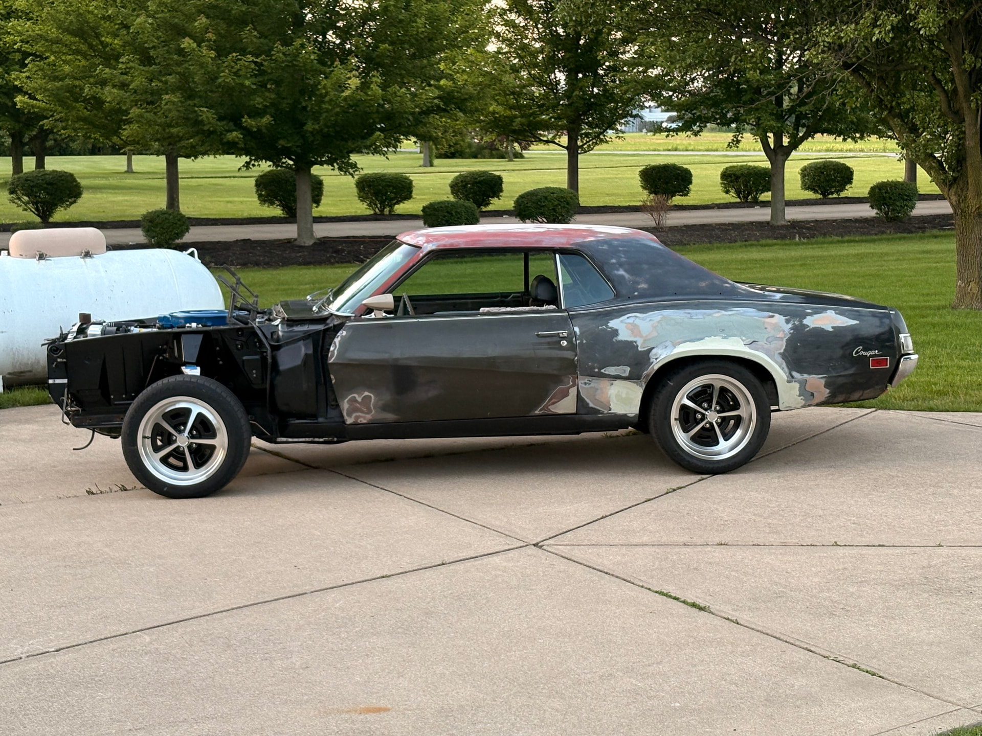

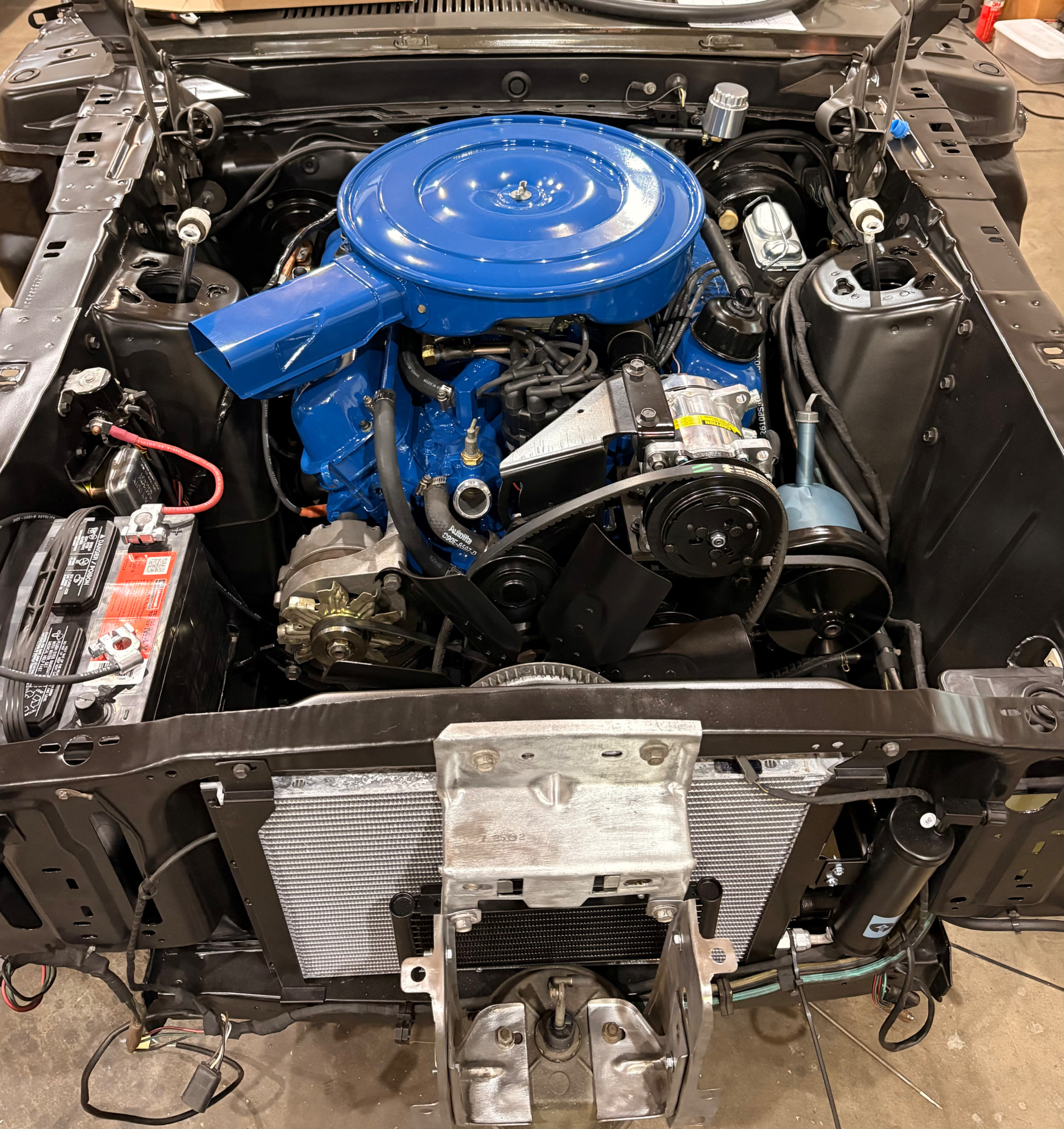

Engine and transmission in for test fit. Headers don’t touch anything! No need for clearance and I’m using the Borgeson steering gear that usually causes issues. These are nice because they terminate before they reach the frame rail. Ordered my new radiator that is supposed to work with stock brackets and ordered a couple 17x9 Holley HK magnum rims for the rear. Pictures to follow

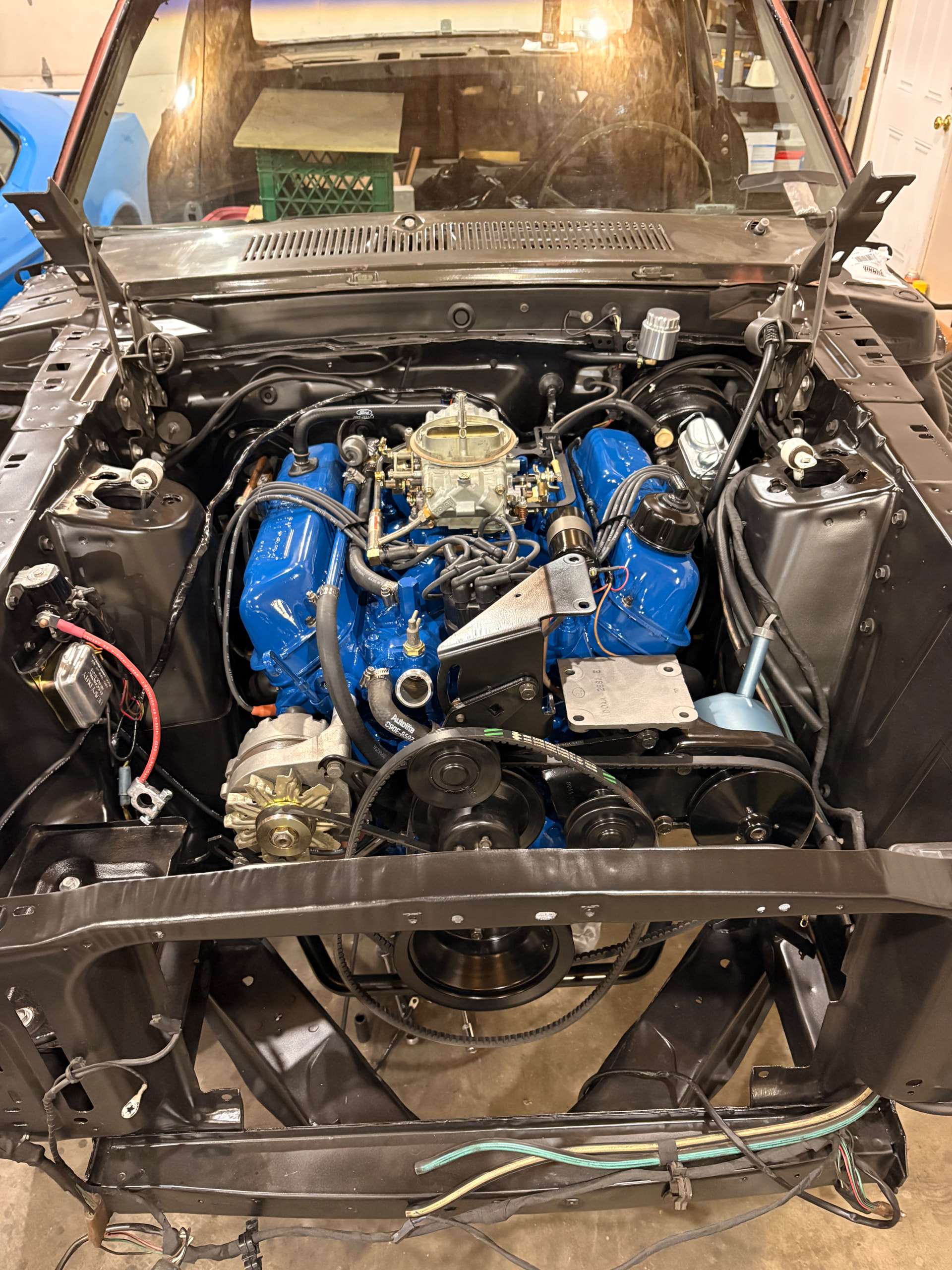

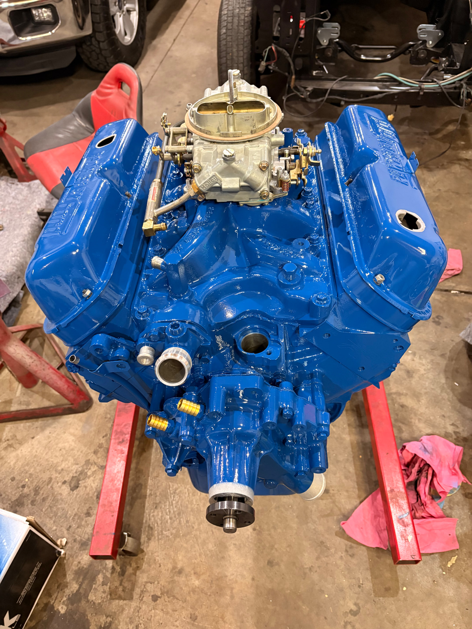

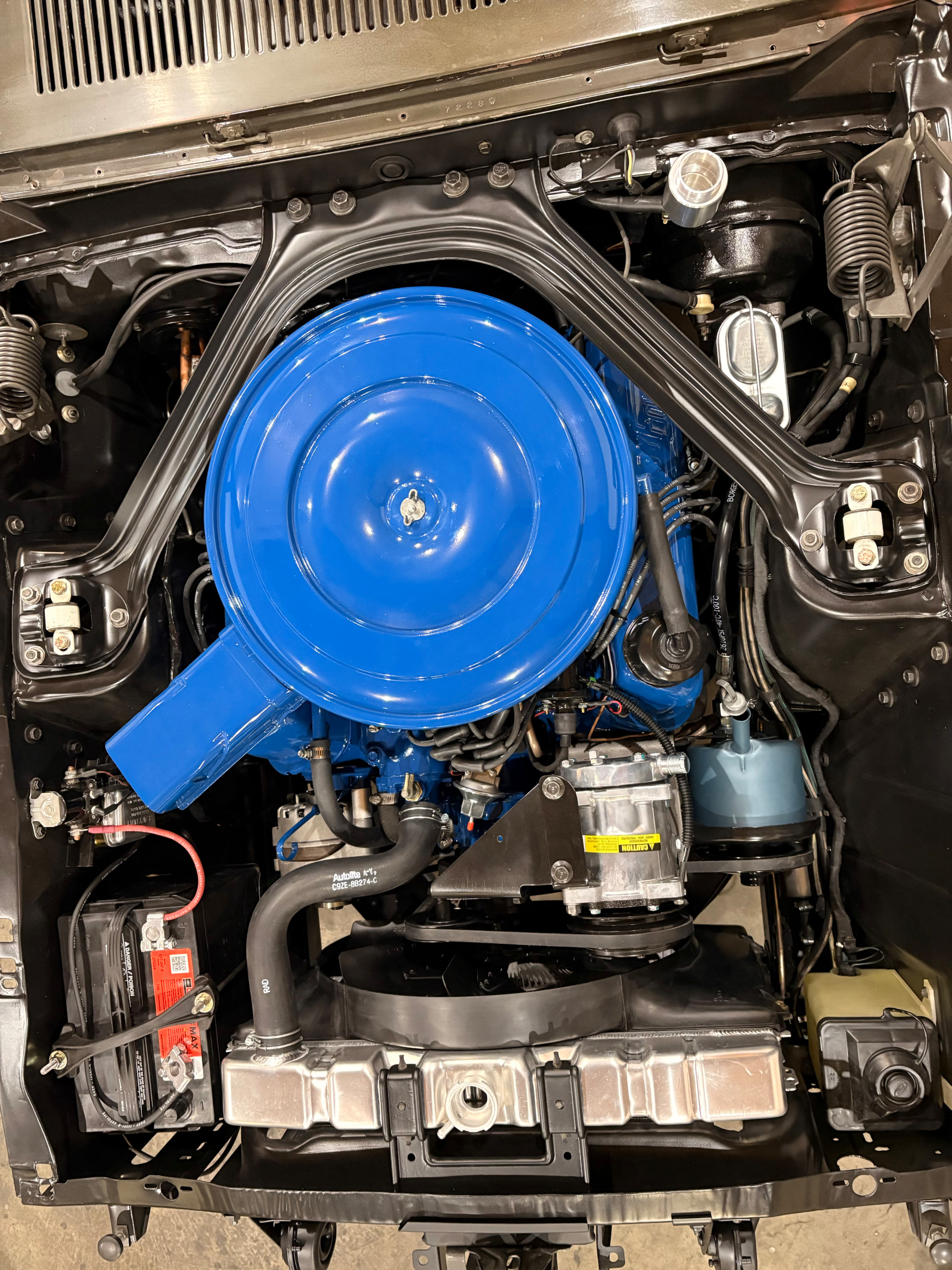

Engine finally painted today…my goal is running inside of a week or so

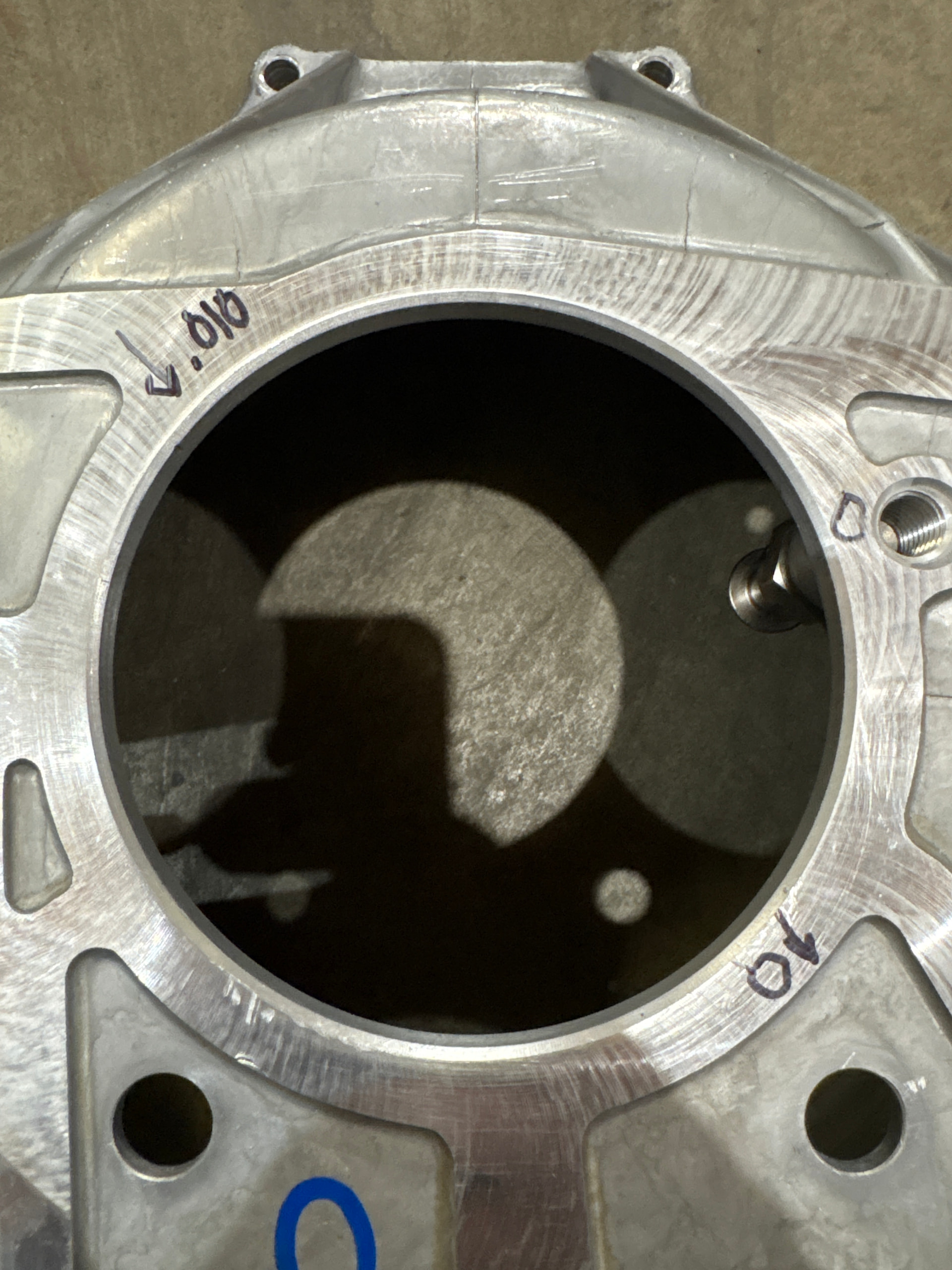

Well, gotta buy offset dowels for the new bellhousing….010” off. Tkx limit is .005”

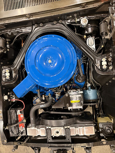

Engine is in for the last time….lots more to go, but starting to look more complete
Transmission in! Accessories and radiator is all that’s left for first fire
It officially cranked, started and ran last night for 4 seconds….now on to installing radiator,condenser, and power steering cooler and lines…then I’ll let it run and cycle coolant
Ps cooler lines making and radiator install to go
Ready for fluids….coolant, clutch, and power steering
Well it runs and drives…at least around the yard….feels pretty snappy…trying to get it ready to drive to Carlisle. It will be very ugly….

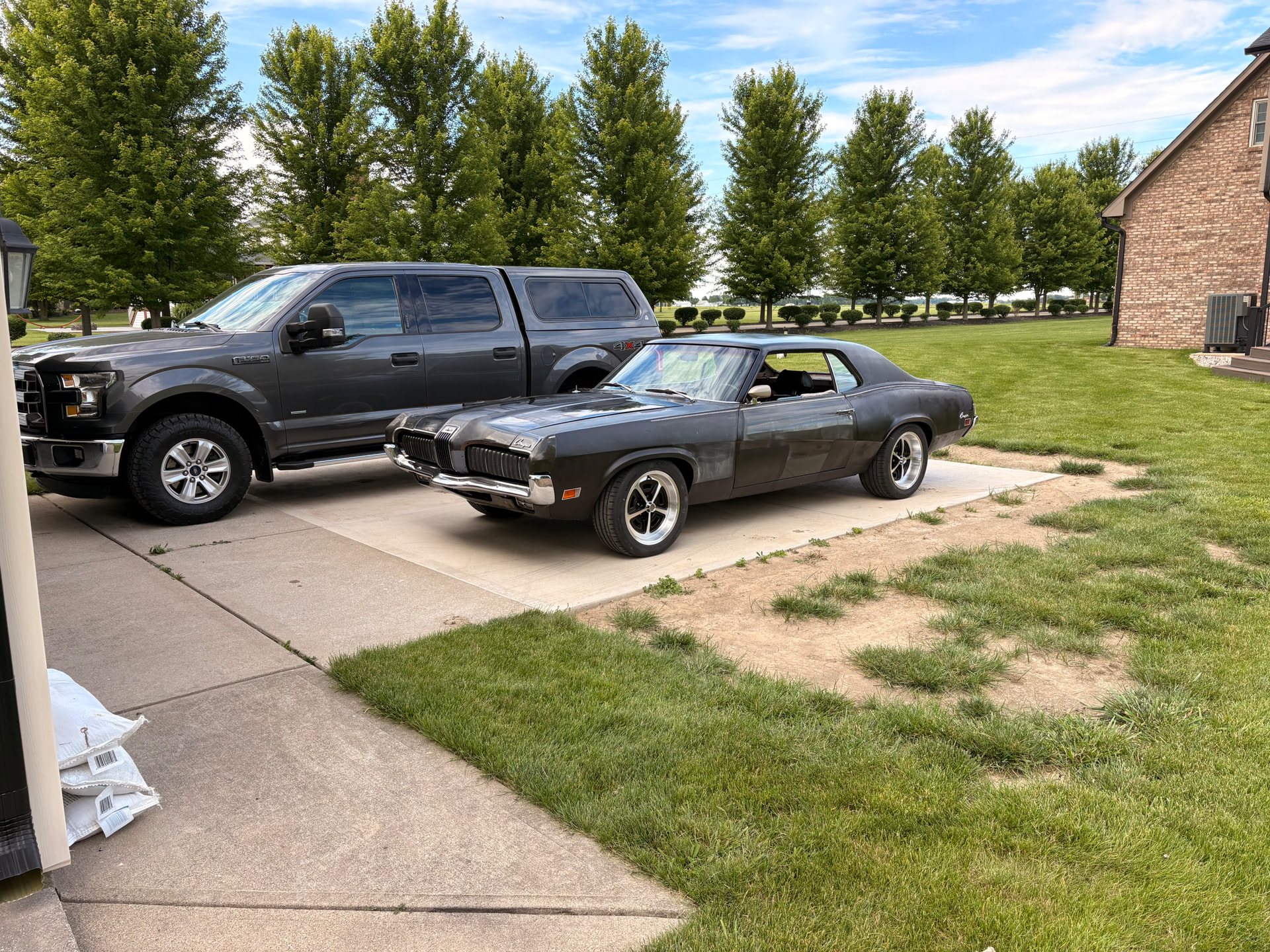

Very ugly, Bah! Fenders and paint don’t make them pretty. A solid set of core components beneath is the true beauty. I’ve decided not to repaint, fix minor dents and flaws, slight twist to the existing bumpers, and be proud of my gal because everything in her soul works and runs as intended.

Well, it made a 2 mile trip. Going to body shop for torque box spot welding and wheel alignment tomorrow. Waiting on Eastwood to deliver roll on epoxy to kill some ugly. Still on target for the trip from Indiana to Pennsylvania for Carlisle

Well, I’ve gotten 50 miles on it..no leaks. Needs some carb tuning. Gotta install the back glass and interior pieces to make it drivable. It’s surprisingly quick….and knocked off some of the ugly with roll on Eastwood epoxy primer
Well, let’s say one foot back in the grave. Power steering pump locked up as I pulled into Carlisle parking right as it passed 300 miles. Oh well…off to the swap meet. The bad news is my replacement Saginaw pump arrives at my house today.
