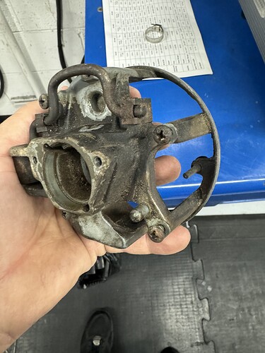

Well, I finally got around to the tilt steering column. Surprisingly enough, the fire didn’t destroy the column beyond repairs. I completely tore it down, cleaned and cleaned, used a junkyard column for small donor parts. New switches and refinishing brought it back to life! I included some before and after pics. Next up, Phoenix needs brakes!

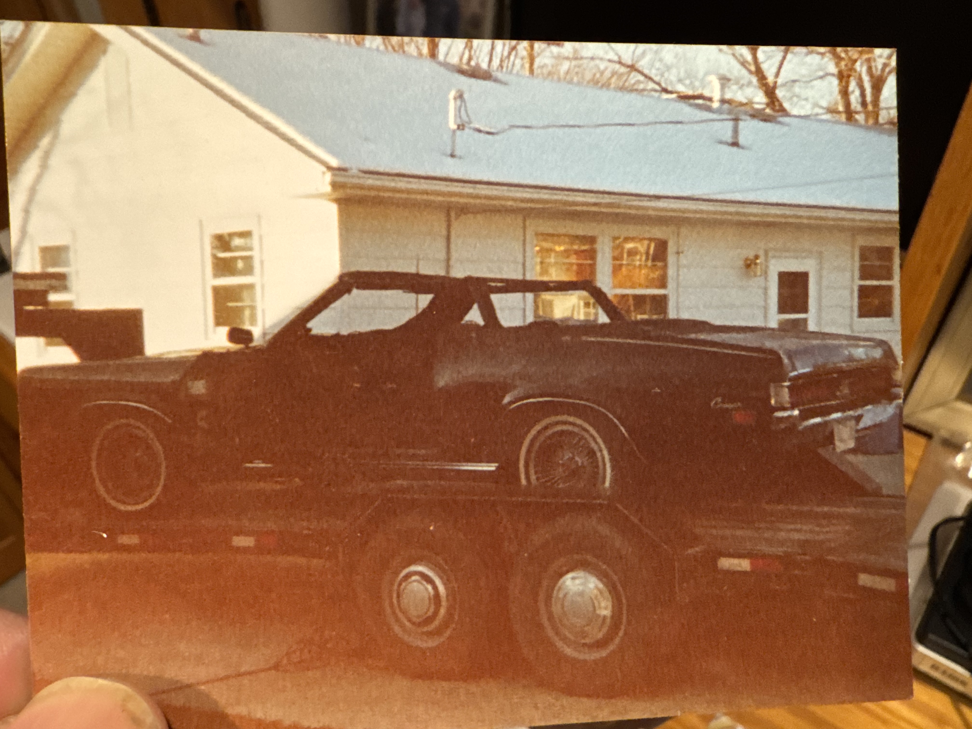

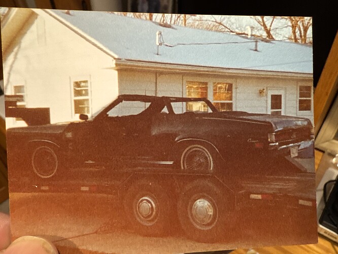

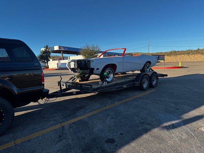

Well, this picture is not in chronological order, but I just found it. This is Phoenix just after the inferno loaded on a trailer on its way to me. Kinda of a grainy picture, it started and was driven onto the trailer. I wish I could unsee the whitewall tires!

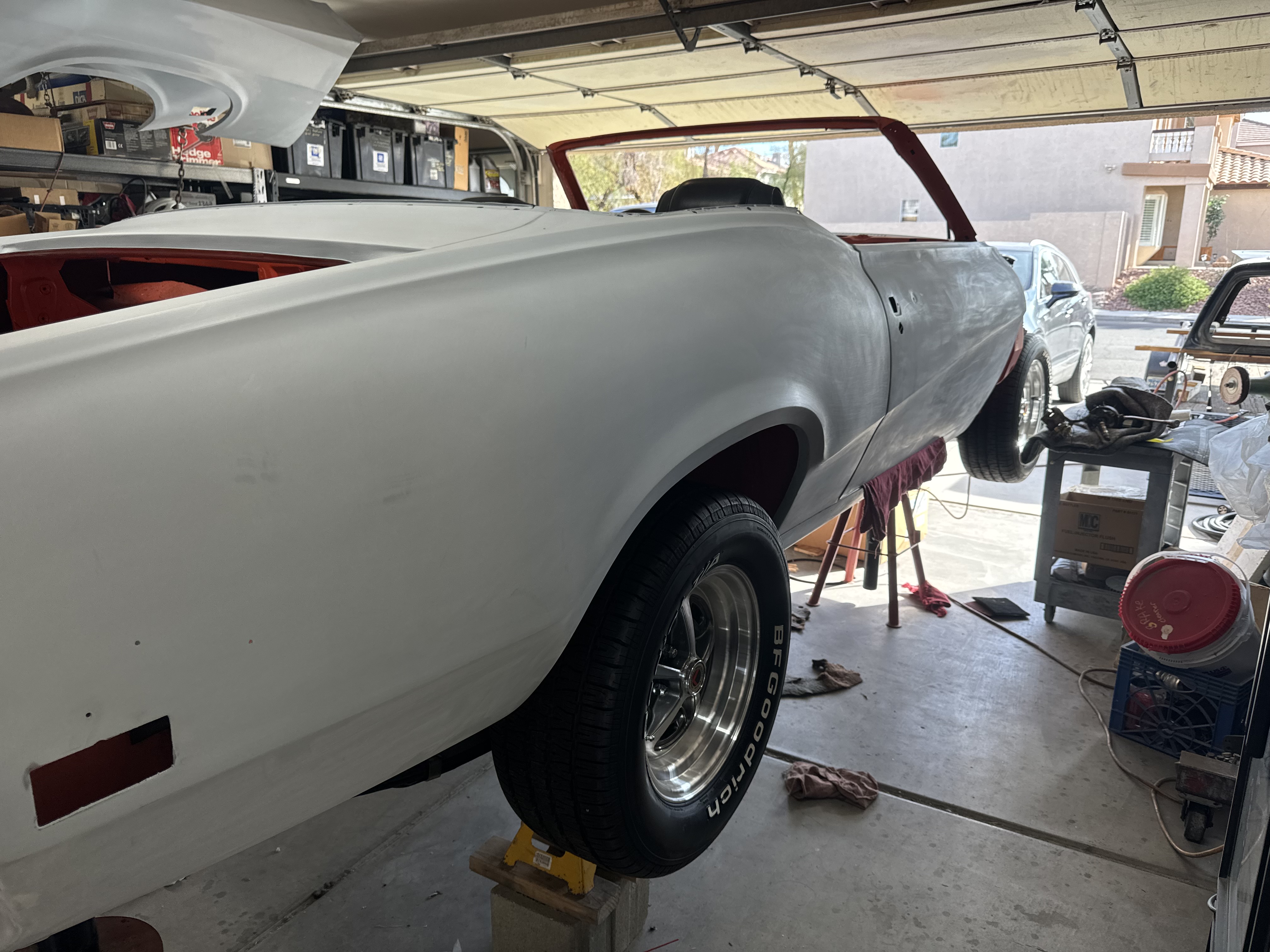

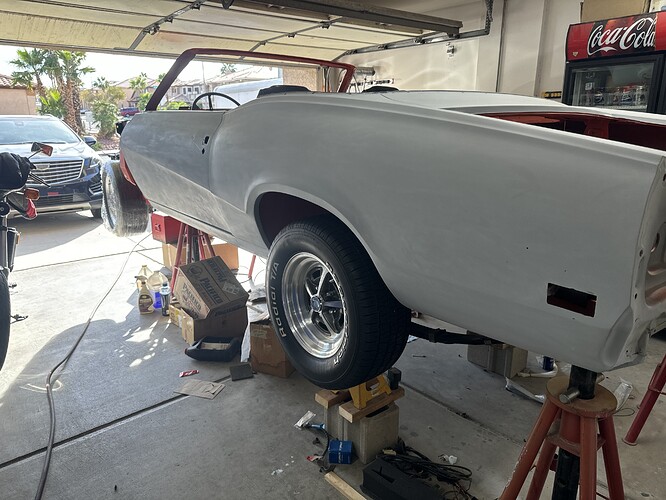

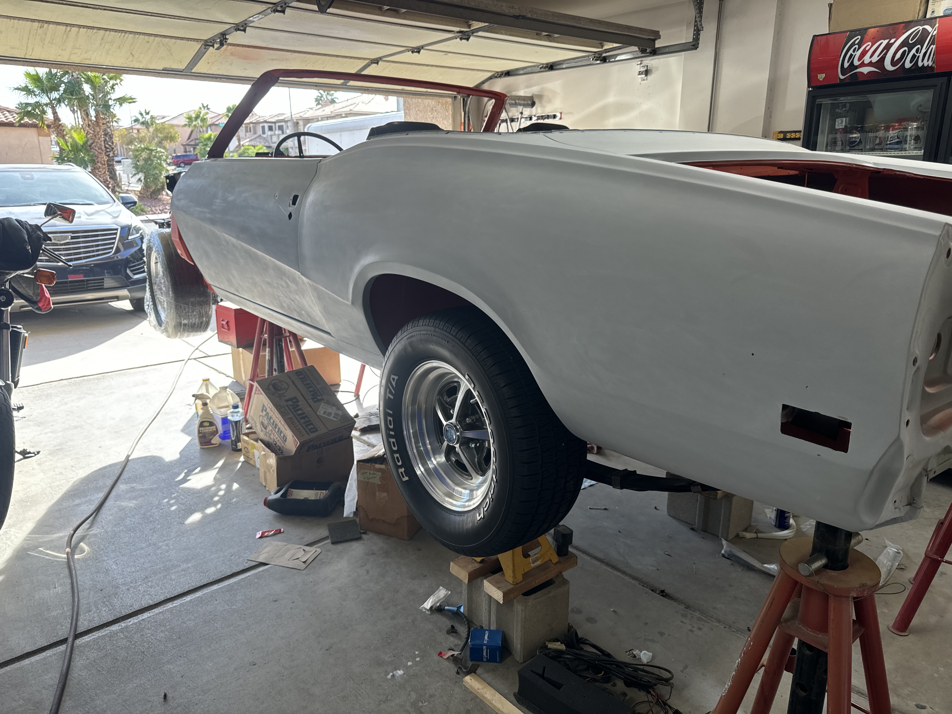

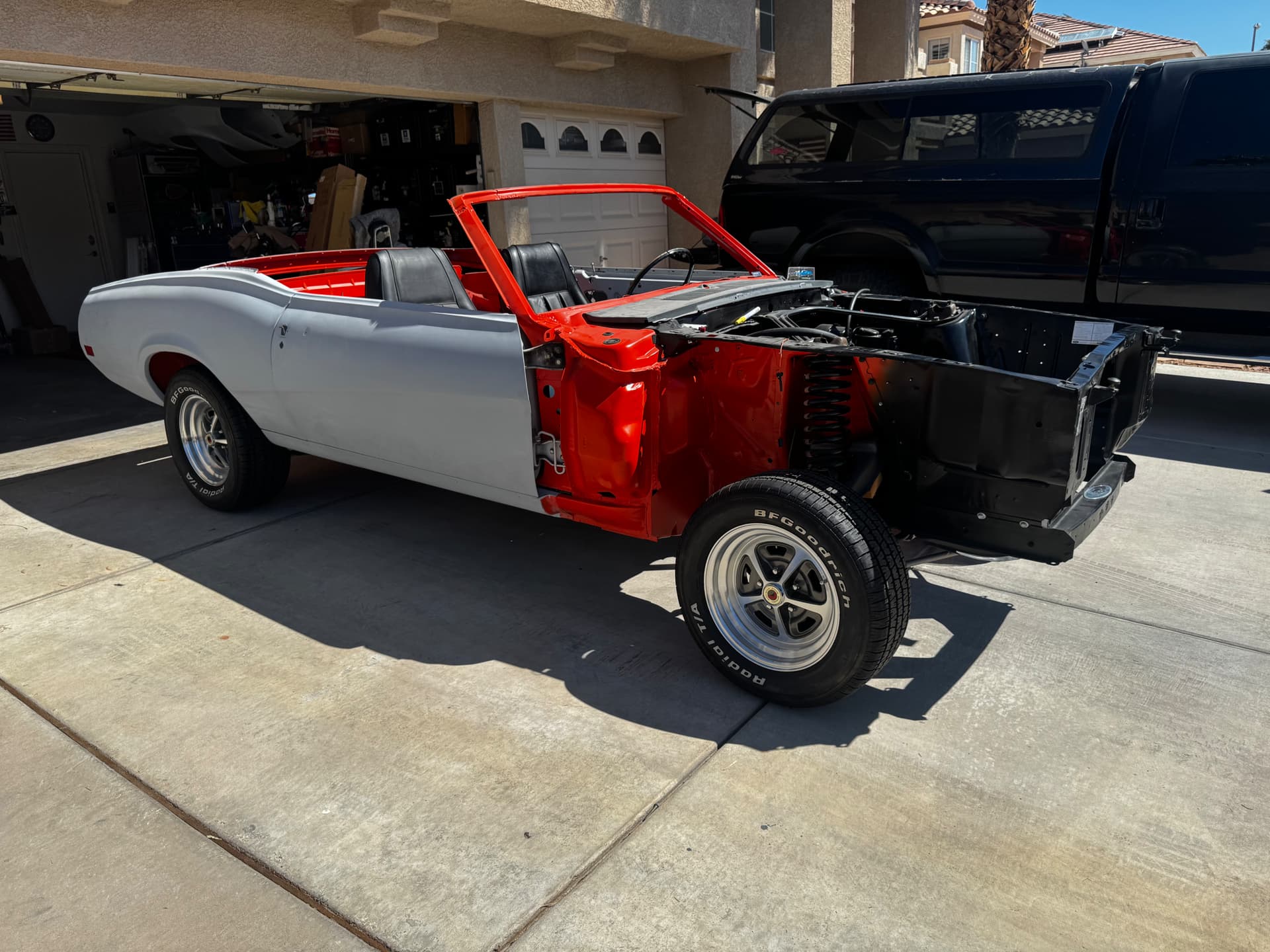

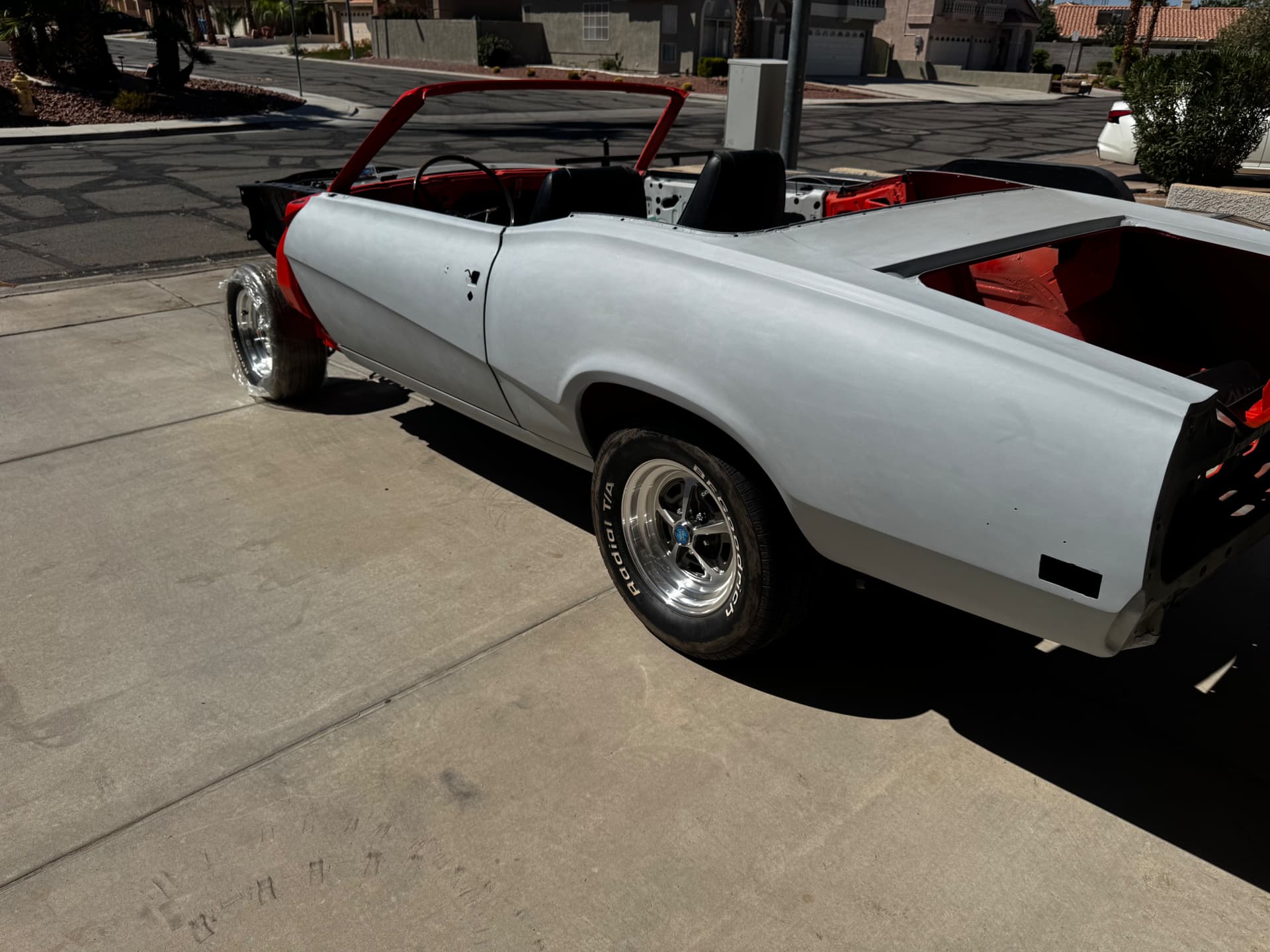

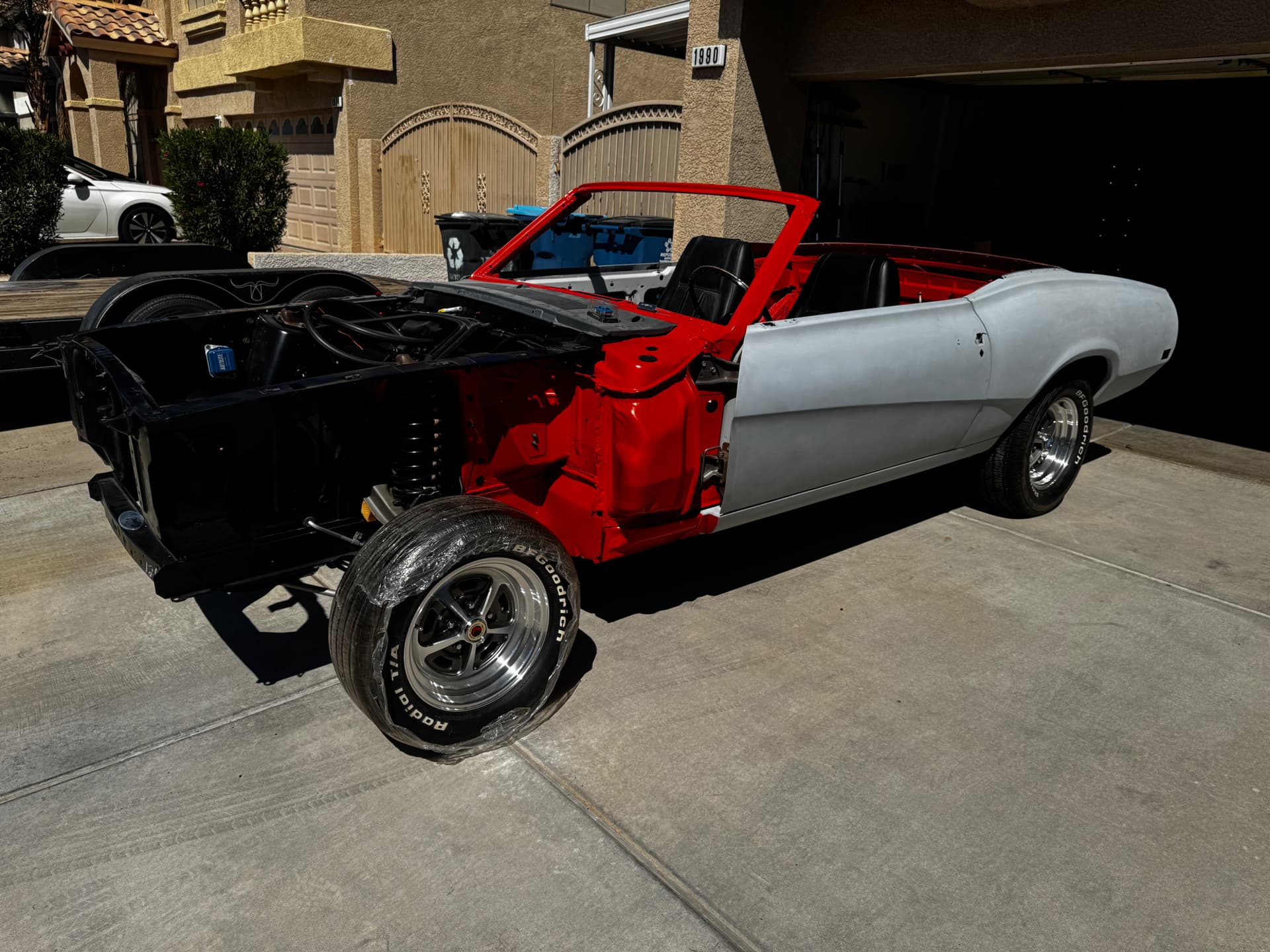

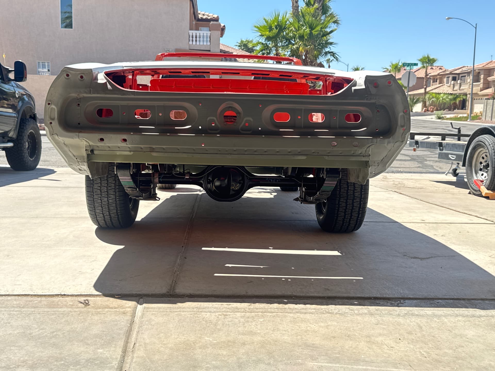

Well, there hasn’t been much progress in the last few months due to work being busy and other obligations. I obtained some 15x7 Legendary wheels and tires from a Pic a Part 69 cougar and have been toiling away on small pieces and parts. Trying to get it ready to go for paint soon by hanging doors and panels so it can travel.

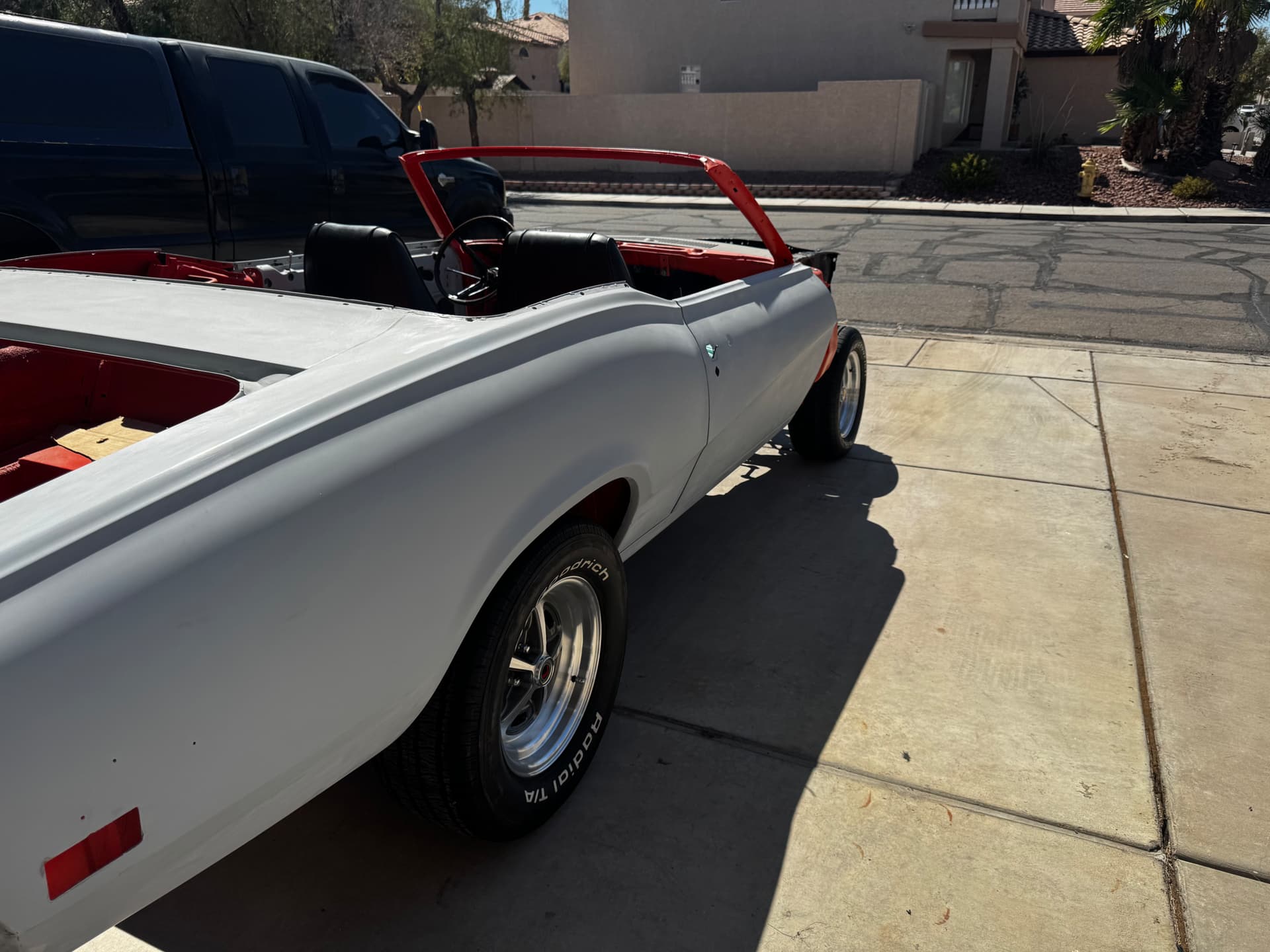

Well, I finally took Phoenix off the 4ft stands and now she’s back on her feet. I rolled her outside into the sunlight that she hasn’t seen in years! I think she likes it! Next milestone is a coat of paint code 1.

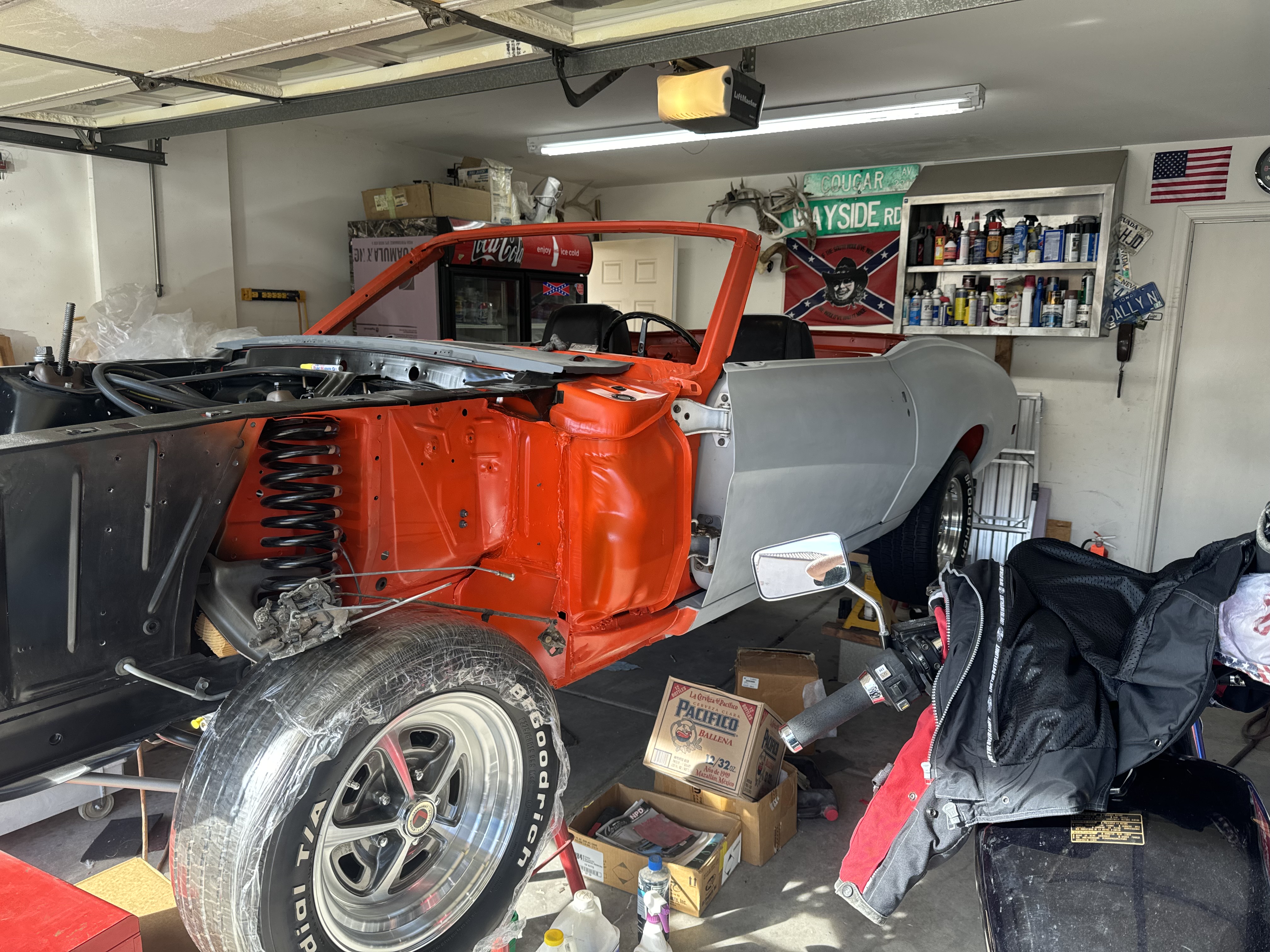

Well, another milestone has finally arrived! Phoenix is now off for paint!

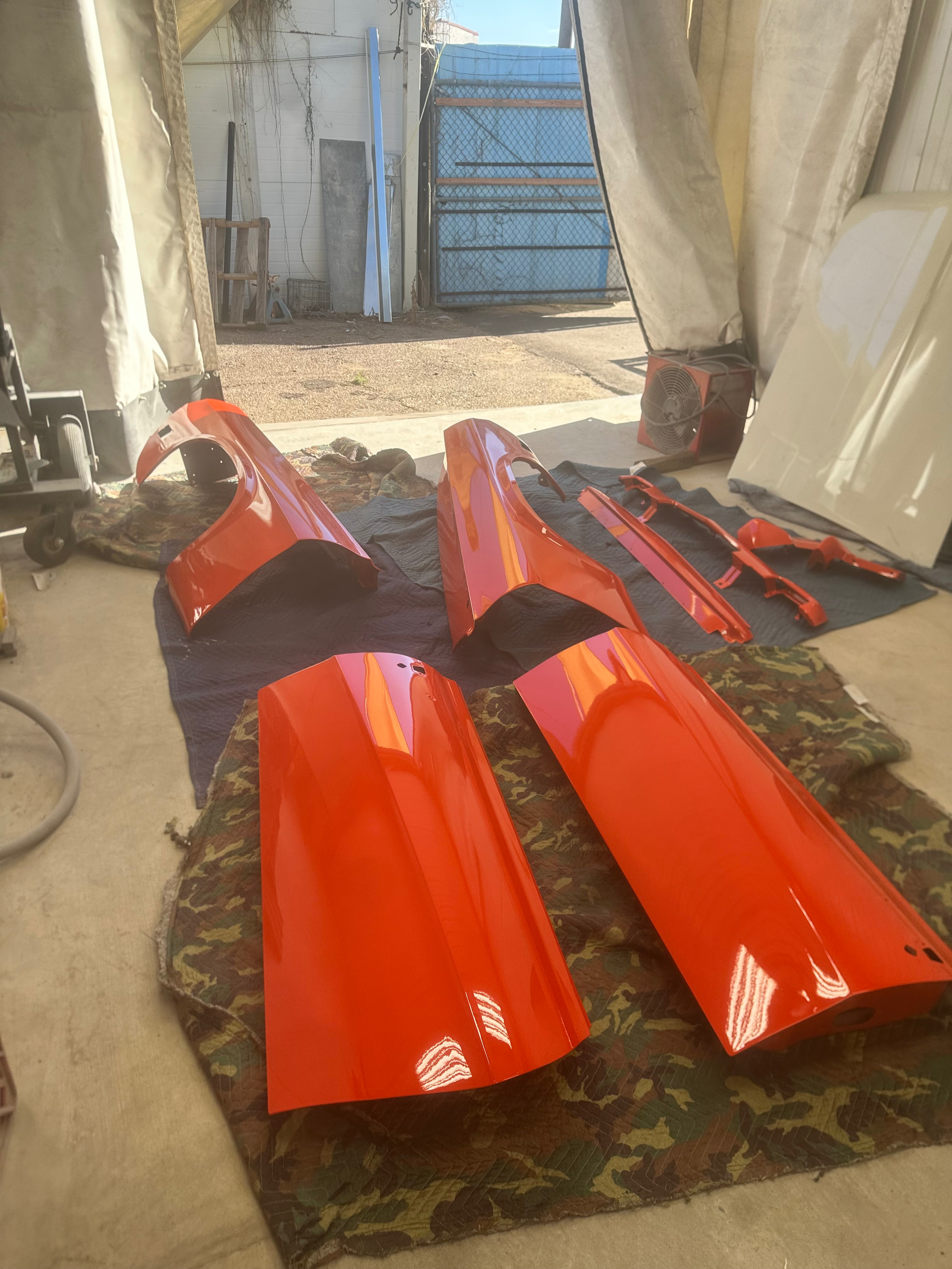

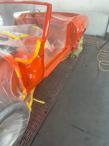

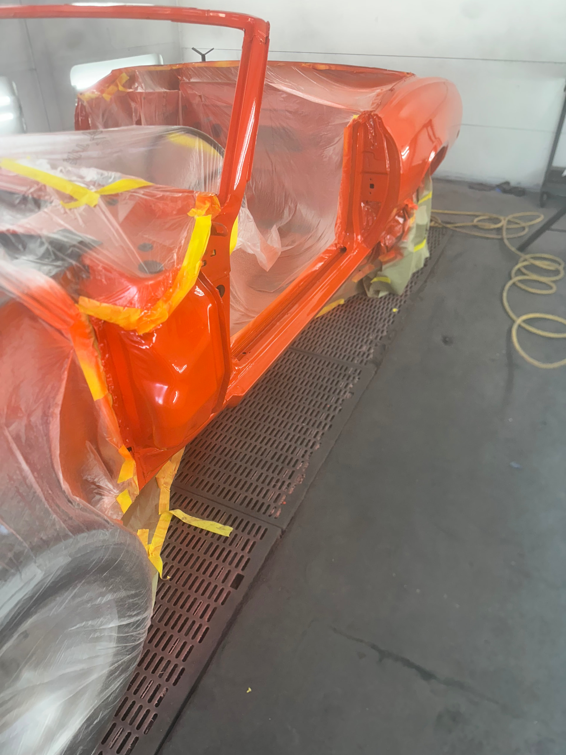

The painting of Phoenix has now officially begun.
Are you doing it yourself?
I’ve done the lions share of the work with the help from my brother (body man) so far with the exception of paint.
Beautiful color!

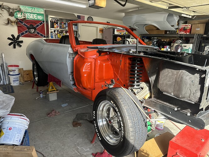

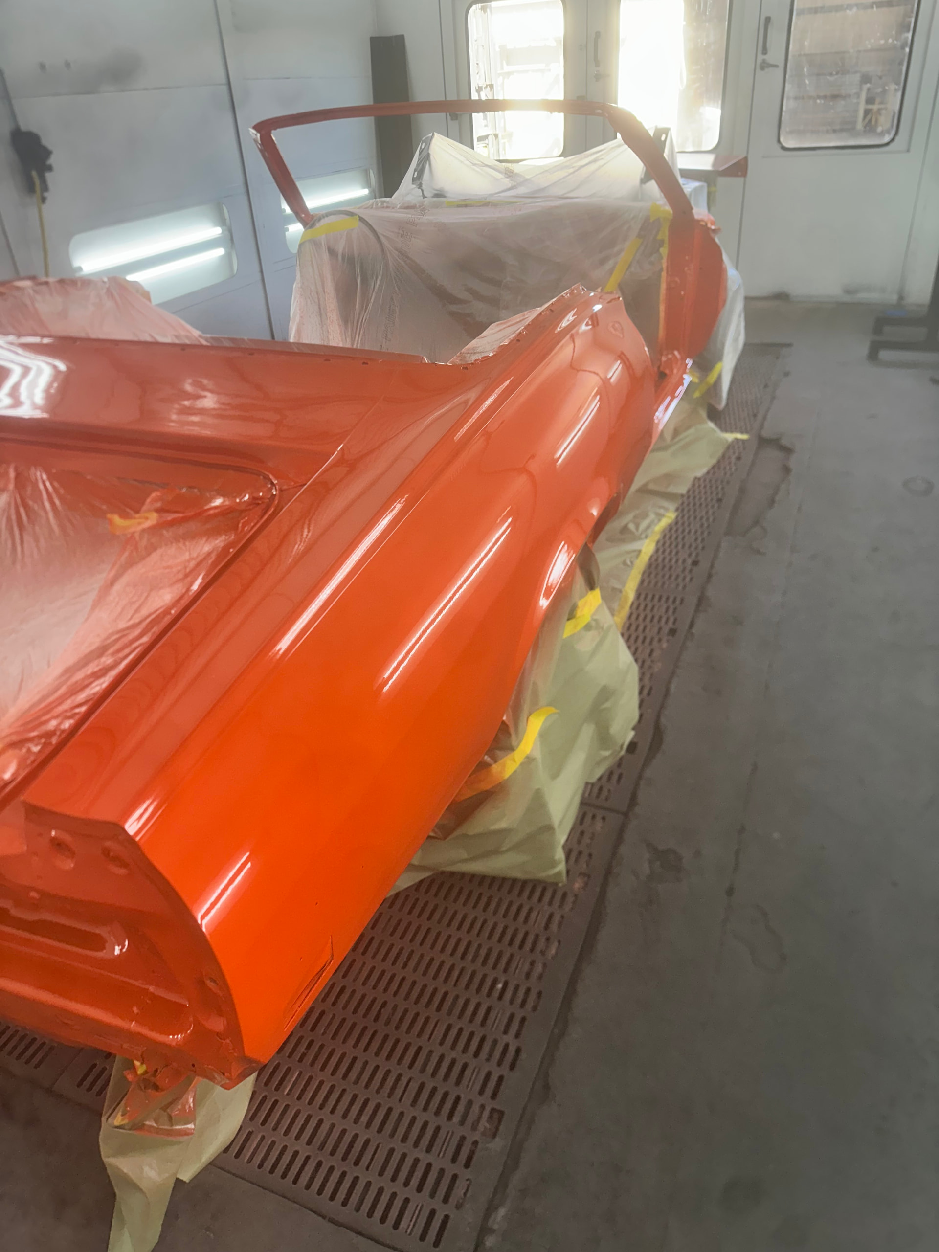

More progress pics!
Looks great :+1:
This is exciting. I bet you’ll be happy to have this part done.

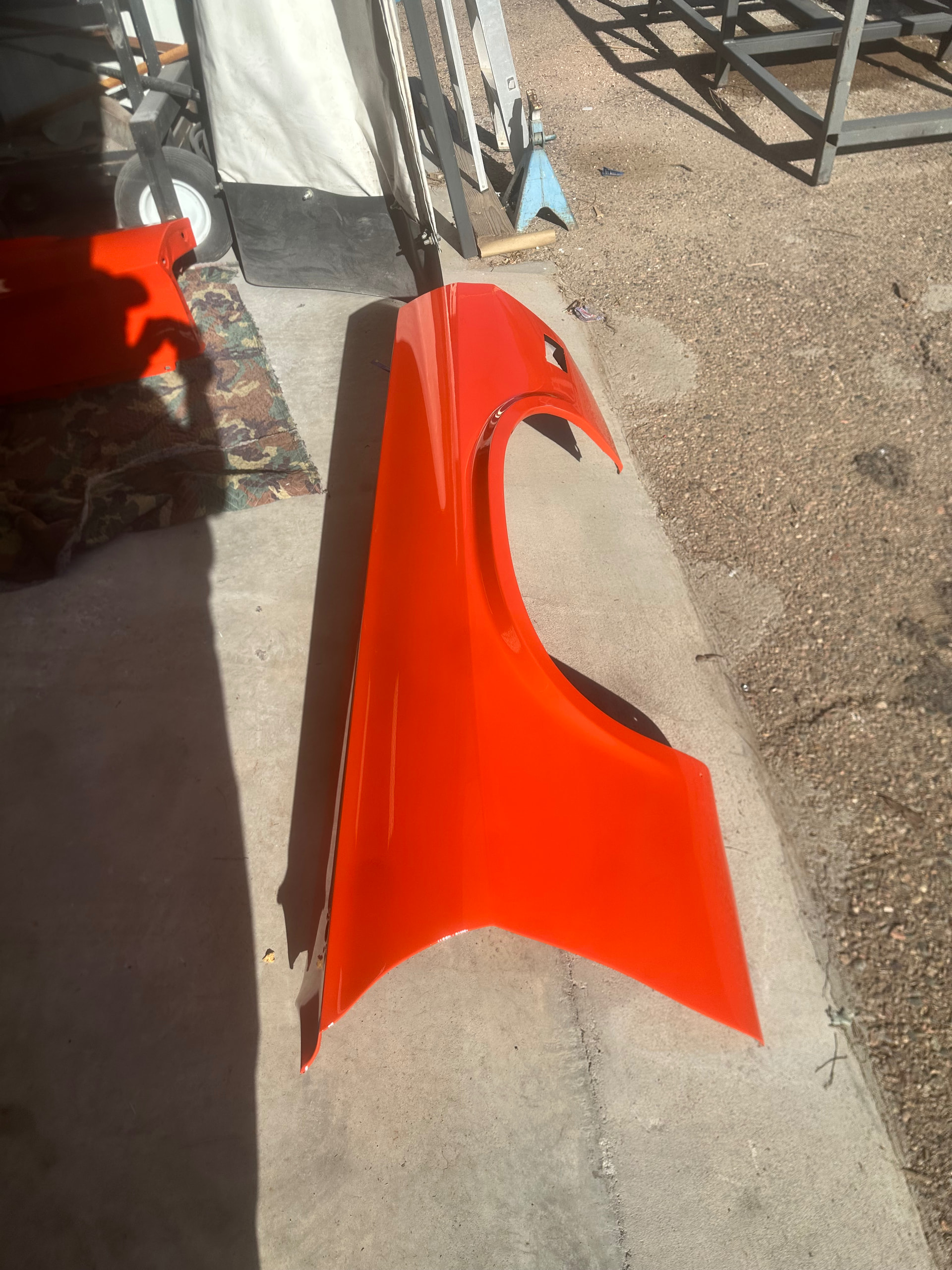

It’s been a long, sometimes bumpy road to get to this point. Progress is continuing.
It will be alot more fun once you start bolting parts back together - at least it would be for me! Looking really good though!
