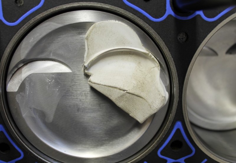

It also looks like I’m going to have to have my pistons notched when I go this route.

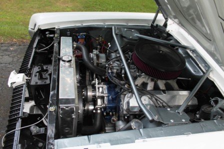

Since you mentioned the stock intake, are the intakes that are usually recommended with those heads (ie much higher) able to fit in a 69 Cougar with typical size carb and air cleaner without a hood scoop? Ie can they usually clear the hood?

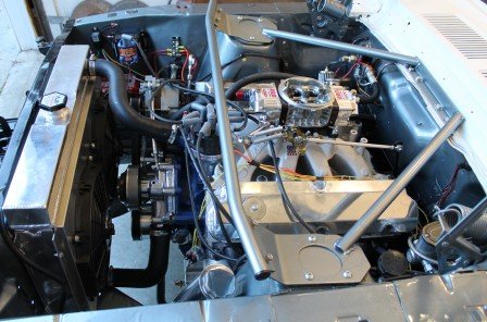

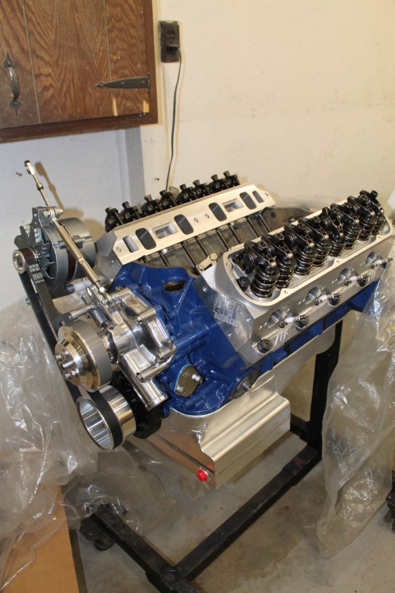

I have the AFR 205 heads on a 351w stroked to 408 in a 67 Cougar. With the Edelbrock Victor Intake manifold the hood clearance is very tight. I had to check dimensions on a air cleaner and do some modifications in order for it to clear the hood. I also have adjustable motor mount and they’re set as far down and back as I can go. I running the FPA neck down headers which fit great and a very nice header, but pricey. My pistons were already cut but still had clearance issues on the exhaust. I had get them fly cut deeper for clearance, but I’m also running a very high lift cam that you wouldn’t want to use on the street.
I’m running AFR outlaw heads with the wider bolt pattern so I could use 2" primary headers…I’ve run a lot of different heads over the past thirty five years, but these are really impressive. Highly recommend AFR heads.
