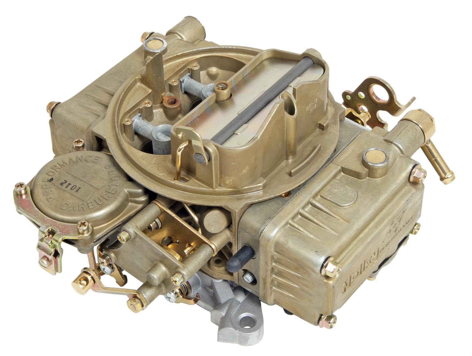

Can’t adjust the float lvl think, i have part number 0-1850C
Which says Holley 4160 Non-Adjustable Float Carburetors (When I bought it a few years ago, since then they made them adjustable it seems).
Summit and amazon still show the one I have
Really? No brass sight screws on the passenger side of the float bowls?
The screws with locking nuts on the top of the float bowls adjust the needle and seat assembly and the floats’ level.
Yes, in your picture, but here is a picture of my carb, as you can see, no adjustable floats as per the description when I bought it.
Many apologies! Just never knew of such a 1850.
Holley does offer some dry float setting info here - that is, bowls off. I surmise for your carburetor you’d gently bend the float tabs as with Autolites.

I don’t have a rear metering plate, this is a very basic holley, without any fancy options :slight_smile:

Yes, you do have a metering plate in the rear. You don’t have a metering block (in Holley definitions). Metering plates come with a number of Holleys to hold costs down. Metering plates capture the function of both jets and metering block passages; you can convert, if bored, to metering blocks with Holley kit 34-6 (and don’t forget to buy some jets).
