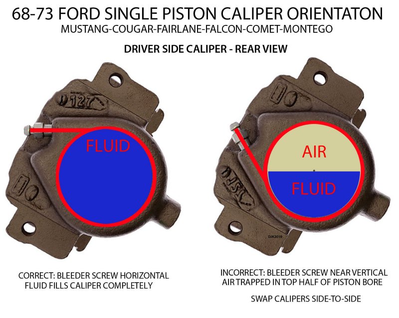

Picture I found of the issue.
Ed Zackery.
Been there done that, kinda like reverse polish notation, doesn’t look right, but it is…
Your gonna make us look aren’t you! Lol
Yup, I just crawled under mine to confirm I got the calipers on right last summer.
I haven’t had a chance to but I guess I’ll taking my tires off and checking that the long brake shoes are on the emergency brake side.
