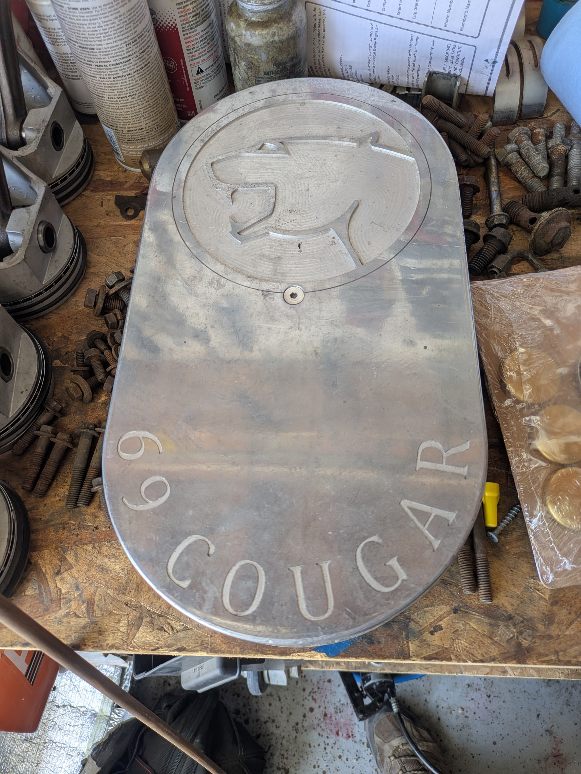

Thanks for all the advice and suggestions. I’m thinking that my approach will be a mixture of both camps. I will keep it as original as cost permits while adding upgrades when they don’t take away from the heritage. For example, this engine came with an MDX distributor and module. Would it make sense to go back to a points and condenser ignition. If this was an Eliminator maybe, but it will never be that or I’ll never try and make this into a Eliminator. On a sad note, the PO cut a hole in the hood for the ovel air cleaner clearance. So finding a good or hood scoop is another decision. This could get expensive.
Custom
That is COOL!!!
Do you mean MSD ignition? MSD is quality stuff, as long as it is appropriate stuff for your application. No matter how good of quality the distributor is, if it doesn’t have vacuum advance, it isn’t right fora street driven car. Or you can lock it in place and find a way to control timing electronically. I personally like the points distributor with a Pertronix 1. Looks right and works great.
