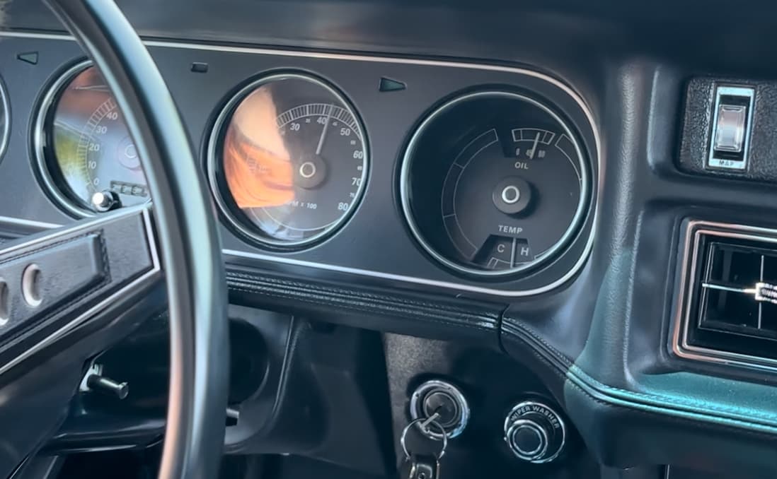

I’ve got two to do. Xr-7 to Eliminator. Trouble is, the Eliminators didn’t have a clock to my knowledge. Other than that, the sheet metal on the left side should be the same. I want to keep the clock in my cases and the xr-7 gauges…but who knows how others would want to proceed. This is what happens when you dye woodgrain black. I also stripped the paint off the rings, steel wool polished the steel and matte cleared them
Eliminator did have the clock. What else needs to be black pebble?
