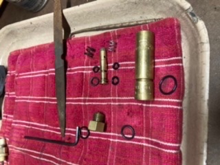

Did you tear the warning/dist block apart and check/clean it? Try clamping all the brake hoses to cut off flow and see anything changes.

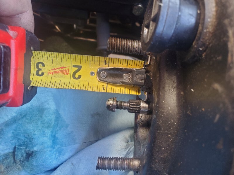

I am showing .980 to .995 so a hair under an inch.
If it extends too far out, then the piston can’t return enough to let the fluid reenter the reservoir. Too far in then you never move enough volume of fluid to generate enough pressure.
Tiny adjustments are enough to make a difference. Could you measure it and see what you have now?
Measuring from the mounting surface of the master cylinder correct? I haven’t adjusted it yet and it looks to be 1", perhaps a tad over.

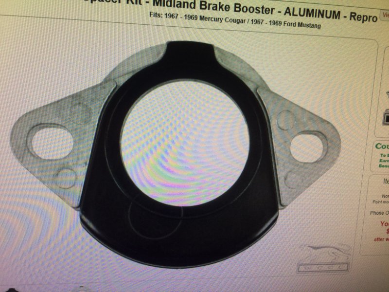

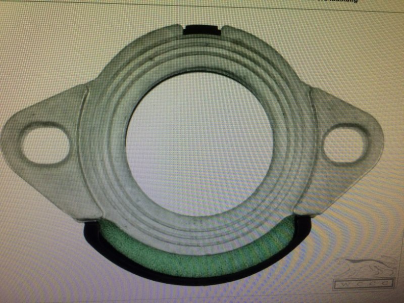

Does that booster use the plastic spacer with the filter in it? Which booster is that? Midland Ross or Bendix?

My booster I had before did, I sent that one to WCCC and they sent me this one. I can’t remember if they sent the spacer back with this one or not, but I haven’t had the spacer on this one since I’ve used it. Its the bendix, the person I talked to recommended me that one, although it does say it’s the one for 67-69, not sure how different they are. I remember them going over the teardrop and straight rod into the booster.

Spacer from a 67.
Stoke front disc brakes also have a proportioning valve connected to the switch block. Mine was leaking so I rebuilt it as a part of my brake job. Besides leaking, I’m not sure what symptoms a bad proportioning valve would cause. Do you have one?

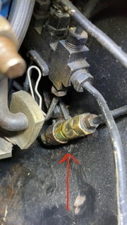

I don’t have that proportioning valve but I believe I have the 70 distribution block so it should be inside there. I also have a separate adjustable proportioning valve after the dist block, which I’ve tried at many different positions and not had any luck with tightening up the brakes.
Edit: After looking at the dist block on WCCC I might not have that one either, or if I do I may have found my issue, if thats the case my lines are hooked up incorrectly. I hooked it up the same as it was when I got the car, and they worked then, but I’ll have to check.
Just checked and I have the 67 distribution block, hence the aftermarket adjustable proportioning valve for the rear brakes.
