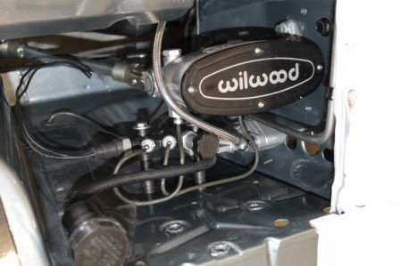

Here is a picture of my install. Yes, I had to do it twice to get it right. Actually three times if you count this weekend when I discovered that the hood hinge was going to hit the clutch reservoir.
Jealous, you have so much more room without a booster…LOL.
Perfect! Is that the master from the HydraMax / American Powertrain?
That’s the one I’m attempting with my t56 install.
