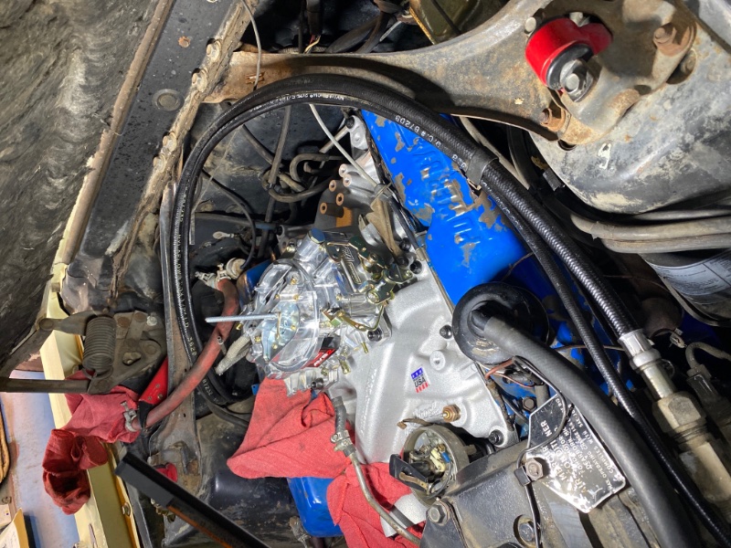

Hello everyone,
I have a 69 XR7 with the 351W 2V. I’m swapping out to a performer intake manifold and carburetor over to an edelbrock avs 2. I have the transmission kickdown bracket but I can’t seem to get the throttle cable bracket just right. I’m a little intimidated trying to build brackets so I thought I would see if anyone else has done anything like this.

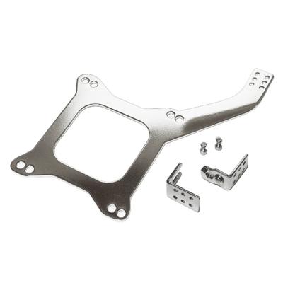

This is one that I know works; Summit Racing SUM-G1419 Summit Racing™ Carburetor Linkage Plates | Summit Racing

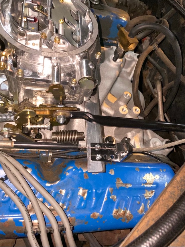

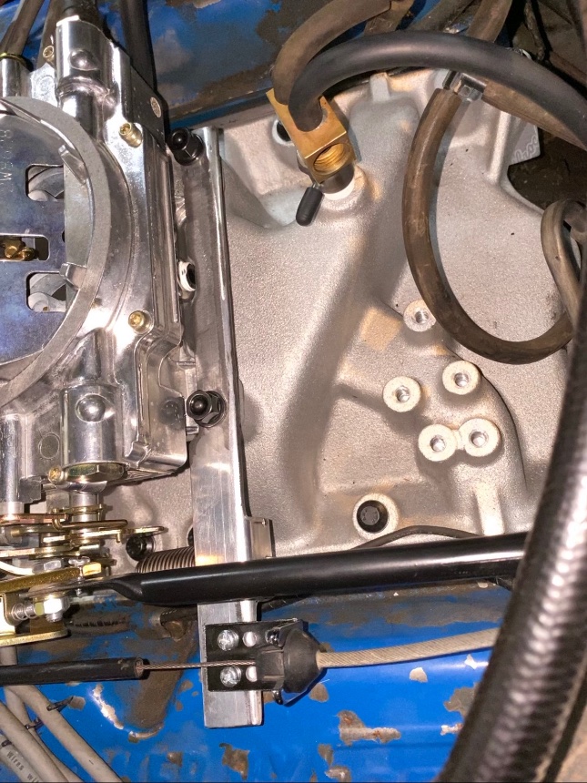

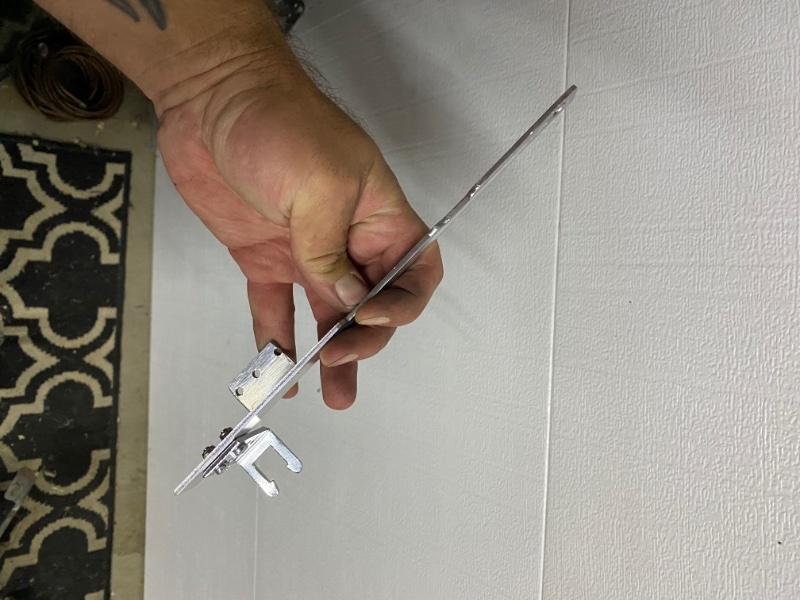

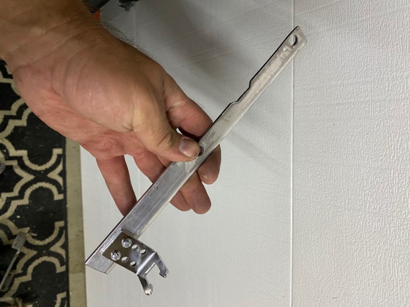

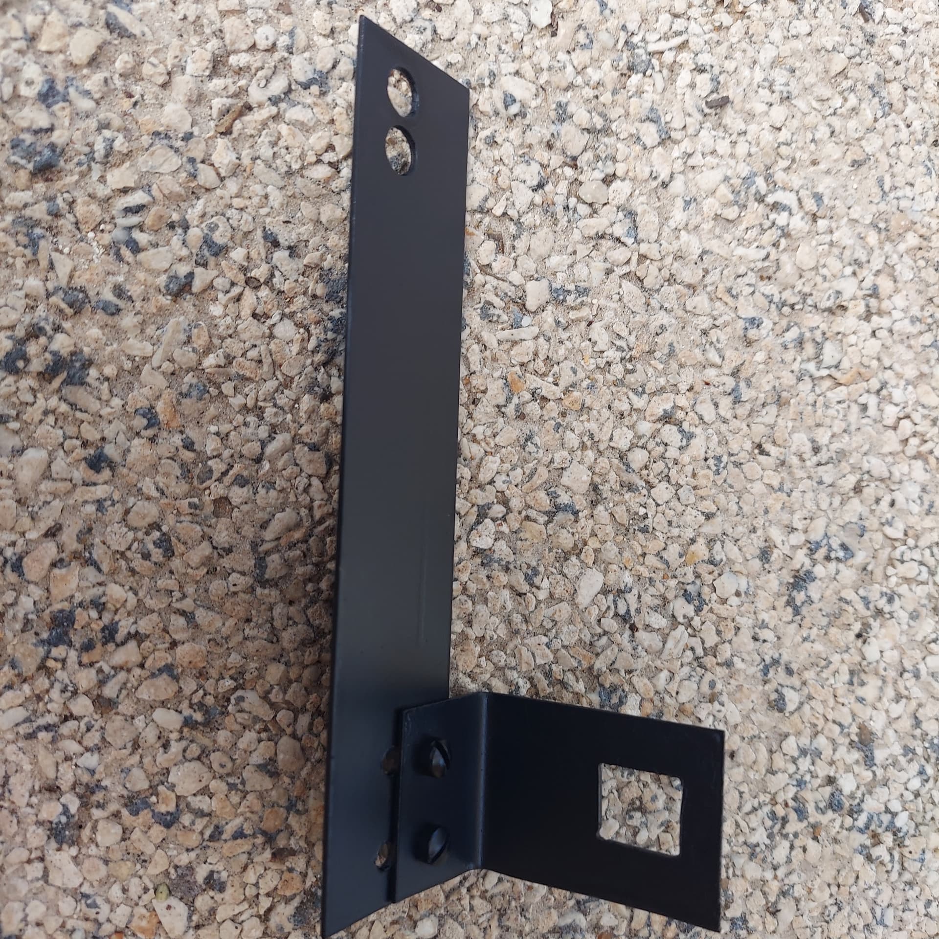

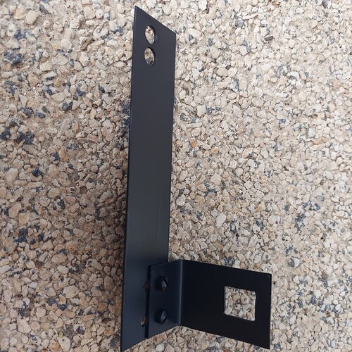

Well I purchased that bracket from summit and my throttle still wasn’t lining up just right. So I ended up getting a piece of angle iron and fabricating a bracket myself.
I used the cable clip from the bracket so it wasn’t a complete waste! I think it will work great.

The gift that keeps on giving: 5 year old post and it hits exactly what I’m up against; thanks Etheros for contributing to my cogitations, The only difference in mine is I made the cable bracket as well, and the support piece doesn’t bridge the whole carb. I have dual bolt patterns on my carb base so I used the hold down stud and dropped a pin in the unused hole to prevent the bar from pivoting.
