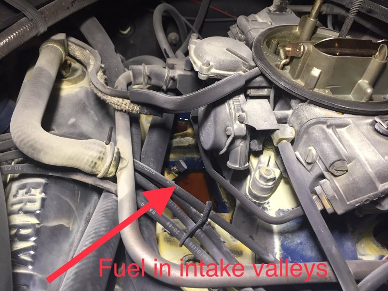

The intake valleys were sitting full of fuel. I think when I went to start it the coil spark ignited the fuel in these valleys on a hot engine.

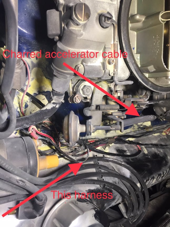

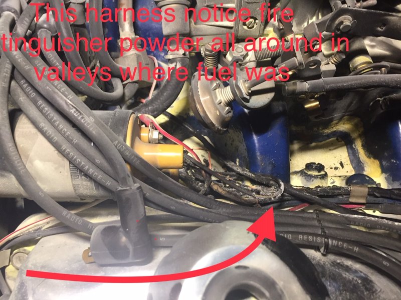

Here are some up close pics of the aftermath. Maybe it will help y’all help me with the repair process. Please let me know how bad it looks and what I’m in for and what my next steps should be. Which harness or harnesses do I need to fix it? Doesn’t look exactly like the one posted above. Several different wires there. Thanks in advance.
As Steve stated in post # 5 that is the guage feed harness for the coil, oil pressure sender and water temperature sender. It connects at the back of the block and is relatively easy to replace.
Where a mask when you clean up the powder, you do not want to breath in too much of that.

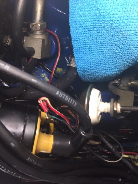

It also looks like the ignition coil ( plug ) wire from the coil to the top of the distributor is gone ? The outline of the boot on the yellow top of the coil is clearly visible - was it removed after the fire ? Also looks like the remains of the wire ( the outer rubber-plastic covering is gone ) are just below the coil ? Other things to look into :
(1) how are the rest of the spark plug wires ( especially those on the LHS near the fire ) ?
(2) any plastic components ( clips, etc ) on the carburetor
(3) carburetor gaskets or spacers
(4) the anti-stall dashpot looks affected ( maybe just the powder residue )
(5) the bottom of the ignition coil may have been affected ( paint or the yellow plastic on the underside )
(6) the distributor ( cap and the rubber gasket on the shaft, where it runs through the intake )
All of this is not insurmountable - you are very lucky, as other writers have said, it could have been a LOT worse.
As to an insurance claim, all depends on your deductible. Also Insurance Companies are strange ( actually it’s the wording in the policy details ) when it comes to the components damaged by a fire and the actual source of the fire. Best of Luck.
I disconnected the coil wire after the fire. You can see it lying on top of the valve cover. Spark plug wires look fine but I haven’t started cleaning yet. Only plastic part I saw directly affected was the plug wire holder on the passenger side you can see it in the second pic. Yes the coating burned off that’s what was smelling but all the wires look to still be in tact. Believe it’s powder residue on the bottom of the dashpot I was able to wipe some off. I’ll check further as I clean. The carburetor I’m pretty sure is the root cause. I’ll have to take all that stuff off to properly repaint the intake. I’ll rebuild the carb at the same time. It also charred the underside of the air cleaner base. I’ll have to strip and refinish. Hopefully won’t have to involve insurance. As long as the engine itself is ok I should be good to clean, replace, rebuild and refinish. Wish me luck.

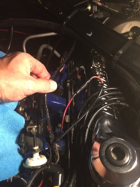

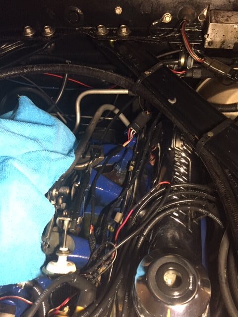

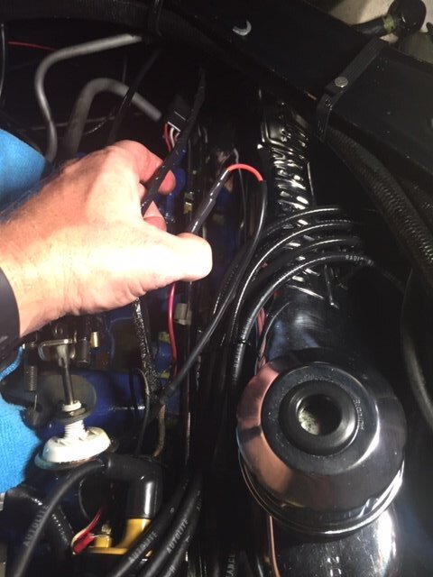

We identified the one wiring harness that I need for the gauge feed but what are the other wires? The red wire I’m holding in the photo looks like a wire for a pertronix. What is the other harness that seems to have tape around it and goes inside the car? Dashpot cleaned up nicely. Think the rest of it will too. Think it needed a good cleaning and detailing under the hood anyway despite the fire mishap. I used simple green (pH around 9) and just sprayed everything down and I’ll let it dry out then I’ll wipe it up when I get a free moment. Hopefully that will neutralize any corrosive effect the ammonium phosphate may have. I’ll use electronics cleaner on any electrical contacts that may have been affected.
So I finally got everything cleaned up I think and hope. I’ve got a new gauge feed harness on the way. The other harness has to do with the pertronix and looks like some kind of 3 wire electric choke feed combination of some type. I think I managed to salvage that one and got the gauge feed wiring bandaged up until the new one shows up.
