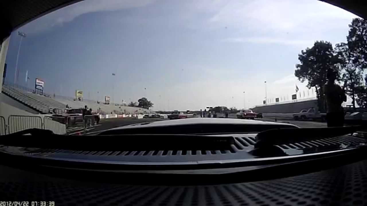

Thanks Allen. Here, let me take you for a 12.9 second ET @ 110 MPH 1/4 mile ride!:
Sorry but I had to comment and add a video. This is my other “cat” – a Jaguar. Heh heh. 12.3 @ 117.6 with full AC and leather. Comments on the C vs W build follow
https://www.youtube.com/watch?v=eqBdKGmXiW8

A great way to start the day watching a Cougar go down the 1/4 from the drivers seat. The only drawback to the 351C is the weight compared to the 351W, but those alum heads help.
