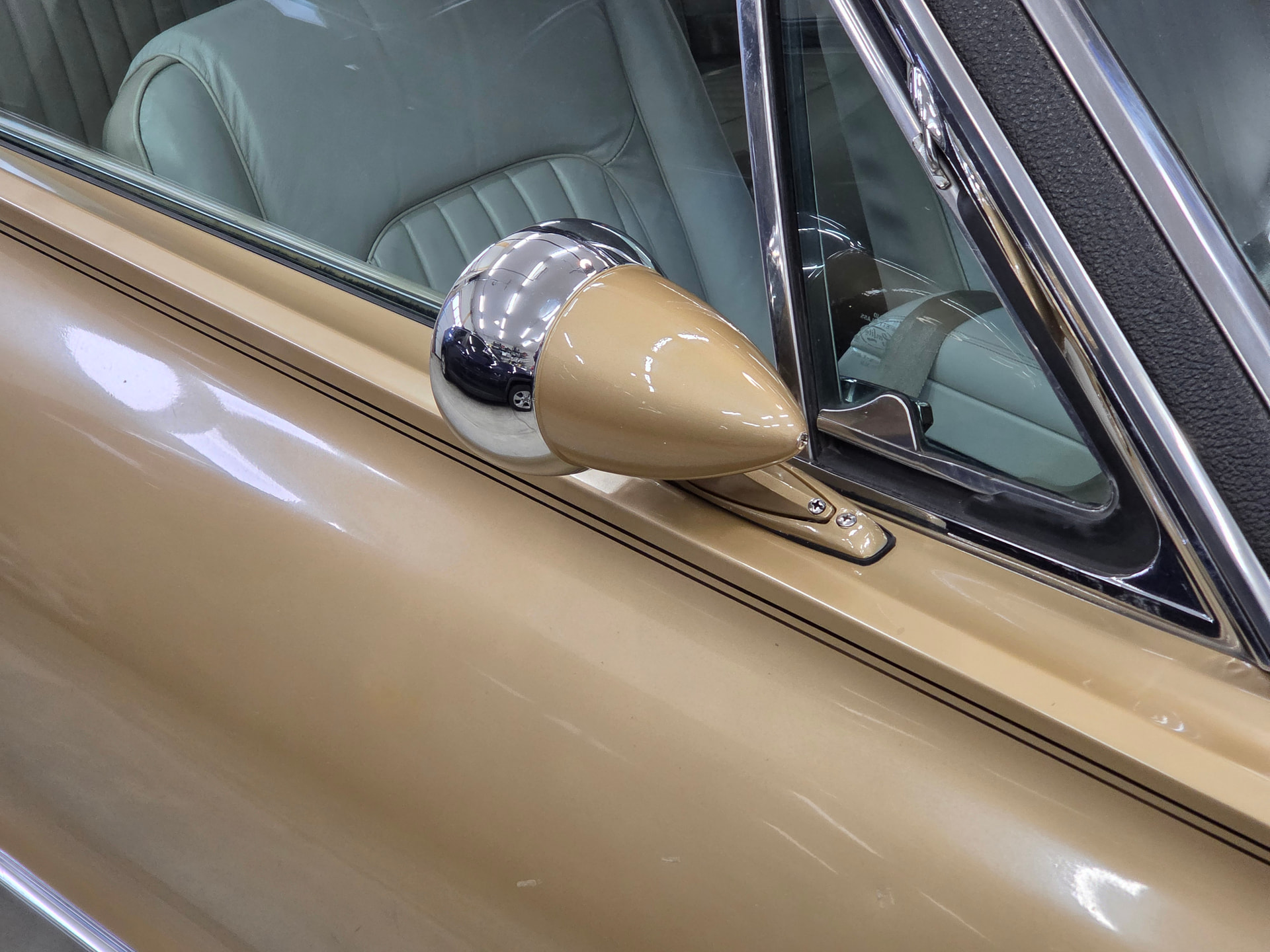

Went ahead and painted and installed the passenger side mirror after procuring a base from the gentleman (Stanton) that cast them in WI and mirror from Fusick Automotive earlier this year. It looks more balanced with mirrors on both sides. Although the mirror does help in visibility, I’m going to look for a 4” convex mirror to expand the view.
The premixed paint from Automotive Touchup was a good match to the existing color, and used the Eastwood 2K clear.
