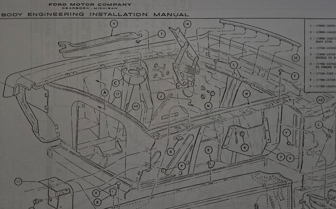

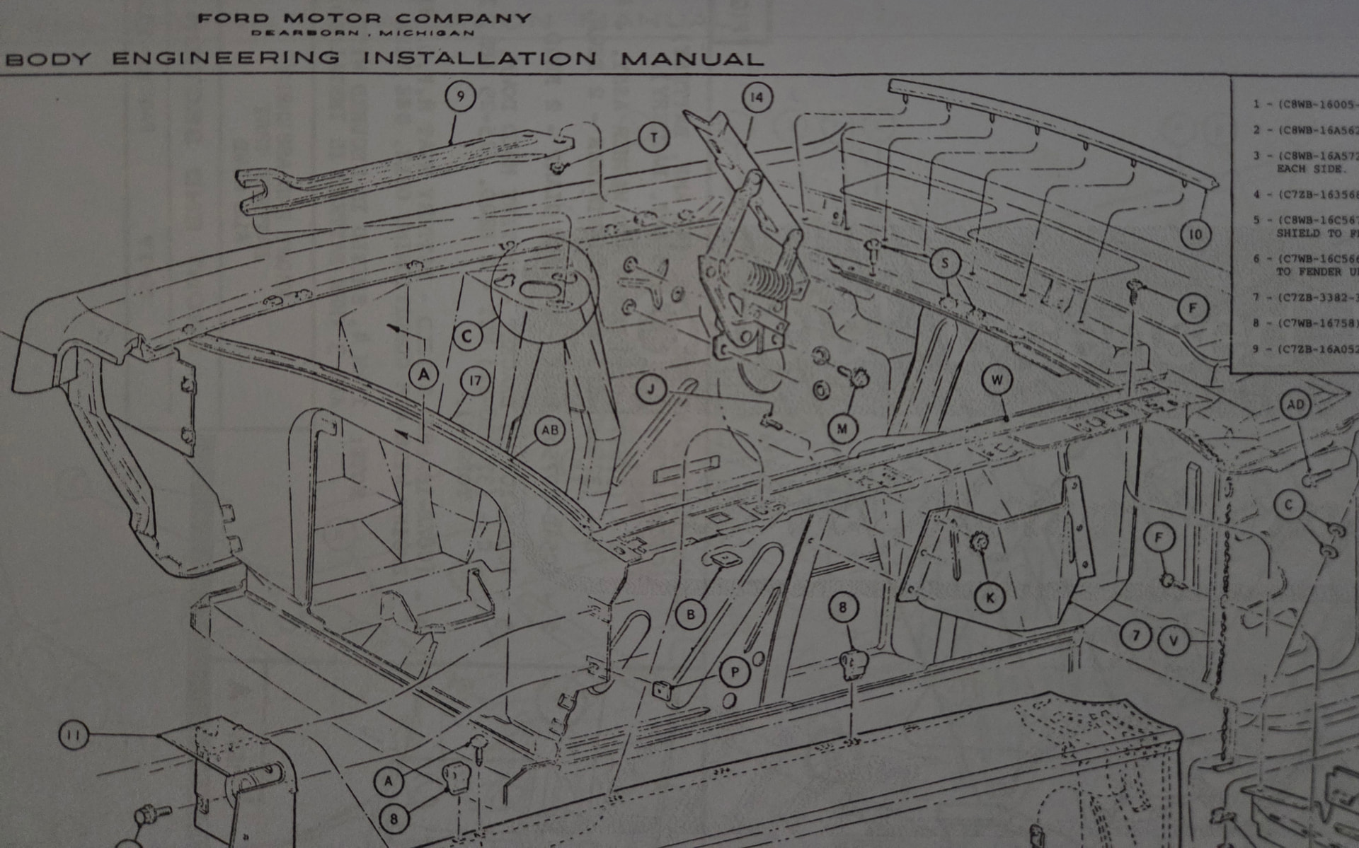

Thanks for input on brace…I reinstalled in same position after changing the plugs…didn’t think about it. In looking at the assembly manual, it does show the brace under the cowl, so I’ll swap it around.
My only concern is the taller Shelby valve covers raise the PCV valve / brass elbow, and almost makes contact with the brace. If I put the brace in the correct location under the cowl, the brass elbow may contact the brace. I’ll try and see.
