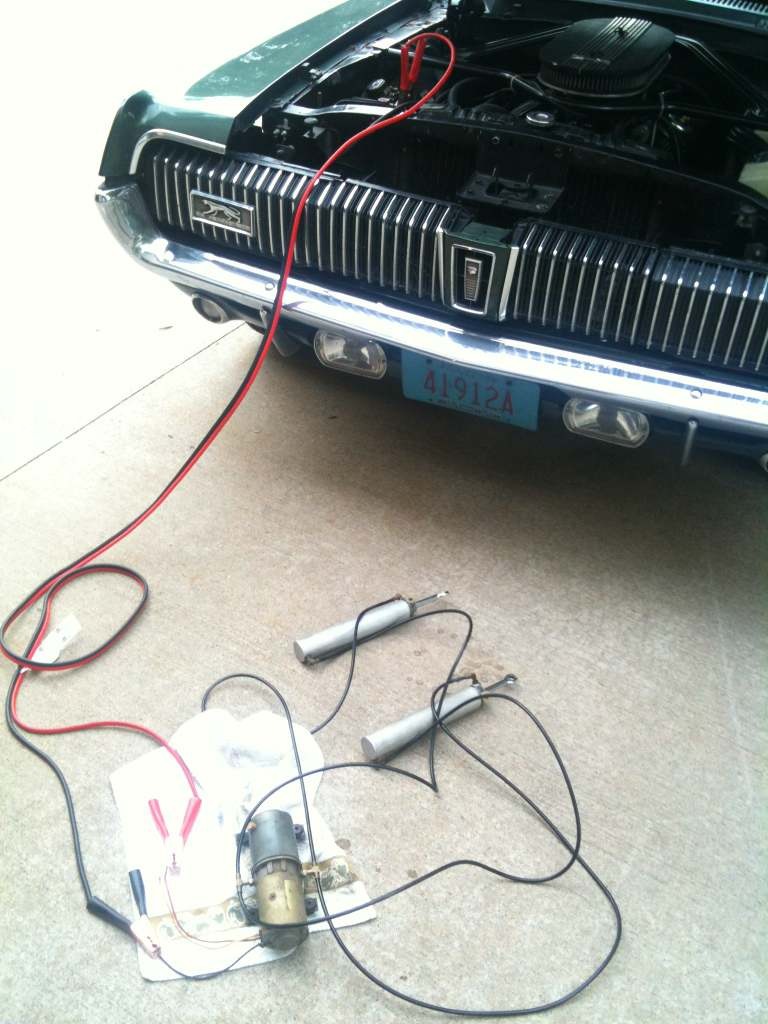

Thanks to Rob, the final bits have come together. For better or worse, I assembled everything outside the car for a test and am happy to report everything works- with no leaks!
Jody,
That’s great, the pump and cylinder can run into some pretty serious money! Now what sort of lines are those? Lines are expensive too! Can’t say that I have ever seen black ones.
The lines are from a set of FOX Mustang cylinders I had bought for $25 way back when I started this project. The fittings are identical to the older style and the only issue with them might be whether or not they are long enough. I’ll find out next week when I install everything.

Success! Copycatvert’s top now moves under its own power. I haven’t installed any wiring yet (it’s currently operated by jumper cables LOL) but it’s getting there. Question for you convertible guys: did the factory systems have some sort of overlimit switch to kill power to the pump when the top gets fully up/down?
No.
Congrats, Jody! Awesome that you are modding, AND driving, at the same time!
The factory switch required you to hold it down until the top was fully in position (up or down) and the motor kind of bogged down. Then you release the switch and the motor stops trying to move the top.
And if you hold the button after it reaches that point, for example when trying to close a new top that is a little too tight, with original, age-brittled hydraulic hoses, you will need a couple rolls of paper towels to clean up the ATF. Don’t ask.
