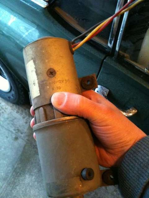

Look what the car fairies dropped off. I came out to my car this afternoon and found this on the driver seat!
Wonder if it works. Anyone know how to test it?
Is this a convertible top motor? According to the color of the wires, I would say yellow and red are power and black is ground. First to find out if black is ground, test to see if there is continuity between the casing and the black wire. I would thing it isn’t isolated. With the black wire always ground the red wire will turn the pump in one direction and then to run the pump in the other direction, yellow and black and red is not used. It would be like a power window motor in this case I would think.
It is indeed a top motor. I had mentioned to several guys in the local club that my top wasn’t powered yet and obviously one of them felt sorry for me. I tried out the wires on the battery- black to ground and touched the others one at a time to the positive post and it spun over. I could tell by the way it jumped that each wire is a different direction. I think I’ll run some lines now into a bucket of fluid and see if it pumps.
