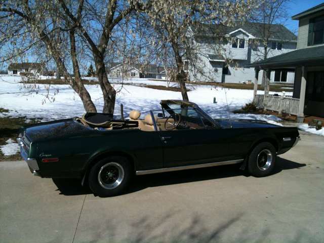

51 degrees, top down and snow tires. That’s how we live here in Wisconsin.

Jody the top down picture with snow on the ground…cool too say the least. Your Cougar looks like would be quite at home in a warm climate as well for top down cruising. Here is a photo my brother sent me from yesterday just before sunset. He said it was nice spring time weather in Miami, perfect cruising weather.

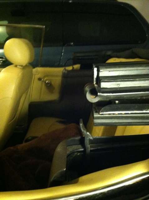

Not to detract from the current lofty thinking of the thread but Jody, I have been meaning to ask, what is limiting the retraction of your top frame? It seems to sit kind of high in the down position (and would make boot construction we spoke about a bit more challenging). Is it the interior quarter panels? Did you beat down the tops of the inner fender wells (like factory on 69/70)? Just wondering, would like to see the top frame tuck down more.
Bill P., did your top frame tuck in well, i.e., like on 69/70?

Bob: I did pound down the wheel houses like they were on my donor car (or at least as close a match as is possible with a BFH). Everything seems to line up correctly with the top frame and glass so so my guess is that the quarter panels on the later convertibles (69 up Mustangs and Cougars) must be a bit taller than on the earlier cars, providing a deeper well for the top frame.
Well, thanks Bob. I remembered that I had a set of the little clamps that hold down the top. The holes for these clamps are pre-drilled into the mount so it occurred to me that by installing them, I could see if the top is going down as far as it should. The holes on the clamps are slotted to allow up and down adjustment. So I dug them out and installed them. As you can see in the picture, with the clamps as high as they go and the top pressed as far down as it will comfortably go, there is still about an inch gap on the driver side. The passenger side is slightly better at 3/4 inch and I can push that side down and latch it, but it’s obviously too tight.
So you are right, the top isn’t fully retracting, but not by much. The question is whether or not I can live with this?
By messing around with how the top folds as it goes down I managed to eek out an additional 3/4 inch of drop-- enough to have the latches grab when its down. The photo doesn’t show it, but the top header is now about 1/4 inch lower than the edge of the trunk behind the rear seat. I think that’s as far down as it’s going to go.
That looks much better to me Jody! Now what are these latches that grab when the top is down? The only latches I can think of are the hook thingies that grab the windshield header and I don’t think they do anything (or could) when the top is in the down position. So, I’m baffled. Enlighten an old fart, would 'ya? ![]()
They were only used on non- power top cars.
