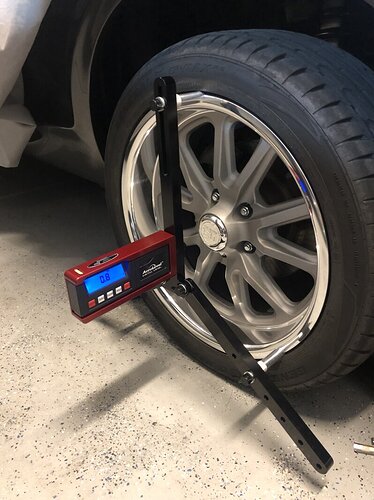

Well life has thrown a lot at us recently but I have gotten some more miles on the car. I’ve run her through all gears and I’m pleased with how the clutch, AL flywheel, trans and rear gears seem to be working. While I had some concerns on driveability with the AL flywheel I have seen no issues at all-slow speed, starting on a hill, friction point location-VERY happy I went this direction. I like the final drive I chose 3.70:1 so far though I haven’t yet done a freeway trip. Four wheel Wilwood discs work well too. I’ll get her back on the lift this week to do tweaks to the steering, figure out the speedo/odo issue, then diagnose lack of turn signals. My alignment kit from Summit arrives tomorrow so I need to get my turnplates cleaned up and lubricated. I figure I’d teach myself how to do my own alignments as I’ve done almost everything else on this thing so far.

What are you planning on using for alignments? I have the longacre setup and it works pretty good, I do want to get some turn plates to make things easier. I would say the hardest part of doing your own alignment is being able to get under the car enough to make adjustments since you doing it on the ground especially if its been lowered. Having a way to measure toe by yourself would be nice too.
I have the SPC Fastrax and was able to do toe and camber fairly easily. I could not for the life of me get caster dialed in though, I think for that you really need to have turn plates and a brake pedal depressor. It’s also not easy to adjust the strut rod nuts with the car on the ground, hard to find enough room for the wrenches.
I have been using folded contractor grade 40gal trash bags. They allow enough slip to do a caster sweep and make adjustments. I moved the strut rods too. Ideally turn plates are much easier and better to use but trash bags got it done.
I still need to install blocks instead of the cams too. I keep having those cams loosen up on mine.

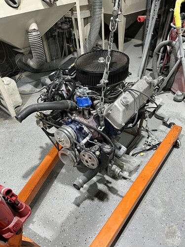

The car is in the garage on the lift for the winter and I’m working through fluid changes on engine, trans and rear end plus general underbody clean up. I purchased a new to me 393” Cleveland with a bunch of performance bits with records and dyno proven performance between the holidays. Iron Aussie ported heads, custom hydraulic roller cam, Scat stroker crank and I beam rods, forged Diamond pistons, Edelbrock RPM air gap intake with Holley carb, custom baffled Canton oil pan, plus more. 444HP@5700RPM and 449 lb. ft TQ at 4300RPM with over 400 lb ft from 3000 to 5800 rpm! This was built by Barry Rabotnik of Survival Motorsports, a name you FE guys probably know well. A set of CHI aluminum heads would add another 75-100 HP from what I can determine should I choose to go that way.
My motor was a mild factory rebuild by PO and while it ran well it was pretty tame. So this winter it’s heart transplant time and next spring I’ll have a running and complete 4V Cleveland for sale.
Here was the motor as it sat at Motor City Grind in the Detroit area. It was driven in within a 1970 Mustang owned by Shaun Burgess owner of Street or Track.
Yesterday I started pulling parts off as it was completely dressed minus the starter. I’ll put the carb and fuel pump+lines on the shelf same with the GM PS pump as it is the same as the one on my car now. This winter I’ll work on a full detail and repaint to get ready to stab it in.
I’m not sure what ignition I’ll run long term but I may start with the Crane stuff on this engine now. I’ll bead blast the intake, Blue Thunder valve covers, water pump and pulleys and may powder coat the pulleys black.
