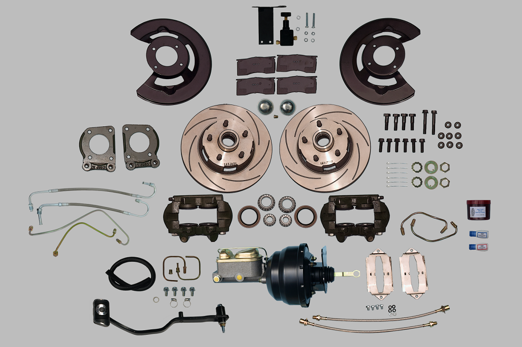

  1. what do you recommend for disc brake conversion (power assisted or not)
    1a. WCCC sells original disc conversion kit, any benefit compared to “modern” aftermarket kits ? what is the most reliable, best performance, easiest to install ? I’m not concerned about keeping it “original” i prefer performance and ease of installation.
    1b. Are the cougar kits exactly the same a the ones for 67 Mustangs ? are there differences to be aware of ?
  2. Can i also ugrade to power disc ?

Probably the best disc brake conversion for the money: http://www.discbrakeswap.com/Mustang%20Disc%20Brake%20Conversion%20Kits%20CATALOG.html

  1. follow the link above & buy kit 1 - the KH style that would have come on your car. Power or manual, your preference (there is room for power, but it adds complexity & cost).
    1a. see above
    1b.same
  2. see above
  3. mustang/cougar = same headers. Figure out the direction re: PS before you select headers. Easiest is 351W style exhaust manifolds for better flow/less hassles. I used Tri Y’s.
  4. the factory made them with PB & PS, so there is room.
Also check out https://www.mustangsteve.com/product-category/power-brake-kits/ He worked with me on my 66 mustang useing the above kit. His booster will allow you to use double master cylinder. Put both systems together, makes for great brakes. Both vendors work with each other.

Looks like the CSRP kit SWAP.1.4PBU.MT comes with the updated pedal ?
Otherwise, not sure if you guys watch this show, but in the Roadkill Garage episode about the Disgustang they cut the auto pedal into manual - looks to be working fine.
Yes, that.
you can buy reproduction pedals which is what is part of that kit. Those would work too.
