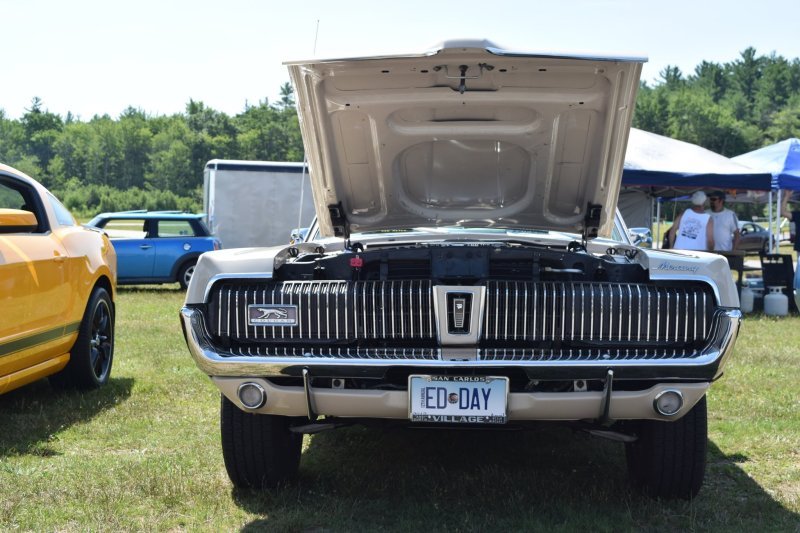

I prefer the look of my uninsulated hood.
Also, I like the looks of this uninsulated hood pictured in another part of the forum…
Not that the the under hood looks bad. Not at all. But the original pads where really pretty cool. Totally molded to fit the contours. Which is the reason they would be so costly to reproduce.

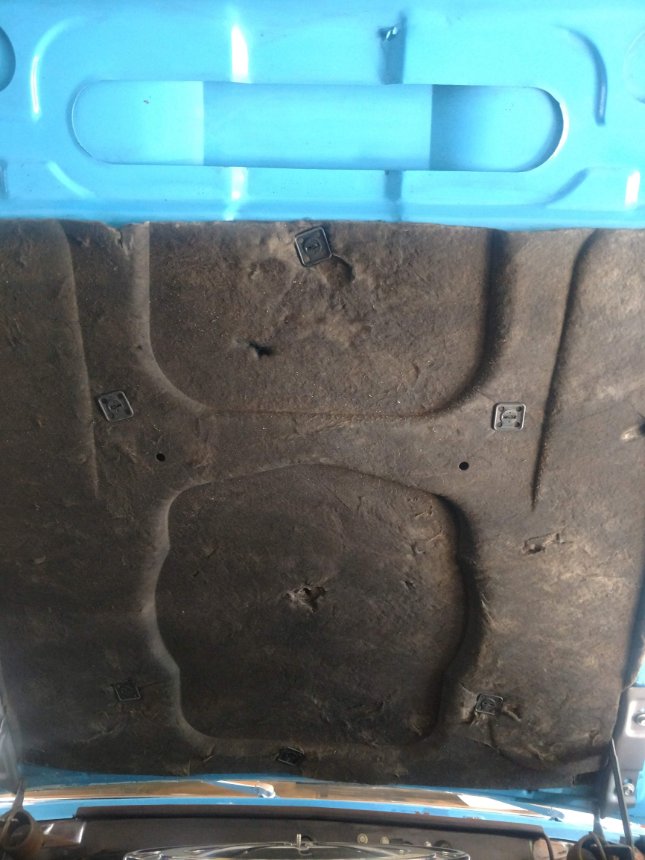

This is the original one on my 1970 Super Drag Pak BOSS 302 for reference.
According to my MEL MPC (4/1973) and my Ford MPC (5/1975) the service part numbers are as follows for both Mustang and Cougar.
67/8 C7ZZ 16740-A 32 15/32" long
69/70 C9ZZ 16740-A 32 29/32" long
71 D1ZZ 16740-A 45 3/8" long
I measured the one below this morning and it is ~35" long leading me to believe that the service part is different than the assembly line part as I do not have older MEL MPC’s to compare. I had previously looked into buying a used one off of a 1970 Mustang that was definitely shorter.

That’s my ‘68 without a hood pad (“Ed Day”), Messenger; it does look good in that pic, but if you’ll recall, the hoods’ undersides had tack-welded reinforcements that weren’t meant to be seen. At 12 inches it doesn’t present as well. Mine had one of the dead-flat aftermarket replacements that had drawn in a mouse - I caught it after a few weeks - so I ashcanned it. So far I haven’t had an urge to replace it, so we agree.
