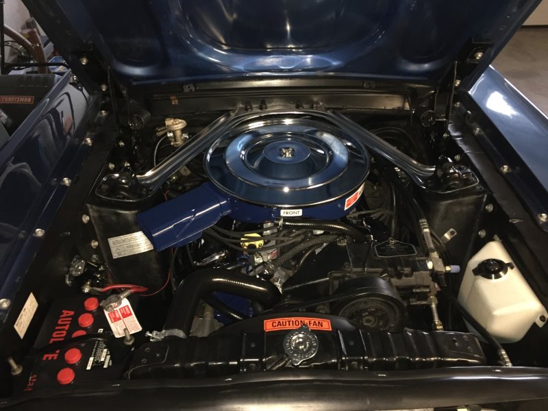

This pic was taken before I added the new battery cables, Master Cylinder, new shocks, etc. Guess I need a newer one. :sunglasses:

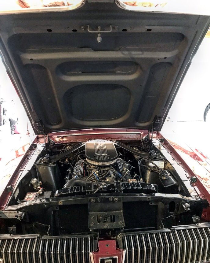

The official name is “Hood Blanket”. The original is molded to the hood and the aftermarket is flat. You don’t want the aftermarket one. Either restore the original or go without one. I like seeing Cougars with their original blanket intact as it’s one of the first items to deteriorate and be missing. Show us a picture of the blanket so we can see what kind of shape it’s in. Then we can guide you how to restore it or toss it if it can’t be saved.

People don’t like the hood blanket because it holds heat in the engine bay. But if you’re doing a concours restoration you need one. From what I’ve seen nice ones are almost impossible to find. I’ve been looking for one myself.
Thank you for your valuable input. I will lay out my old Hood Blanket and take a photo of it today and post it later tonight. I would be interested in finding out if it was repairable or not. I think I can repair my original heat shield so will probably do that as that is the way I was leaning.

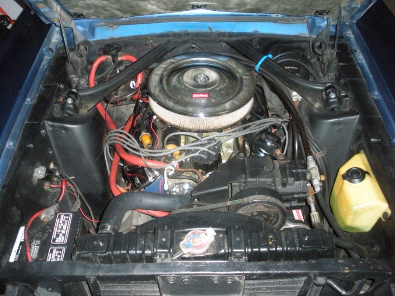

All the suggestions so far were on my list over the years. Every winter I always seem to find more I can do. One thing I did last year was replace the body colored painted fender bolts and removed the black paint from the shock tower and hood latch bolts. So you’re on the right track and what you’ve done looks great. Here’s a pic of my engine bay when I bought my car and one that I took in the spring of this year:

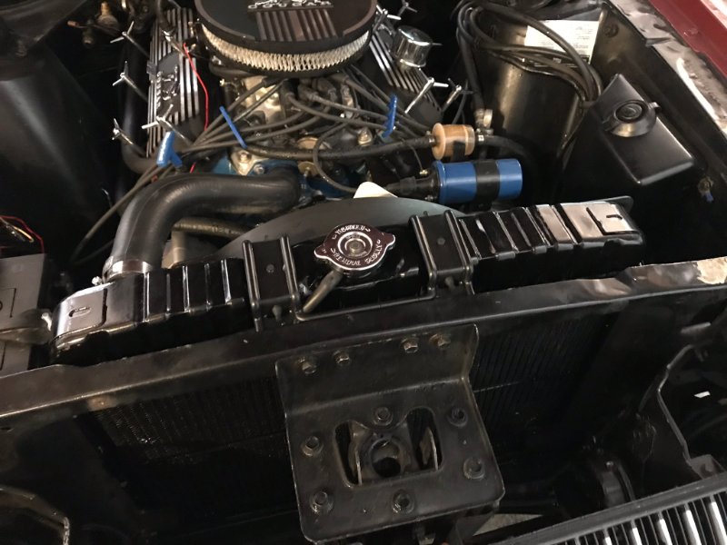

What a great looking engine bay! I totally agree with your color opinion. I am doing black, Ford blue, and natural metal tones. I keep looking at my new red positive battery cable. Is it acceptable to be black too? I know the stock coil should have a yellow top but don’t want yellow in there. Prefer it black for the reason you described. Also, someone said I need the correct cap for the radiator. I think the one on there was the original. How can I confirm that?
Much thanks,
Brian
Definitely not the original. They used a plain screw on cap.
The original radiator cap would be marked AUTOLITE and would not have that flip up lever on it.

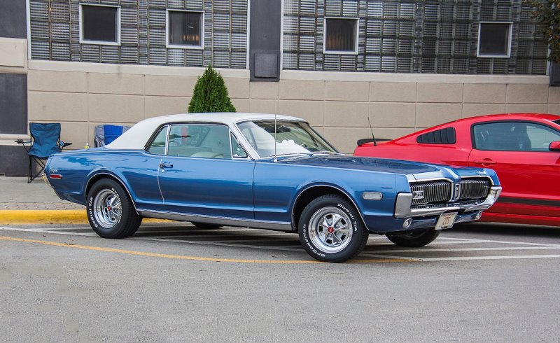

What color is your car? Nordic Blue??
I am thinking of painting mine that color.
Is yours original or repaint?
Thanks ,
Brian
Thanks Randy, I was hoping you’d respond.
I just assumed it was original so one more detail i can add. Are the OE M caps available? I have not checked around for those yet.
Brian
Brian, Yes Nordic Blue, repainted in 1994 by a previous owner who gave me some history on my car. The paint is showing it’s age and has many road chips but that’s OK with me. I put just over 4000 miles on her this year and have been averaging about 3000 since I purchased her in 2011. Maybe sometime down the road I’ll repaint but that first road chip will kill me. She looks great from a little distance but will never win a Best Paint award. :laughing:
