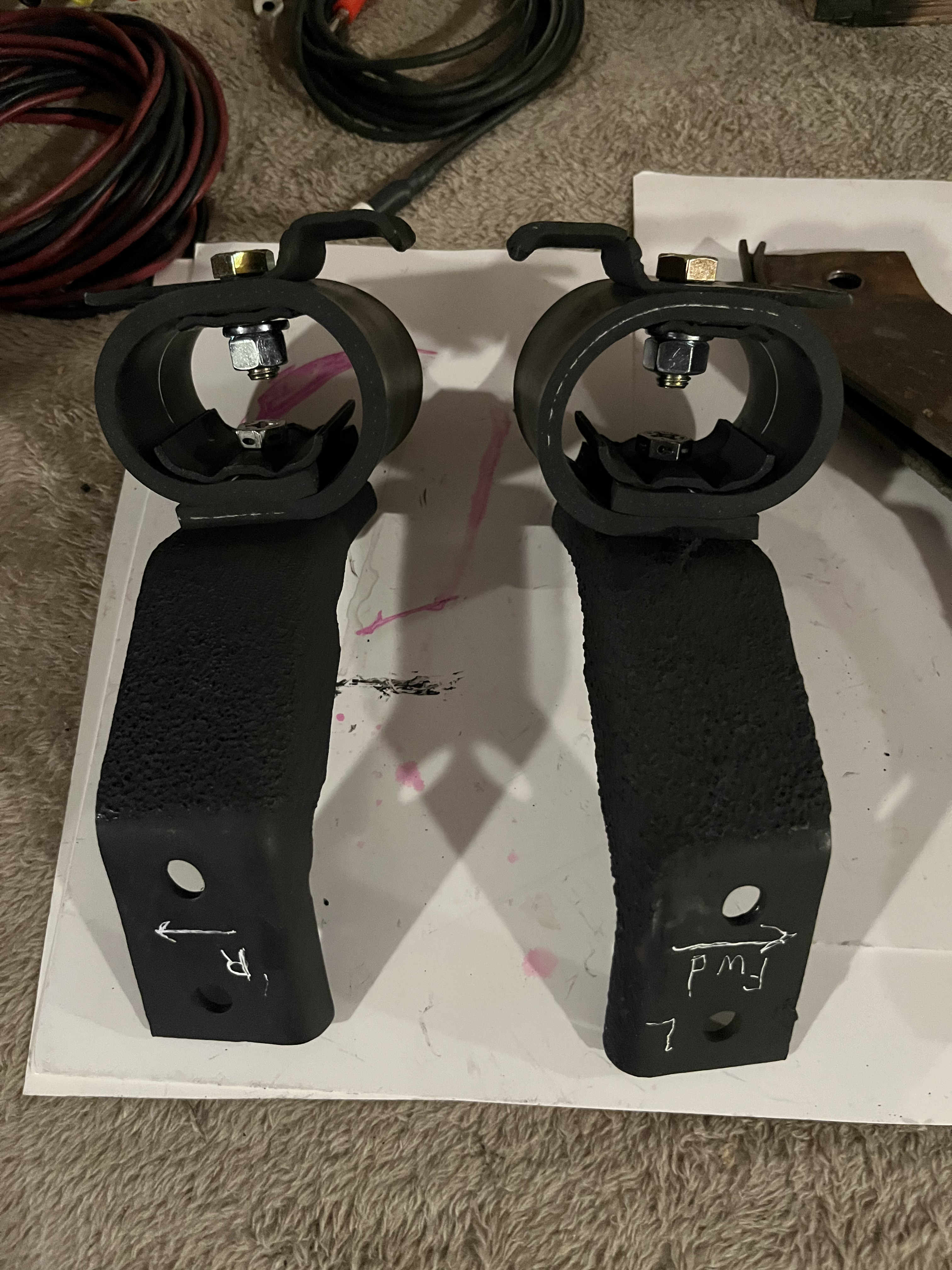

I learned that the original hangars were made from metal brackets, and cut-up tire sidewalls. Modern radial tires dont offer evenly sized cross-section, luckily Amazon has a vendor that has 2” strips of reinforced rubber. Amazon.com: DOBTIM Adhesive Reinforced Solid Rubber Sheets, Rolls & Strips Cloth Inserted 1/4 (.250)" Thick X 2" Wide X 10’ Long, Neoprene Rubber Strips Tensile-Resistant Tougher Projects : Industrial & Scientific
To retrofit, I ground off the rivets then measured the strips and layed-out the dimensions on the new strip. Using a leather/rubber hole punch on a hand drill, cut the holes. Attached using bolt/nuts same diameter as the rivets and got very good results.
Hope this helps someone from scrapping good brackets and save some bucks on new ones.
