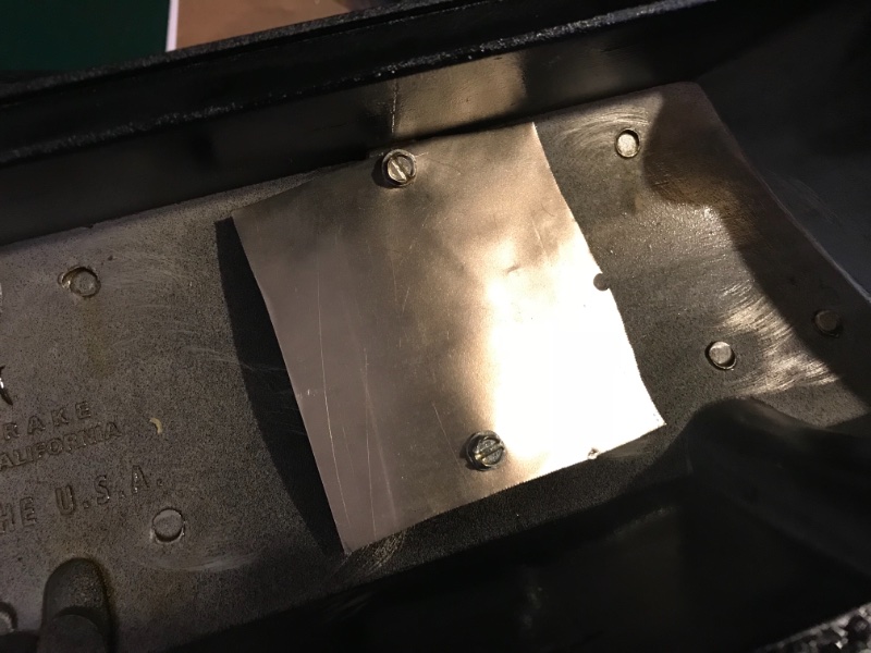

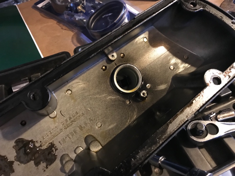

Turns out the ROCKERS were hitting this baffle. I didn’t have this problem with the 289. But am with the new 302.
We took it off.

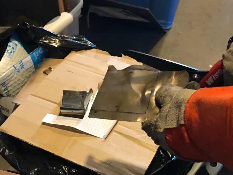

Took a piece from an old valve cover and flattened it out and cut to shape.
Drilled holes and put it on.
So. I have a couple of questions.
  1. Is this the right thing to do?
    I haven’t started her up yet to see if it’s still making noise.
  2. Has anyone else had this problem?
I can’t see where your fabrication would be a problem. The one thing I’d say is to make sure that Loctite is used on the sheet metal screws so you don’t have the same problem that caused you to change your engine in the first place.

If I’m not mistake those cougar covers are only for flat tappet lifter (original 289) and you have a roller lifter on the new 302.
I would be scared of those tek screws falling out and ending up in your motor. Make sure you locktight then very well

Unfortunately I drove it this morning and it’s still knocking. How are the rockers hitting this new baffle?
Are you sure it’s the baffle and not the top of the valve cover? What is the depth of the valve covers that came on the new engine verus those?
rocker cover is shaped differently and can cause clearance issues. With that said it does look like his repros allow for the use of roller rockers according to the description of the listing.
Have you ran it without the rocker cover on? You dont want to drive it down the street like that but you can run it parked at idle with the covers off to verify where the noise may be coming from.
Well. It’s ONLY on the drivers side. So that has me thinking it’s the baffle.

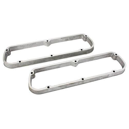

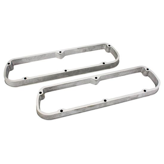

You may need a set of these,
https://www.speedwaymotors.com/Ansen-120-4002-Small-Block-Ford-Valve-Cover-Spacers,35302.html?sku=1354002&utm_medium=CSEGoogle&utm_source=CSE&utm_campaign=CSEGOOGLE&gclid=Cj0KCQjwtOLVBRCZARIsADPLtJ13vNkYjdU0MWlR07X5hPP4_qxf1XX57_Wtc8FHELPo2a85-bClqWcaAnkyEALw_wcB
But, the repos should clear most any roler rockers. I hope your test with the tin ones works.
