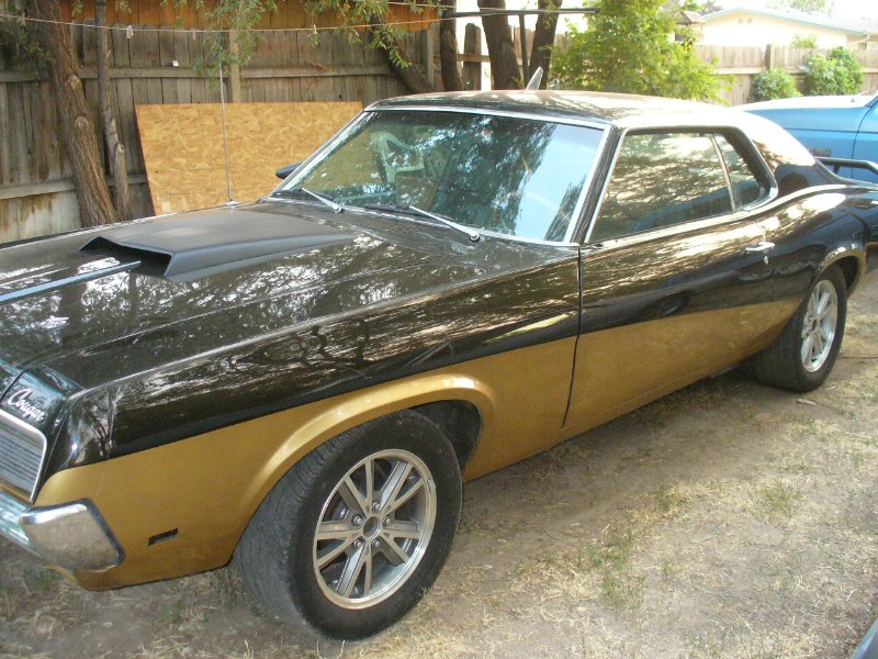

So after far to long, I got it together and started my 69 Cougar. I built the engine back in 2012, and got the valves adjusted in 2013.
The stars aligned, I was able to get a helper, and we started and broke in the roller cam. I put a retro fit comp cam with a .513 lift in the car. .030 over 351W with a T5 and 3.89 gear in the rear. (yes, the engine was primed well with oil, a couple of times before actually turning the key.)
Yay, it ran. But I had a bit of backfiring out of the drivers side bank. The engine had sat in assembly lube, and I was able to rotate everything a couple times a year, until finally getting it started.
I"m wondering if the back fire/ sputtering may have been nothing more than a valve being sticky from sitting.
I went ahead and took all the tension off the push rods, and am planning on going through the valve train again. After sitting with no tension for a couple of days, I still feel a lot of pressure in the hydraulic roller lifters. I would have thought they would have bled down like a regular flat tappet lifter would have.
Thoughts on them not bleeding down? I’ve been glued to the you tube looking at ‘other’ methods for setting valves, and am getting kind of water logged with EOIC, or, adjusting both valves on a cylinder when they are overlapping, and on base circle.
I have lost a couple of Edelbrock cams from what I believe was a combination of bad procedure, and inadequate zddp at the time.
Not sure if I can help but…if you set the lash too tight on hydraulic lifters it probably wouldn’t have started at all. They pump up and neither valve closes. So the initial setting wasn’t drastically off.
I’d be more inclined to inspect or replace any suspect plug wires for a slight miss. What is the timing set at? How did the plugs look? Did you notice notice any difference is lash settings on the driver’s side when you inspected? Sorry for all the questions but have to start somewhere.
Plugs are new, the wires are used, but appeared to be in good shape. The only thing that was noteworthy, was that the #8 intake was lose-ish when we pulled the valve covers to check everything. I do kind of wish I hadn’t un done all the rockers, but it is in my nature to go for the worst and rebuild before just stupid double checking…
