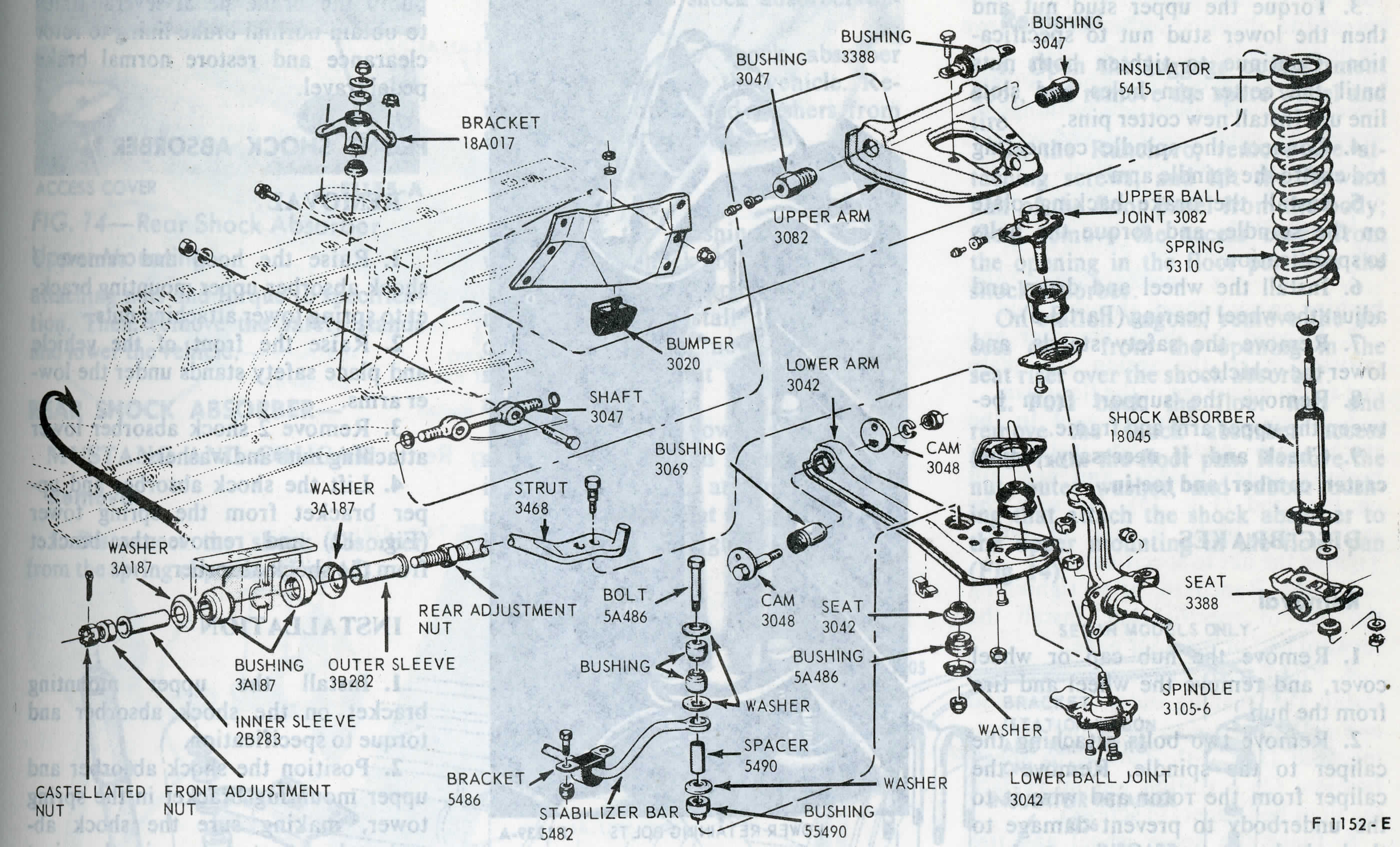

I post this figure because I think it adds to the conversation.
Looking more closely, I see what you did there, Bill. No sleeve spacer, just bushings and washers. I like it. You took the end of the bar down instead of up in order to get to a good neutral position. You can fine tune it by shaping your bushings. If lowering the ends of the bar can’t get a car to a good geometry though, one may get there with longer links.
Honestly, I hadn’t thought of this. Probably because my original links don’t use sleeves - they have shaped ends. Now I want to see if I can get as good an installation lowering the ends of my bar, relative to the lower arm, as I did raising the bar which happened when I lowered the car.
That is a compact setup. I have an issue with the clearance between my sway bar and my Hotchkis adjustable strut rod that this mounting scheme may improve.
…Actually, looking at your first picture makes me think the longer link may be better for this. Times like this I wish I had a two post lift. And a four post lift. And a thousand square foot shop.

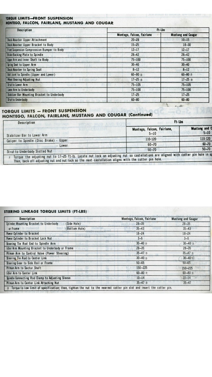

It’s been a few days since the request but here are the torque specs from the '68 service manual.
Thank you Rick, I really appreciate it. I was going to start the suspension rebuild this weekend. I appreciate the help.
