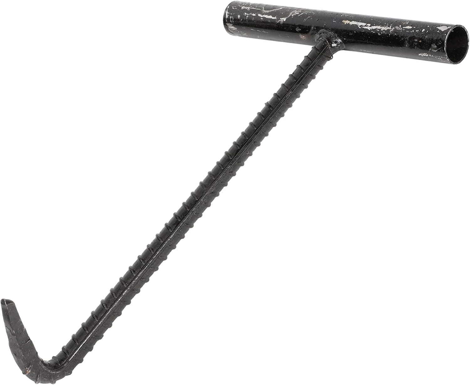

I use a metal wire hook that has a handle made from tubing. These are used sometimes to pull dents in bodywork.
Similar to this:
