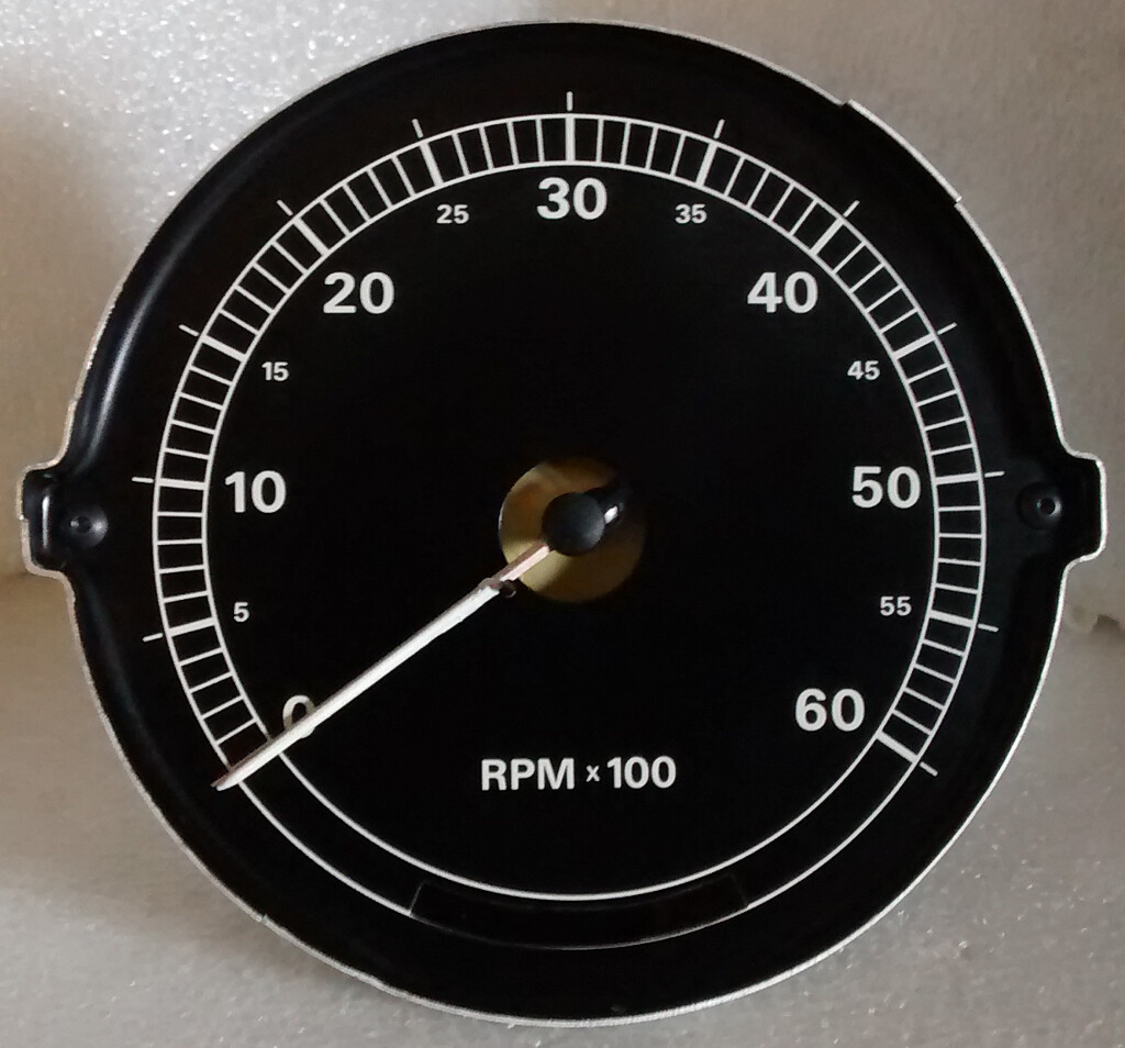

Next, on an XR7 the tach in in series with the ignition. That means that the power to the coil passes through the tach. There are two wires coming out of the back of the tach: one each male and female bullet connectors, the wires are only about 6 to 8 inches long. To get to the wires you need to remove the ash tray. You will need a very short stubby screw driver or a right angle driver to get the one on the left side. Simply unplug the tach and then plug the male lead going to the tach, into the female lead going away from the tach. This takes the tach out of the circuit. If the problem is fixed, then you know you need to repair or replace the tach. Usually all you have to do is to touch up the solder connections. IF this doesn’t fix the problem you need to verify that you are getting 12 volts out of the ignition switch during both start and run.
