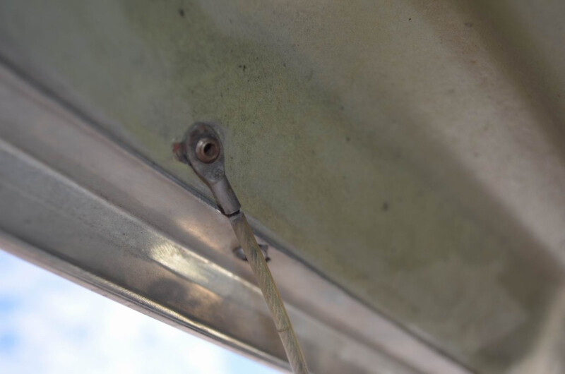

Here are some photos of our XR7-G’s that might help or just muddy the water for you. The Lime Frost Cougar has the rivet. It also had front end damage in the early 70’s after the original owner said he slid into a ditch during a snow storm. He stated the fender was damaged but not the hood. The hood scoop is a GT-E style so there could have been another accident with the second owner. Below is a picture of the under side of the GT-E style scoop.
Here are some of the photos that I have. I think a few may even be of Steven’s G.

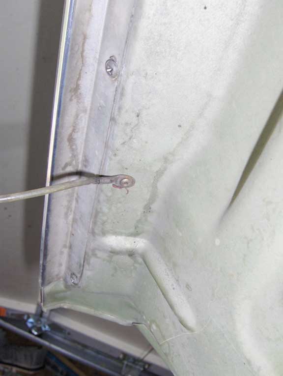

I went out and looked at mine. It is riveted but the underside of my hood has definitely been painted.

The rivets are aluminum pop rivets, 1/8" diameter. There is no swivel.

The bill of materials calls for two screws to attach the lanyard to the hood, but Royce is correct in that they were pop riveted in production.

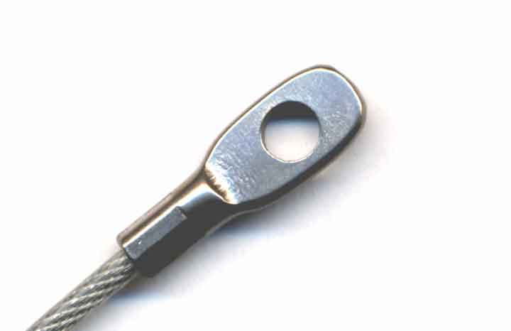

This is a photo of an original click pin and you can see the hex crimp on the original lanyard:
BTW FWIW department. The BOM listing is actually for the service part. The screws make sense for a service replacement. Perhaps an Assembly BOM would show two pop rivets.

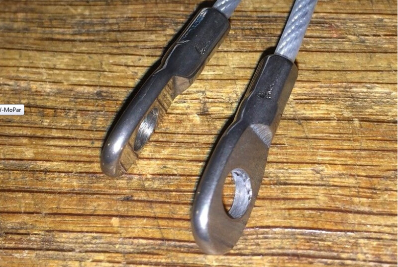

I got a set of cables w/ the hex crimp for a MOPAR. I forget the length and they are not exact ( a tad longer ). I believe they were 18". They can be had on ebay. Maybe have someone measure the length of theirs to see what length they should be…
Here is a pic of the end of the MOPAR cables that tattarat is talking about.
You could make them appear closer to the G cables by bending the end but they are pretty robust pieces.
One nice thing about the MOPAR reproductions is that the plastic sheathing is new and supple.

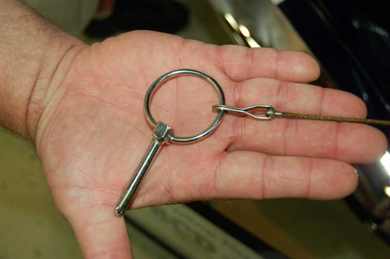

On the “Installation - Hood pin and Horn mounting hole” print. It shows the swivel style lanyard. Not saying they are correct, but I like the look of the swivel end better.
By “swivel style” are you all referring to the '67 Shelby type good lanyards (see attached photo)?

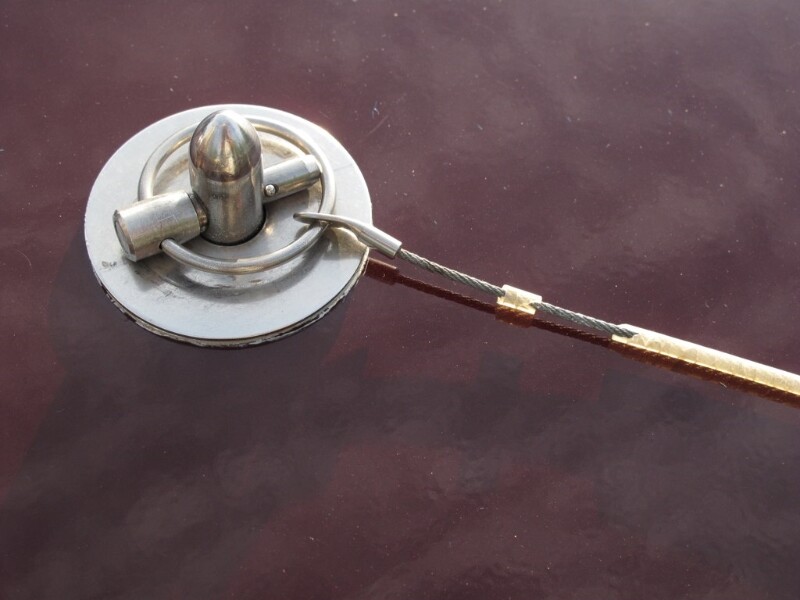

I’ve also attached a photo of the hood pins and lanyards on a Hertz G that is usually at Carlisle.
Yes I am referring to the Shelby style. I also have a couple photo’s of his lanyards as well. can’t remember his name.
