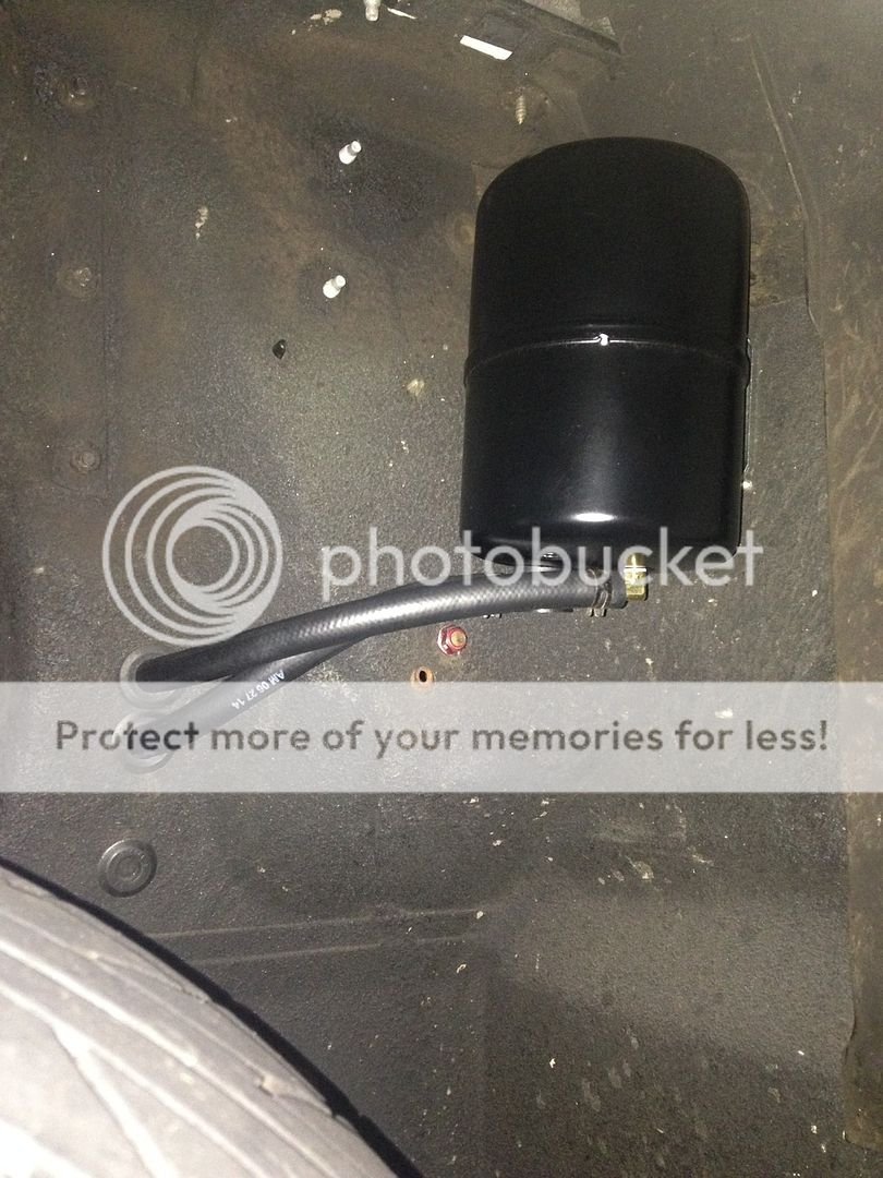

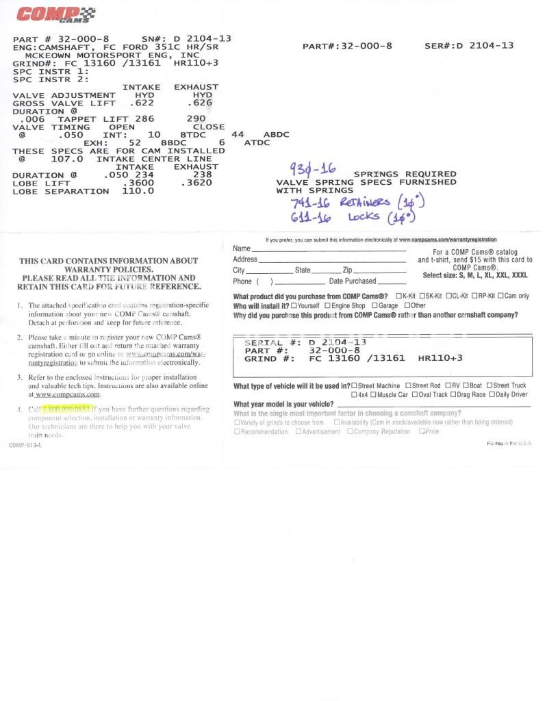

I run 234/238 duration @.050" with 110 lobe separation, .622/.626 lift, hydraulic roller in my 408C. It too is about as much as one would want to run on the street. I use an auxiliary vacuum reservoir to help out the power brake booster, works pretty well.
