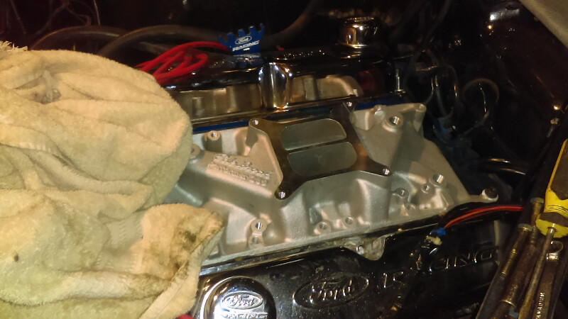

Got everything spotlessly clean and did a test fit last night. No issues and all bolt holes lined up. So I’ll be torqueing it down tonight. Well, there was one issue. The driver’s side stud in the back would not come out and having dealt with that mess before I used the trusty old die grinder and took the back down about an 1/8 inch so that the nut would grab enough threads that I’m comfortable with it. It’ll also help to make sure I stay lined up when I drop it down. Tried a punch on the top of the bolt, heat, PB Blaster, and the list goes on with no success so it’s staying.

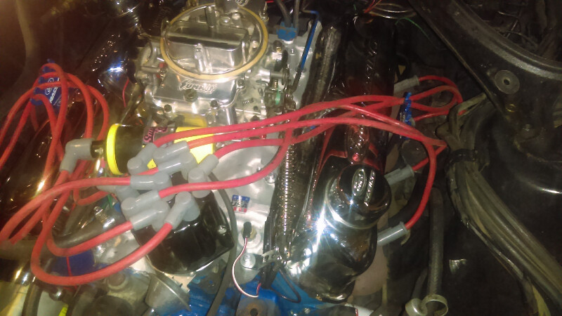

So I got the intake torqued down and test fit the carb (summit 600), and went and bought a 3/8 spacer today as the accelerator pump was laying on the port. I hope this gives me a little more clearance with the coil too as the dual feed line is right where the coil is. I’m also putting the throttle rod on the drill press and drilling a hole for a cotter pin as I don’t trust the crappy little aluminum holder. Not a lot of room on top of a 289. Come to think of it, not a lot of room between the carb and the hood either.
So everything is on and took it for a shakedown run. No leaks from end seals etc. I will say that an Eddy carb would make for more room on my tiny little small block, but I have had the carb for four years and got it for cheap from my nephew when he decided it was too much for a stock 304. I basically got a brand new carb for $75.
