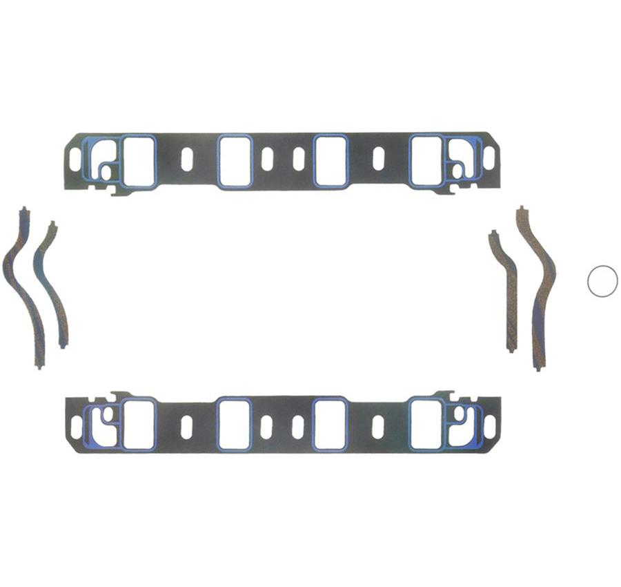

Would the Fel-Pro 1262S-3 work?
https://www.summitracing.com/parts/fel-1262s3
I noticed that one lacked an opening for the heat crossover, which would leave your intake manifold “cold.” So I looked it up. http://www.fme-cat.com/overlays/part-detail.aspx?brandId=FL&pNum=1262%20S-3&partType=Intake%20Manifold%20Gasket%20Set implies this is for the user who will be happy with that (it has a steel core, for one). You might want to go with just the straight 1262, which you may be able to open the crossover on with if desired. Or call Fel-Pro’s 800 number and ask why neither the 1262 or 1262S pictures no longer show a crossover port (800-325-8886)
