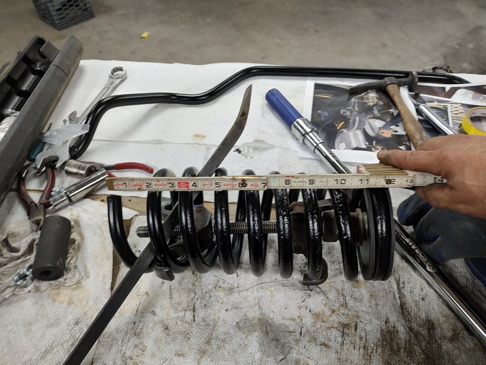

Installing the springs is a little scary. They are 16” tall and need to be compressed down to at least 12” to get them to fit into the perches.

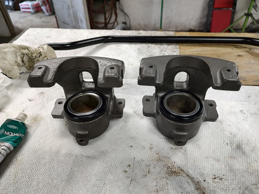

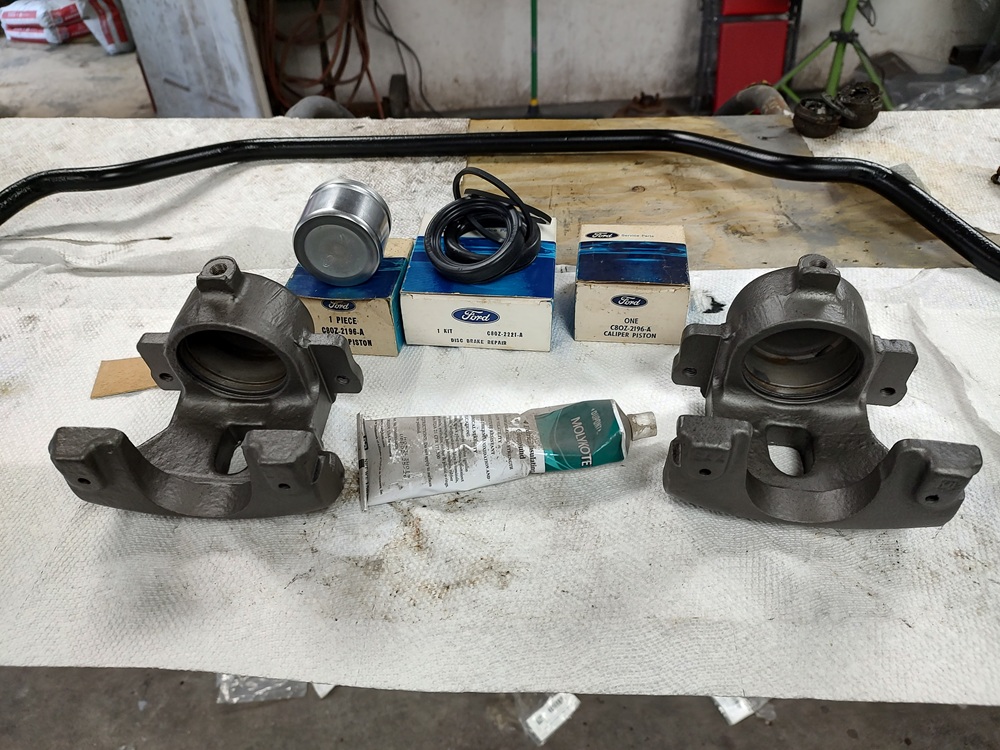

The Calipers are really easy to rebuild. I bought NOS pistons and seals off from fleabay.

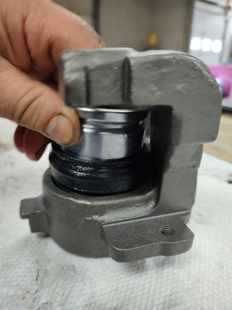

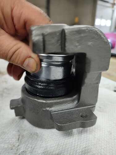

The trick to install the seals and pistons, is to slide the seal way down below the piston, hook them into the lip of the casting and then press the piston to the bottom of the bore.

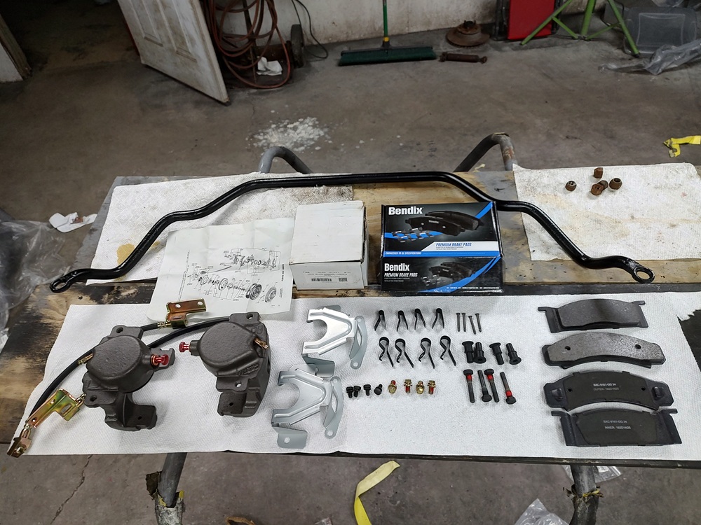

The brake hardware kit was purchased from Dead Nuts On as well.
