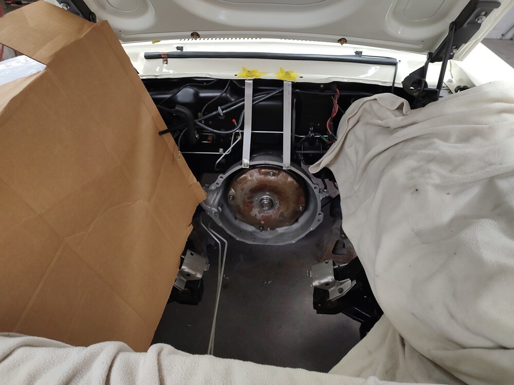

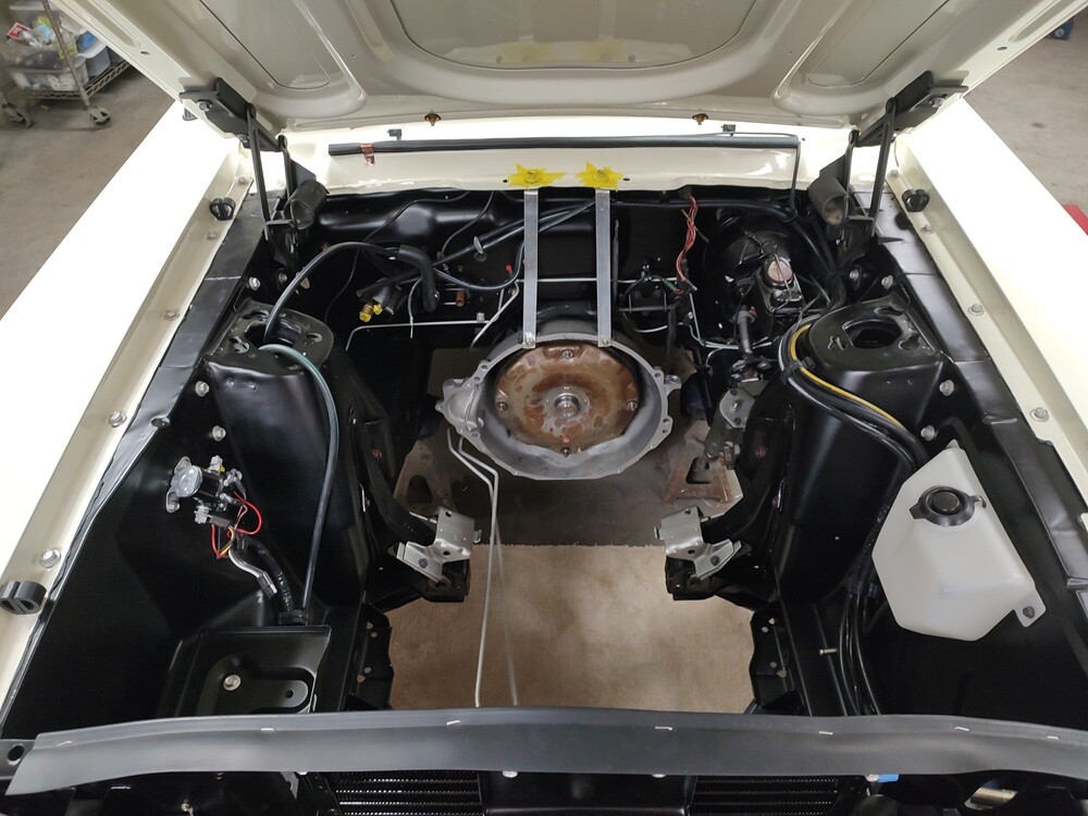

I did the Royce install method of transmission first with the transmission suspended in the front with aluminum straps. The tail was just resting on the transmission mount so that it had free front to back movement.
lots of blankets and cardboard were used to prevent damage to nearby surfaces.

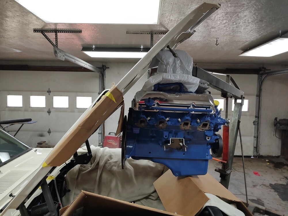

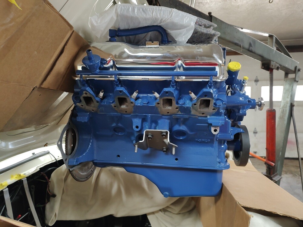

The RH exhaust manifold and both motor mounts were left off. The LH exhaust manifold was installed as well as the LH factory lift hook. The engine was hung from the intake using an engine pull plate.
Getting the engine into the engine bay was a little dance. Move forward a little, look for hood clearance, lower the engine a little, move forward a little, look for hood clearance, lower the engine ensuring that the oil pan clears the radiator support, lower a little, look so that the harmonic balancer is a little above the radiator support, look for hood clearance, move forward a little, etc
There was about a 1-inch clearance with the hood at the closest approach.

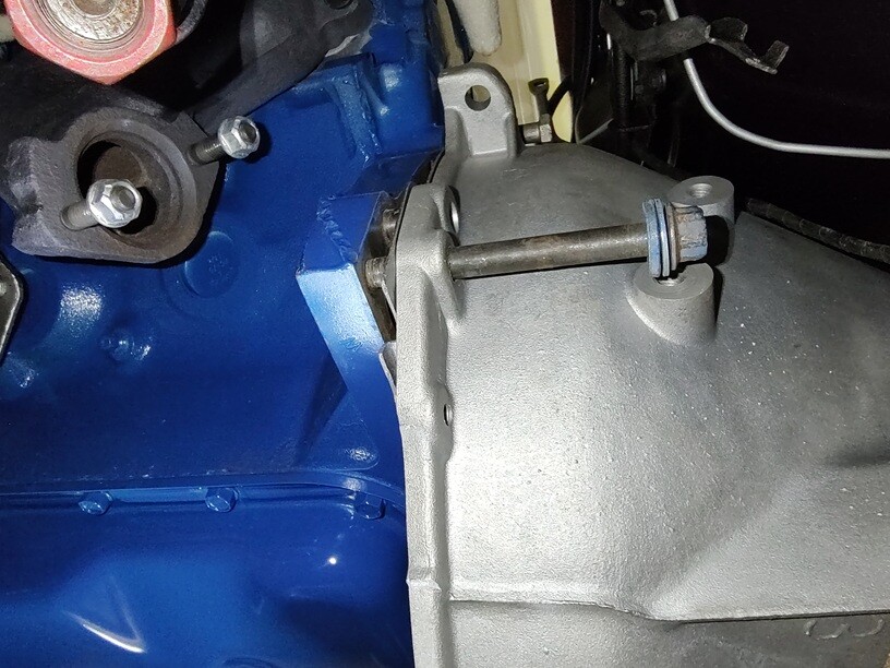

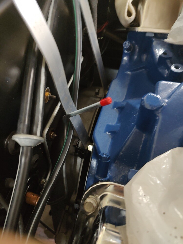

The engine and transmission are brought into alignment. The bolts at the top are aligned with the block, but are held back at a good spacing because of the nuts on the straps.
at the bottom I used long head bolts as a guide (again Royce’s method). Now the transmission and engine are in alignment. The center two bolts (one on either side of the transmission) can be started.

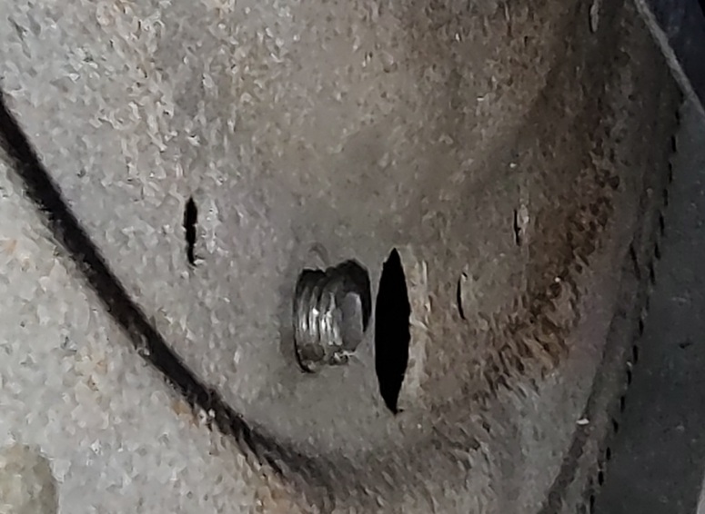

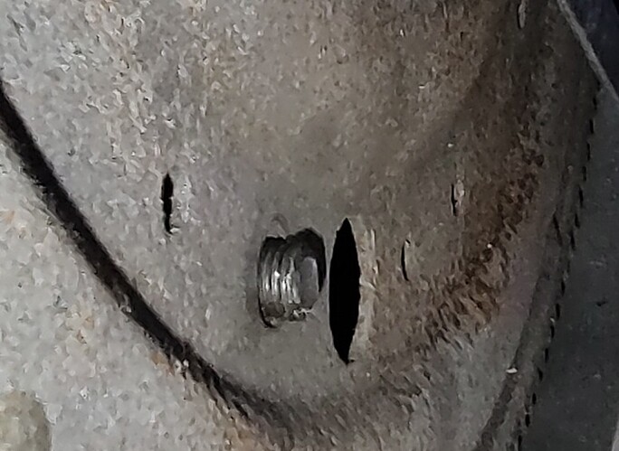

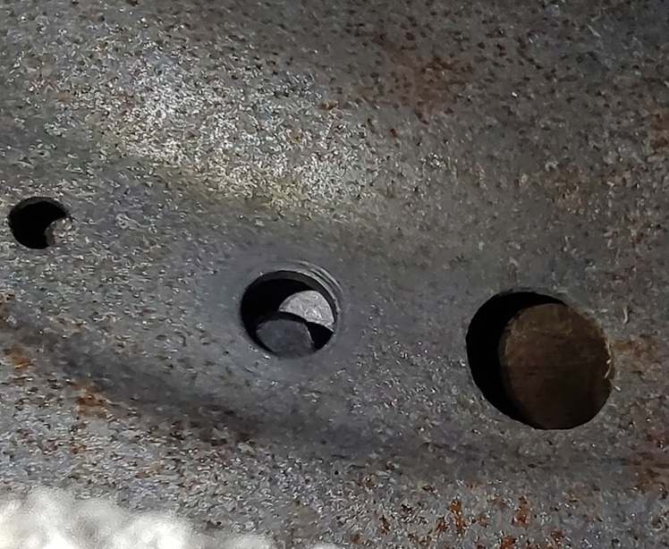

with the engine/trans brought into alignment the torque converter can be rotated so that the studs align with the holes in the flywheel.
then you can remove the nuts at the top and start drawing the engine and transmission together.
The torque converter studs should just get brought through the flywheel as the transmission is bolted in.

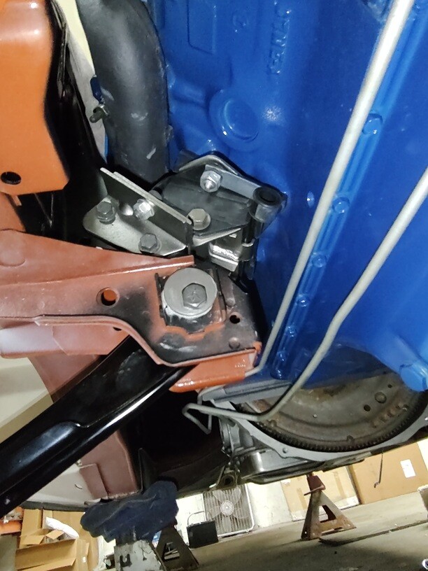

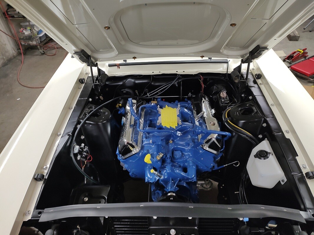

The engine and transmission can be raised as a unit so that the RH exhaust manifold can motor mounts can be installed. There is one exhaust manifold bolt that is a bear to get to, if you can get the engine raised high enough it’s not impossible.

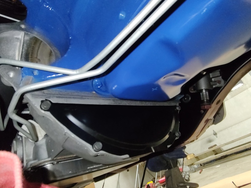

With the motor mounts and rear trans mount bolted in, the torque converter nuts can be install as well as the dust cover.
Easy right? Well though I didn’t damage anything, one of the studs on the new transmission mount broke free and started spinning when I was tightening it. So have I to look forward to replacing it.
Next up. All the goodies that attach to the engine.
