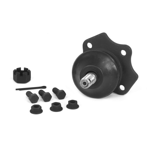

I don’t know anything about the quality of these, but EClassics shows them available. I appreciate you bringing up the query so I can seek BEFORE I need.
…and Parts Geek says they still have MOOG assemblies in stock (85 pieces)

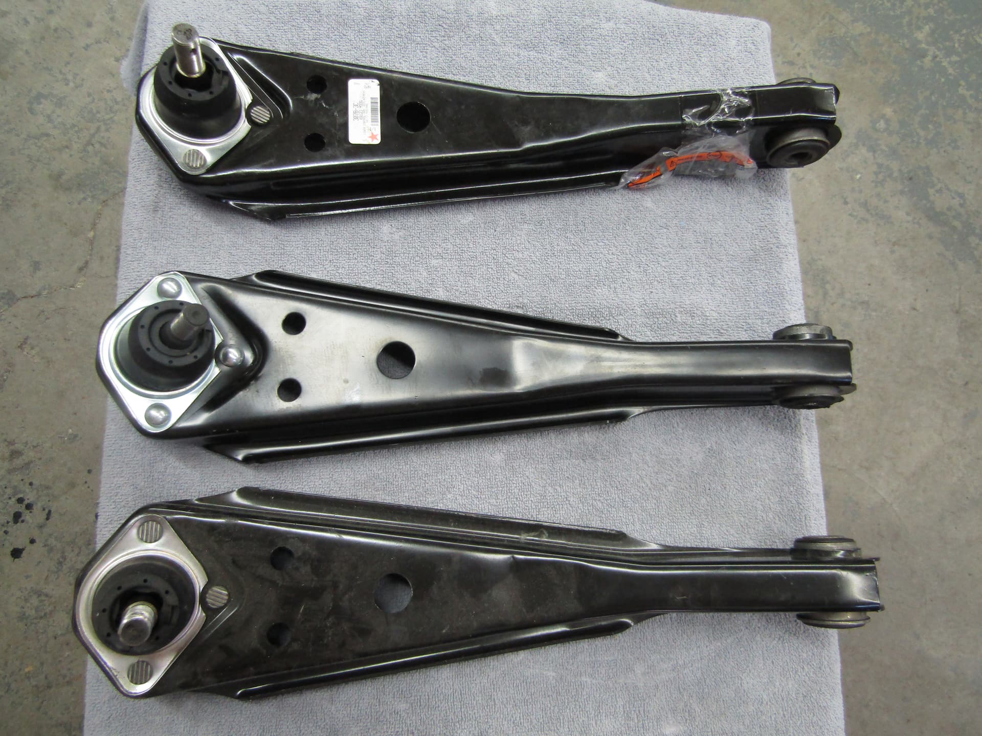

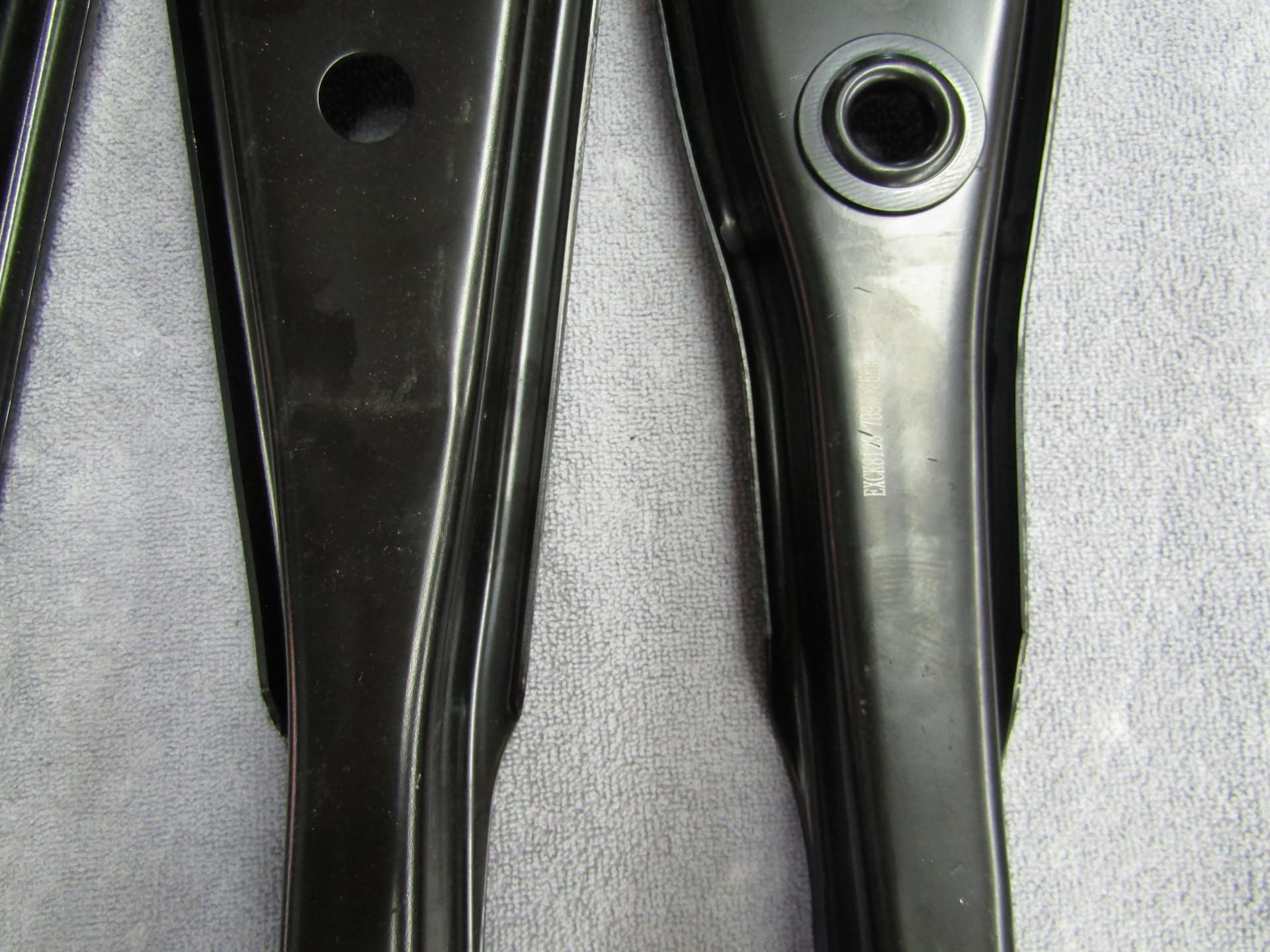

OK, so the ones offered by most (in this case Moog “retail” quality, denoted by the prefix “RK”) is Chinese junk. Look closely at the arm. It has a coke bottle like profile, where as the “better quality” ones have a straight sides, like the original MOOG ones “K” series.

I thought I posted pics of these earlier
Good style MOOG top & bottom. Note the rivets
Note the body neck difference & shock “washer”.
These pictures are very helpful
those are china copies that anyone can have made and put their names on
