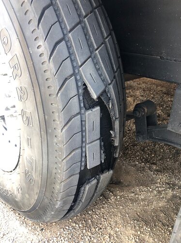

So I was driving the cougar home from work. Conditions were mid to high 90s and my speed was between 70 to 80 miles per hour.
My air pressure is 35 psi front and 30 psi rear just like all my other cars.
When I got the car, I was assured that the wheels were 100% all original. I failed to appreciate the implications.
The tires raised no alarm at that time until today.
I’m lucky to be alive, big-time!! ![]()
They are actual bias ply tires!! If I knew that, I would’ve gotten rid of them long ago and put on radial tires.
The blow out was nothing short of a near death experience. The tire exploded and damaged the fender, causing the wheel well trim to be destroyed as well as an incorrect bumper guard trim.
I had to pull on the steering wheel with all my might to keep her from diving into the ditch and flipping. She dragged herself to the shoulder before I could get her fully stopped.
The actual blow out sent debris flying in all directions, some of which flew in front of the vehicle, namely the trim piece. I actually ran over some of that as I was fighting to stay on the road.
Multiple cars behind me had to take evasive action but no one wrecked. Both of my windows were down at the time. I was lucky because no debris came into the car and injured or killed me.
