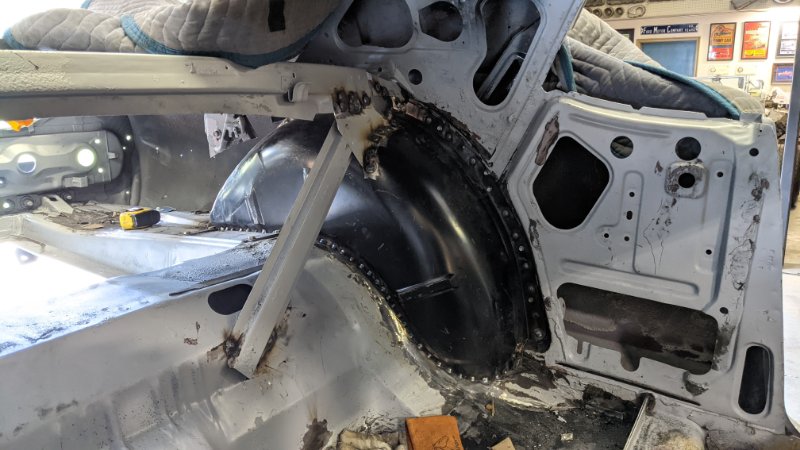

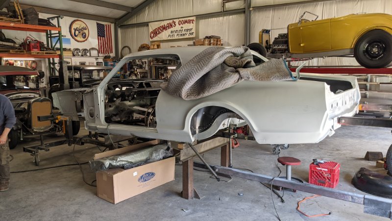

I plan to mini-tub my 67 cougar using a repro 67-8 cougar wheel tub. I’ll cut out my existing wheel tub leaving approximately 2" behind, then butt weld the new one to the existing tub (obviously cutting the vertical flange off on the new one first). I like this approach because it only leaves behind one weld seam. The other way it can be done is to split the existing and put a filler piece in, but that means an extra weld seam to grind down.

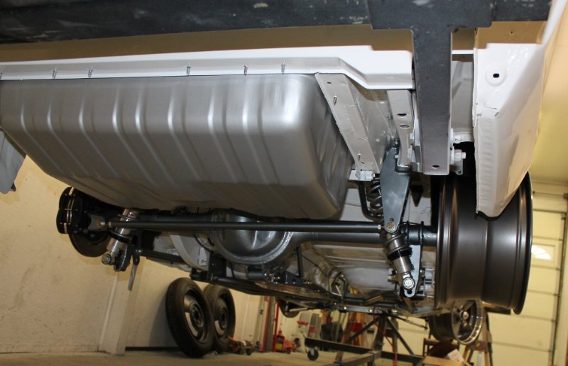

I used Goodmark 2" tubs
Does not touch the frame

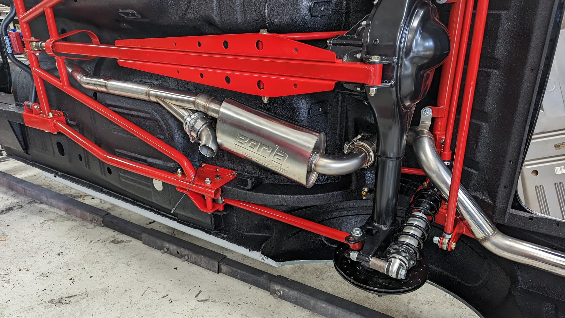

Because I also installed the TCI 3 link rear suspension system, the lower control arm is the limiting the full depth…gained approx 1" inward. I had the rear end shortened to 56.5 inches from 59.5. If I could do it over, I would have narrowed the rear end more in order to have less backspacing (currently backspacing is 5.5". I plan on running a 18" x 11" wheel and increasing the car flairs all around to accommodate the wider wheels. The front wheels will be 18 x 9.5", back spacing to be determined once the TCI front suspension is installed.

I installed TCI’s mustang mini tubs last fall. I shortened my axle to 55.5. Moved the frame rails in. Built my own tubs. First the TCI measurements are wrong for a Cougar. Second you need to move the rails in if you shorten your axle to 55.5. I felt that if you tube it make room for your tires. Never found a tub that would fit right. So I made my own. I can not reuse my interior side panels or back seat without making alterations. Fuel tank still fits and it will be very close for the exhaust to fit. I can help with the measurements, frame rails and any other information you may need. Before you order you will need to give TCI measurements for rear crossmember, panhard and frame stiffener bars. This is of course you use the same axle I used.

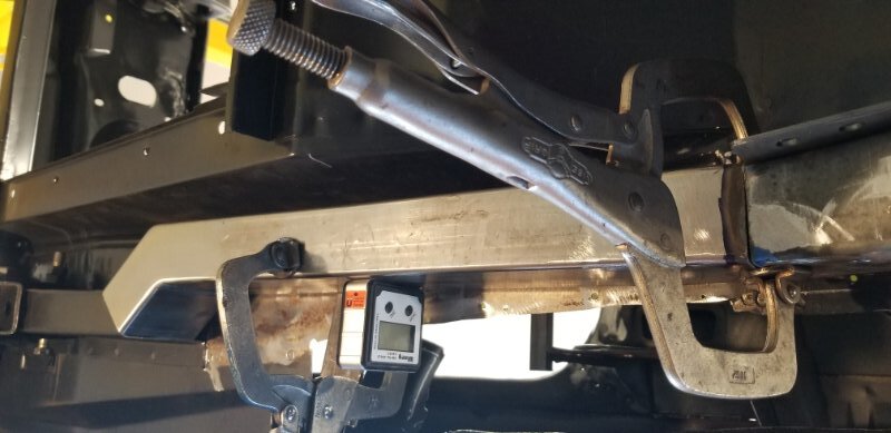

I have the TCI 3 link as well. I am just about to start on the Mini Tubs. Took some measurements, and test fit some of the brackets supplied in the kit. If you didn’t have to touch the frame, how well did your Brackets fit over the frame. My frame rails are 1.75" wide, and have a contour, the TCI brackets are 2" and dead straight. I measured the 17.5" from the rear / front edge of the rear leaf spring mounting hole, positioned the brackets and found that the TCI brackets don’t fit at all. Do you have any pics you could share of your process?
