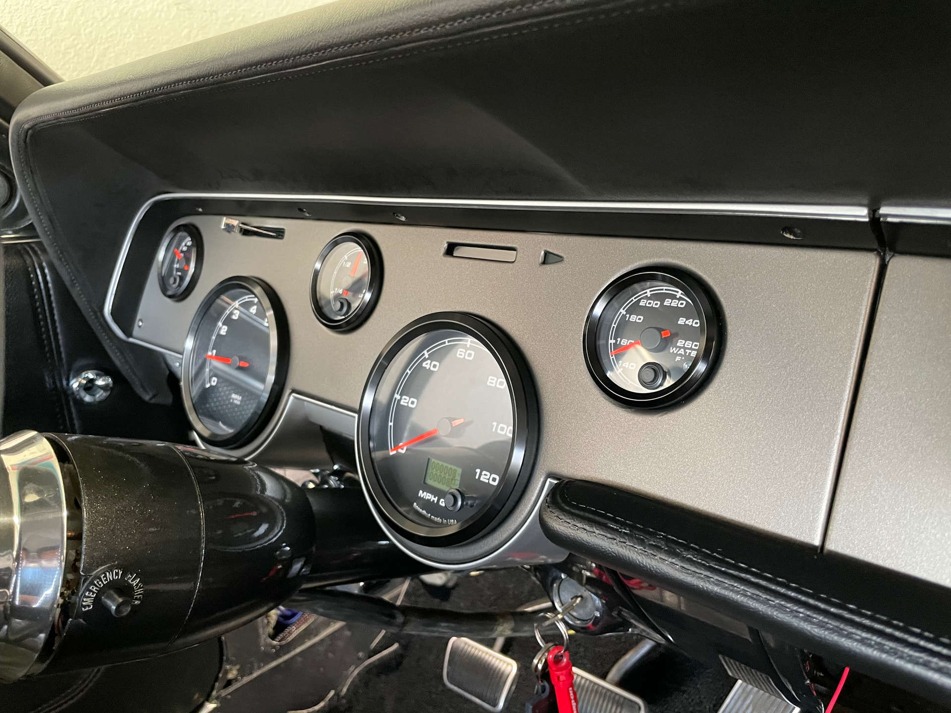

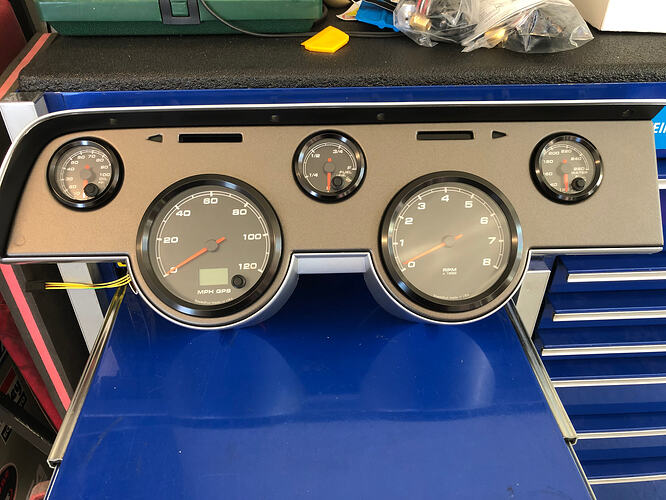

I used all aftermarket gauges, painted and wrapped the panels to ditch the chrome and wood panel look

Yes, saw your post. Looks great and the layout looks better to me as well. But I really like the more dramatic Mustang design with the large chrome bezels, deeper set instruments, and increased panel angle. I’m still just playing around with the idea but so far it looks doable.

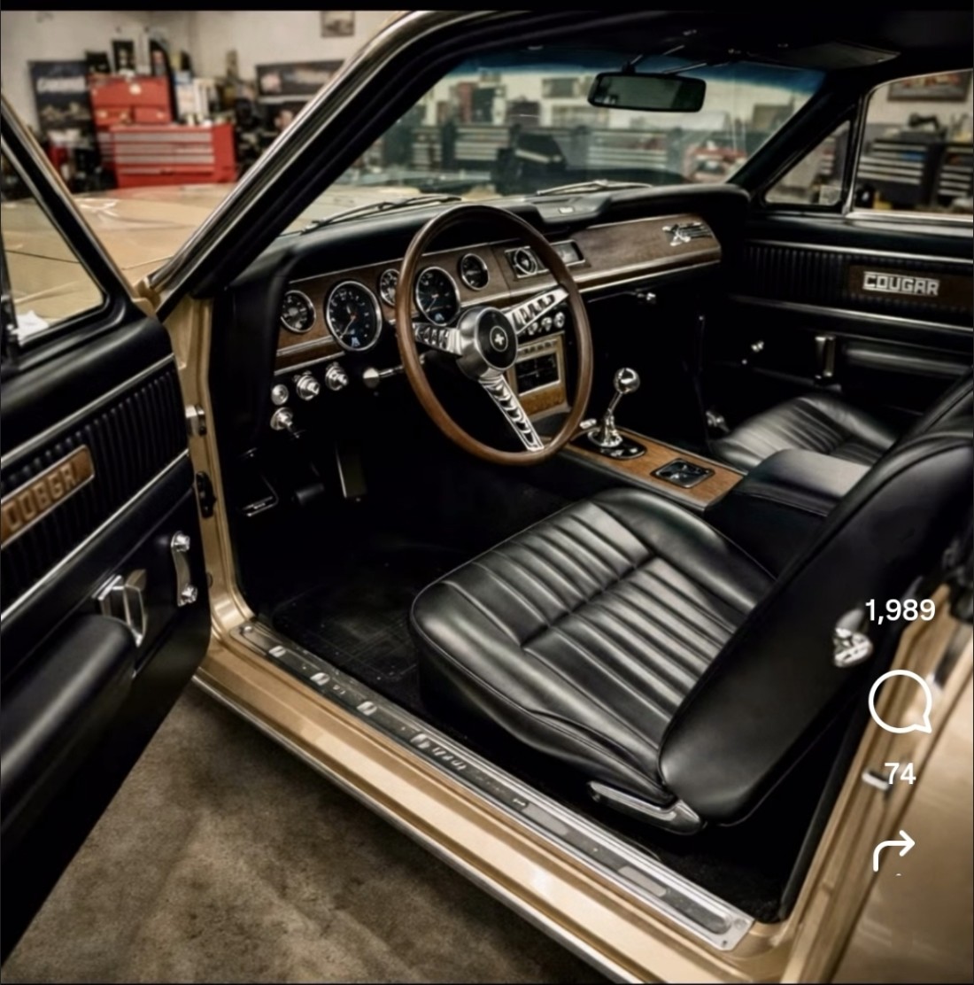

Saw this one on Instagram, these guys did a really nice job of it here on a ‘67, dash & console looks so good​:pinched_fingers:
Reminds me of the Quarter Horse Mustang(s) concept.
Looks like AI Misspelled Cougar on the driver side.
I saw that too. and to add to that, ‘that’ was the one thing I didn’t like of the interior was the COUGAR spelled out on the door panel that way. I wish I knew what model/year seat covers they used though I like the stitching pattern in those.
Thanks, yes will do. I have a great appreciation for the original design. The plastic chrome must’ve been in poor condition to make the decision to have it removed, painted black and reinstalled. Their shop must’ve lost the fascia board clips or had problems with them. They drilled holes in the board and pop-riveted it to the dash panel.
