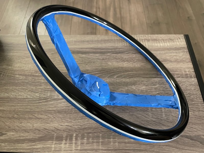

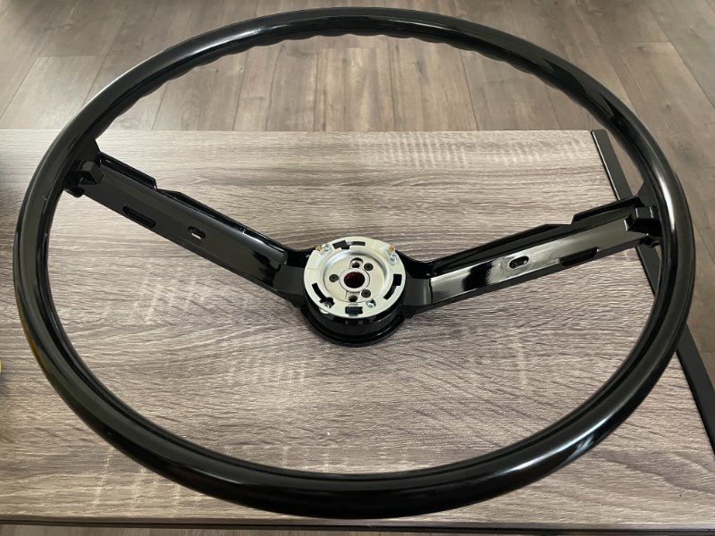

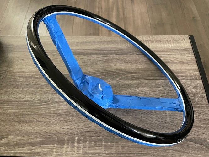

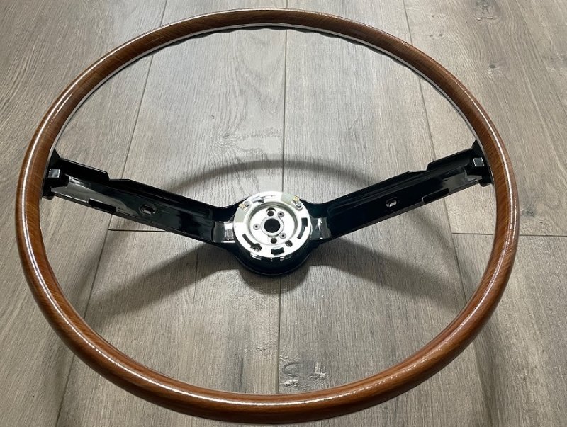

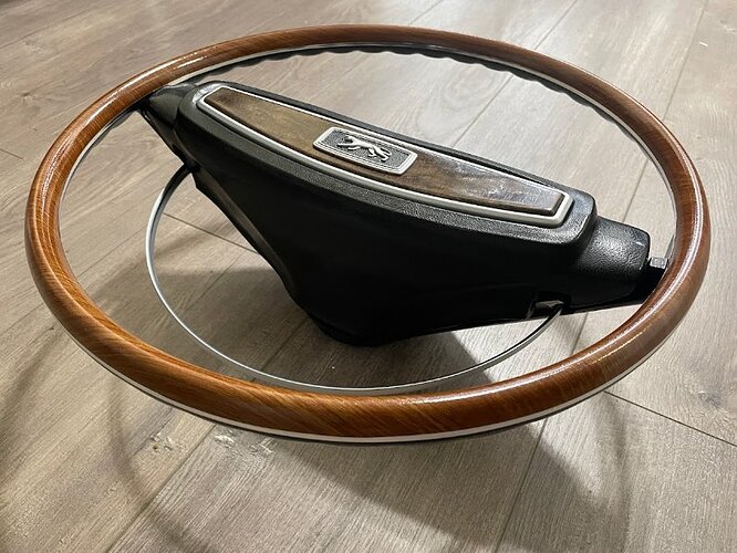

After taking everything into consideration, I went a bit rogue with my steering wheel choice and decided to “DIY”. It started with a standard black ACP steering wheel that I then hydrodipped and cleared. I’m really happy with the results, let me know what you all think.
Masked off everything besides the wood grain surface

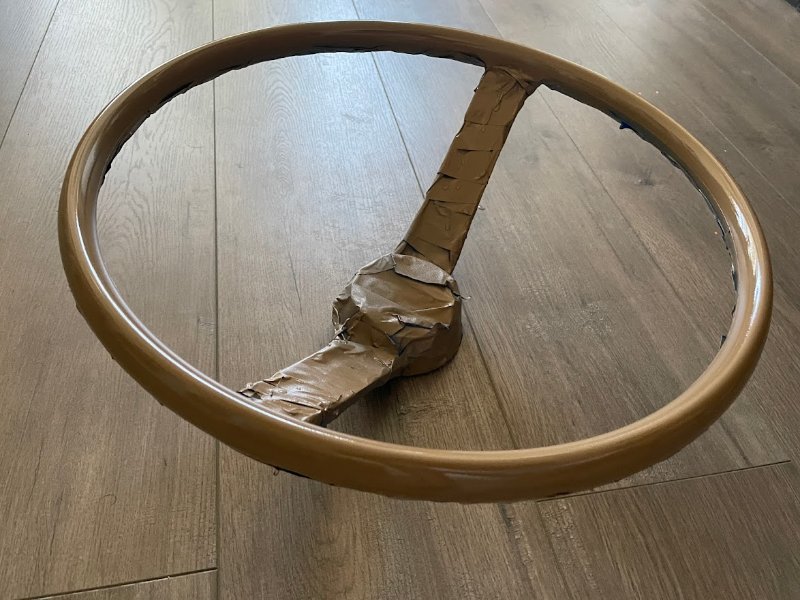

Hit it with a tan undercoat
Continued on next post
Then I hydrodipped using the following film: HYDROGRAPHIC FILM WATER TRANSFER PRINTING FILM HYDRO DIP STRAIGHT WOODGRAIN1 1SQ | eBay
After dipping, wrapping with a mylar band on the outside and inside diameter, and clearing with 2K High Gloss
Grain isn’t spot on, but close enough.

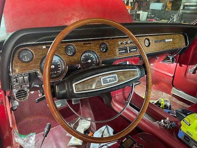

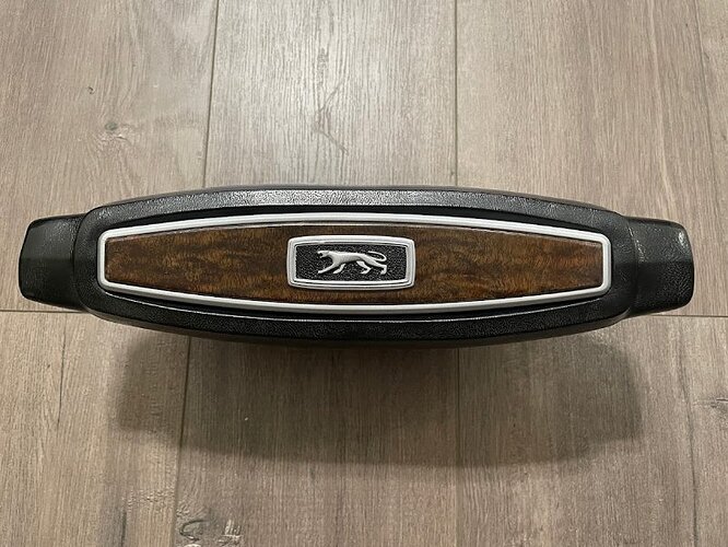

Restored the hornpad while I was at it. Painting the cougar emblem was a pain in the ***.

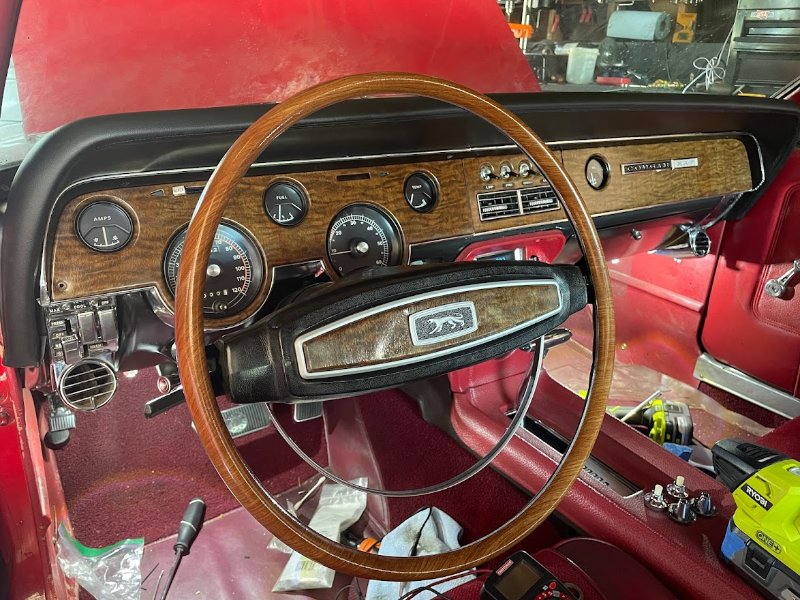

Don’t mind the mess, here is the dash area, fully restored at this point.
Very nice work!
Perfect application of the hydro-dipping photo decal transfer method. I’d love to see someone do the same with the dash panels, if the original wood grain was too faded, but the actual housing was still structurally sound. It would seem to be a perfect application.
Looks great! My only concern is how long the hydrodipping lasts in a heavy use environment.
I had the same concerns, initially, and I guess only time will tell. Seeing how the restored/new options out there are hand painted and cleared I can’t imagine how it would be any different for hydrodipping after it is cleared. I put 4 coats of 2K clear on, layering it on thick. Fingers crossed!
Yup, that’s a great idea! I did search around for a hydographic film to accomplish what you mentioned, but was not able to find a close enough match.
You can have your own custom film printed though, so in theory, I guess if you had the file that contained the image for the vinyl overlays that WCCC sells you’d be on the right path.
Nice work, it came out great.
