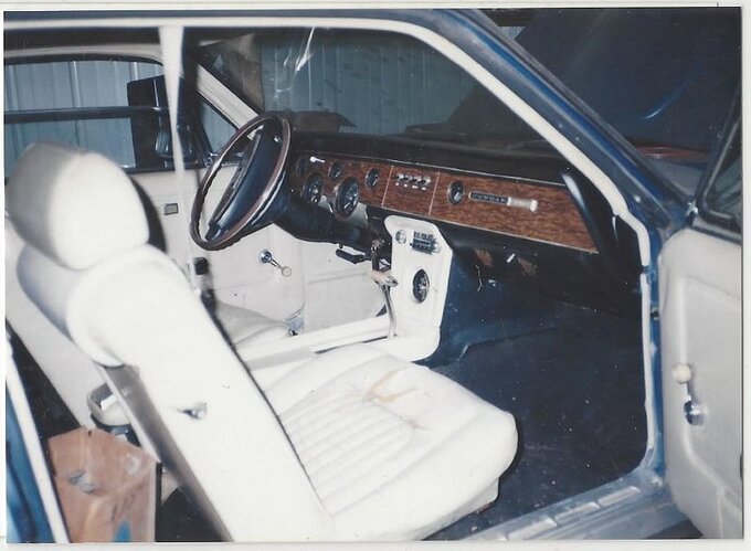

I am blessed to be starting a new project today. It is a W code GT-E, matching numbers. The previous owners (there was a partnership) got the body metalwork done and had the car painted. The original engine was rebuilt. The interior was redone, even though it was in excellent condition. Then the guy doing the final assembly retired. That was ten years ago.
This car has multiple build sheets, a full complement of inspection sheets, and a lot of documentation since it was originally a factory show unit. Major original components were there including the original distributor, carburetor, transmission, rear axle. Should be a great car someday soon.
It is / was / will be a beautiful car. I don’t think it was ever at VIR - there is a twin to it that was also a Ford show car. Perhaps you saw that one. This one spent most of it’s life in Ohio.
These are “before” restoration photos. Original paint and interior.
