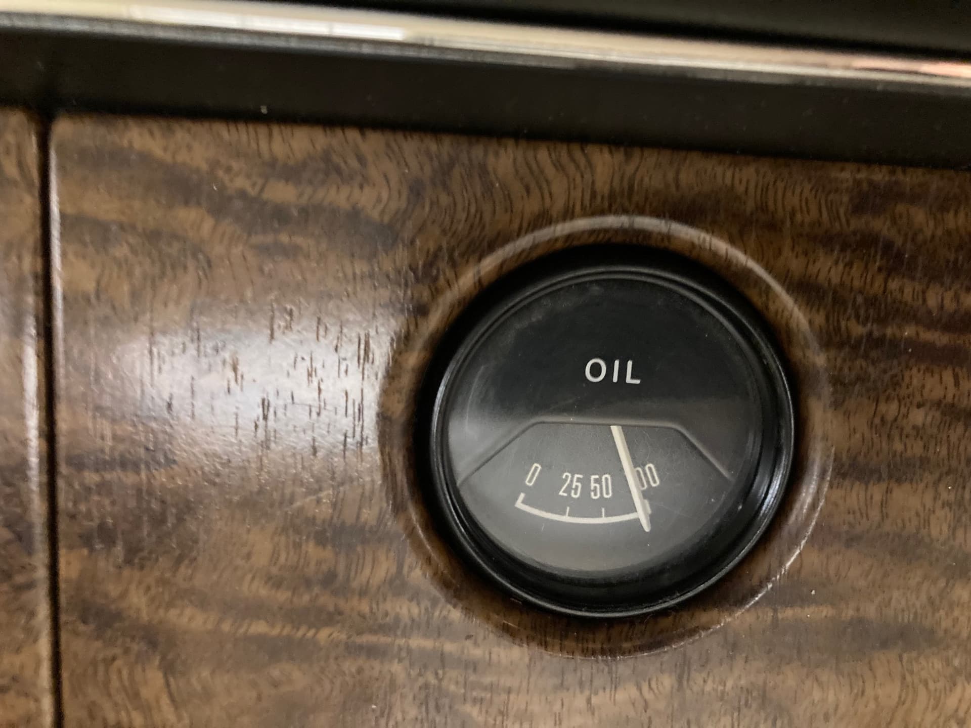

And with the tester set to the highest position:
That is within the margin of error. If fuel and temp both read like this, just a bit low, then you can adjust the IVR for a little more output and pretty well nail the high readings. Other wise this is looking good.
